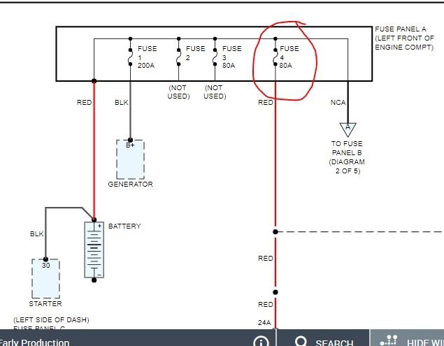

I turned my car off one night and hasn't started since. my dash lights wont come on either.

Does anything electrical work? If not, have you checked the battery for charge? Also, have you confirmed that the battery terminals are clean and tight?

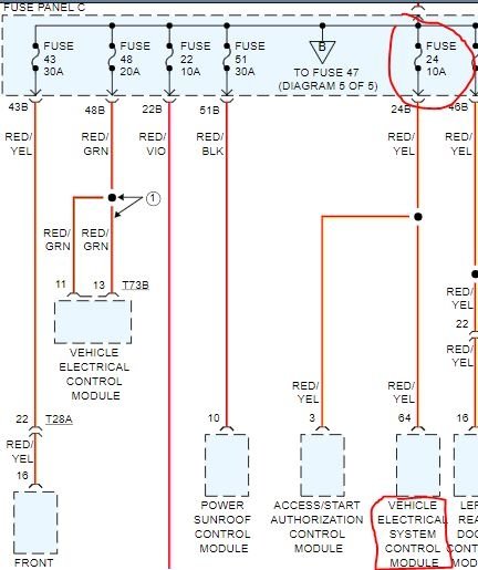

If possible, I need you to check two different fuses. See pics 1 and 2. Pic 2 shows fuse panel C which is on the left side of the dash. Pic 1 is located in the left front of the engine compartment.
Also, I need to know what engine it has and if it is an automatic or manual transmission.
