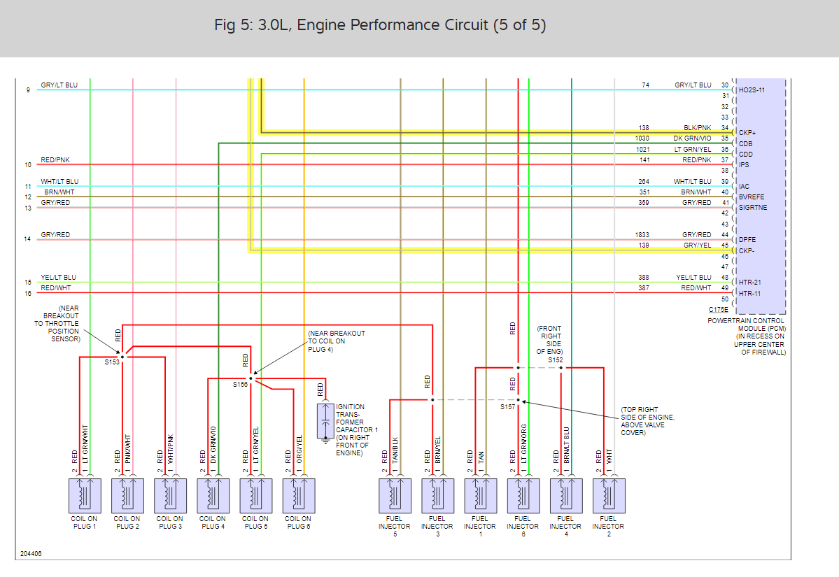

Engine shut off while idling it cranks but will not start?
2021 FORD ESCAPE
17,000 MILES • 3.0L • V6 • 4WD • MANUAL
4X4PLEASE

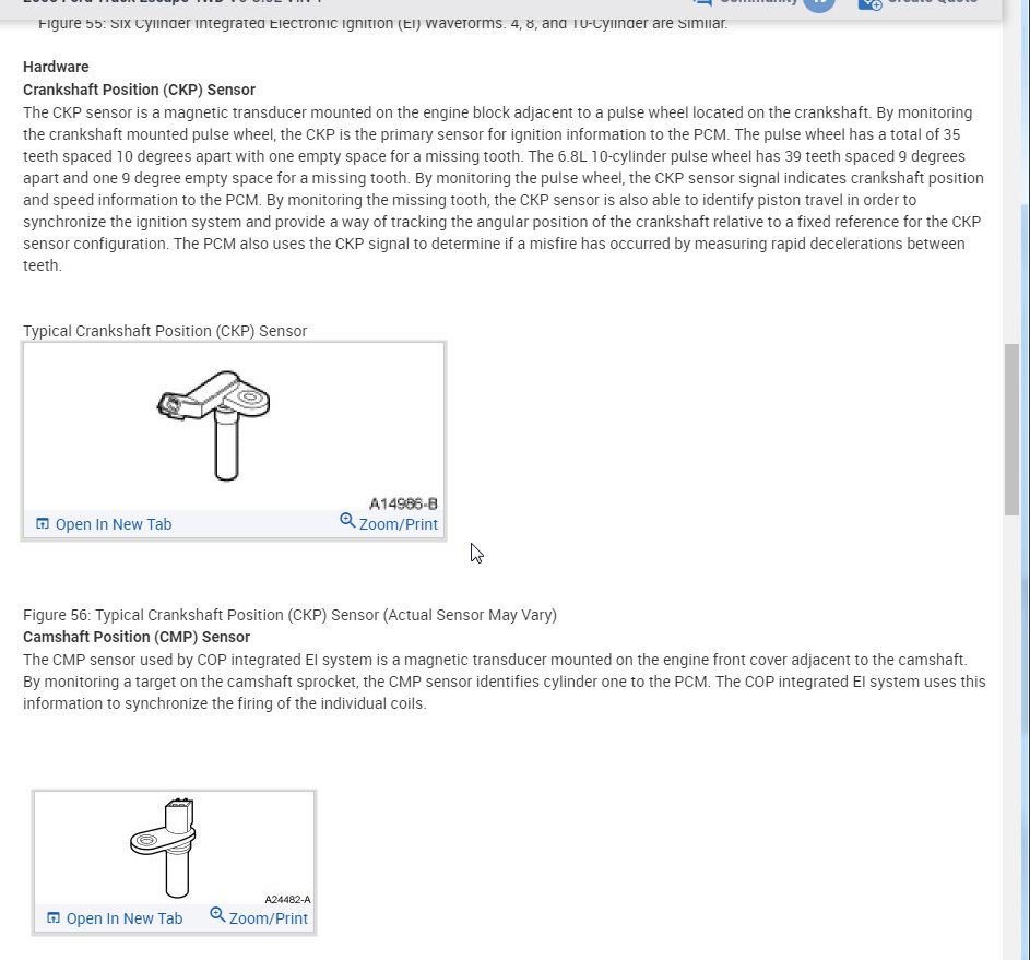

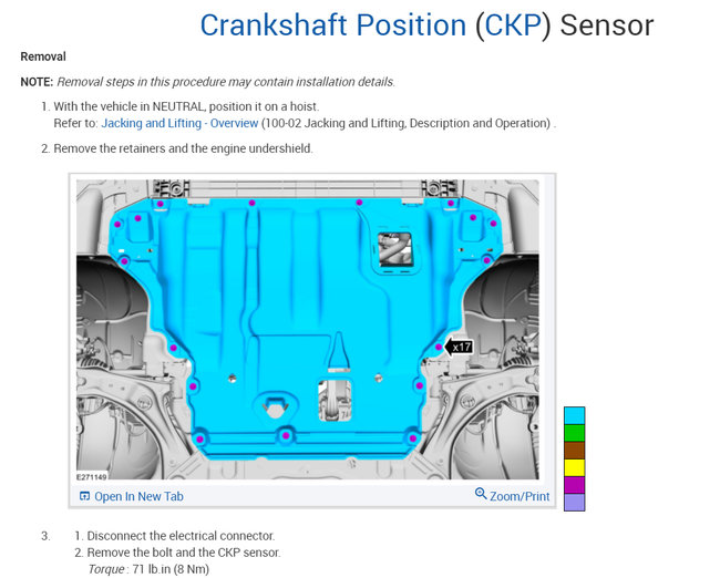

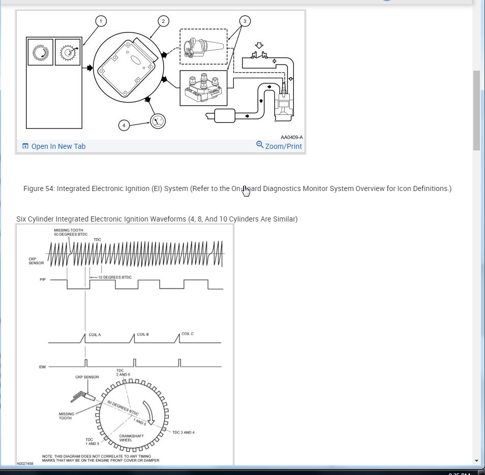

was sitting idling and just shut off for no apparent reason. it turns over, i believe it gets fuel in the fuel and to the injectors but not to the spark plugs. i can take spark plugs out and put a little fuel in each one and it fires up for maybe 2 seconds.
Jun 19, 2020 at 4:21 PM
Good morning,
When you turn the key to the on position without cranking the engine over can you hear the fuel pump run in the tank for 5 seconds?

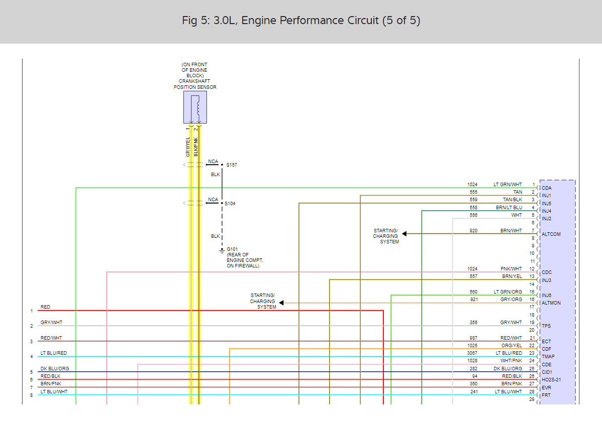

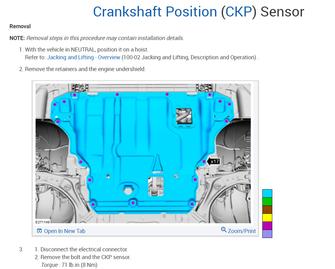

It sounds like the crankshaft sensor could be shirted out and needs replacement if so here are instructions in the diagrams below. Check out the diagrams (Below). Please let us know what you find. We are interested to see what it is.

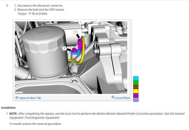

It sounds like the crankshaft sensor has gone out but to be sure this guide will help us fix it,

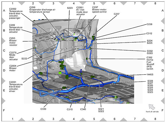

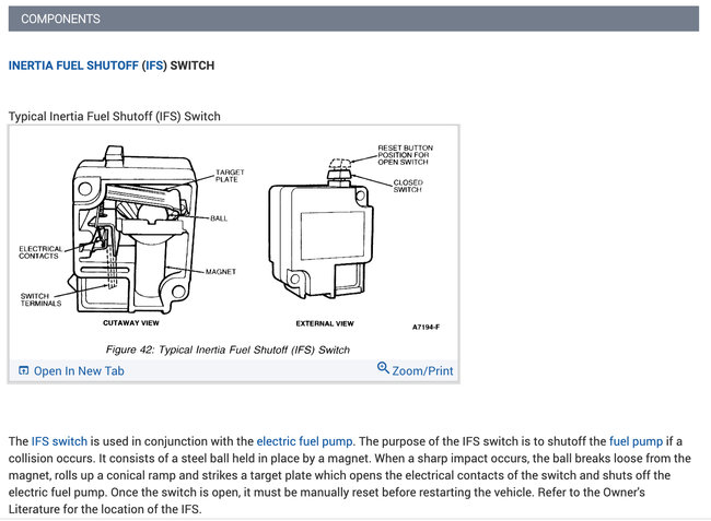

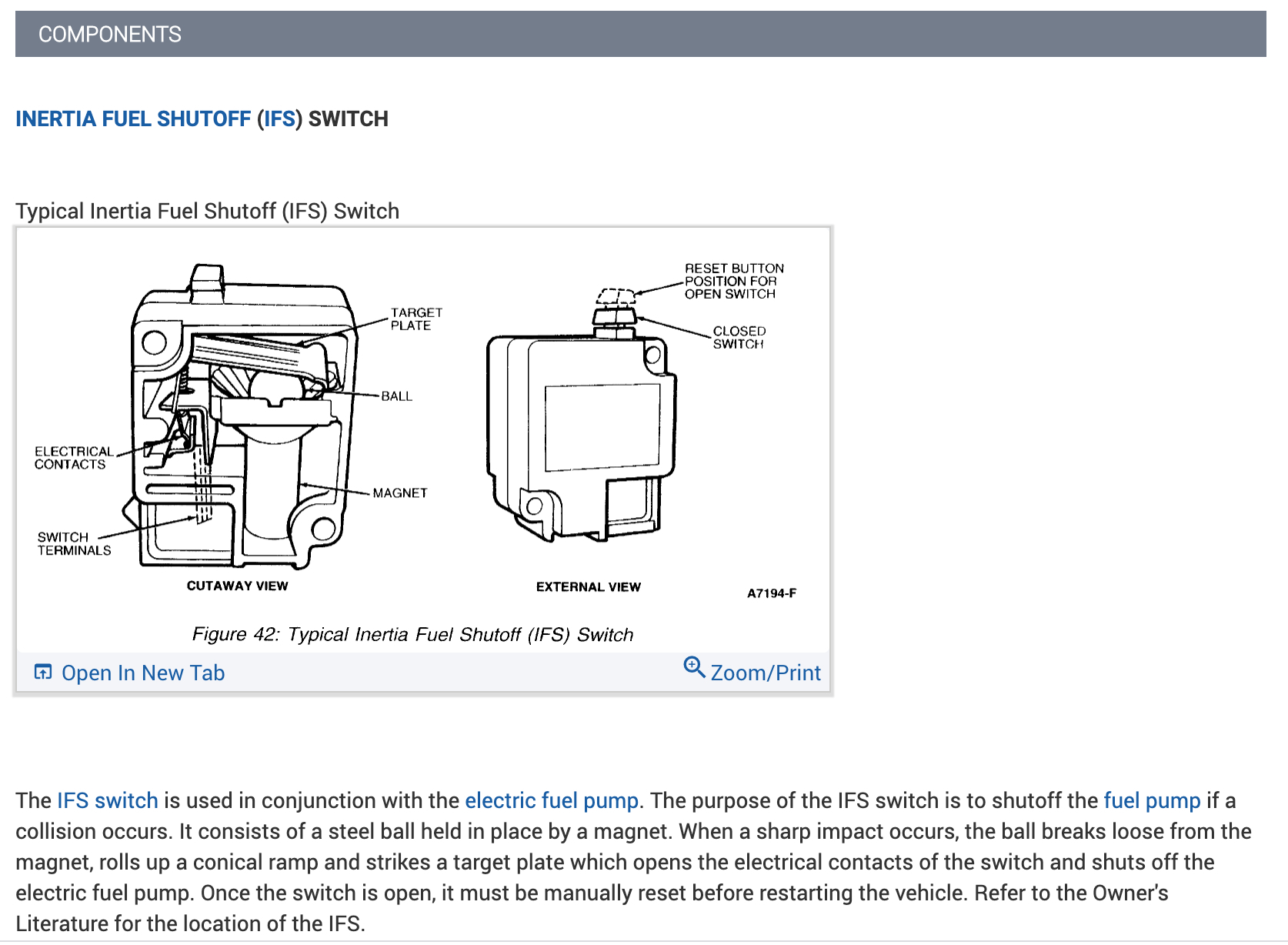

Check to see if the Inertia switch has tripped. It is located behind the right kick panel. If is has tripped, there will be a red button on top that pops up. Try to push it down.

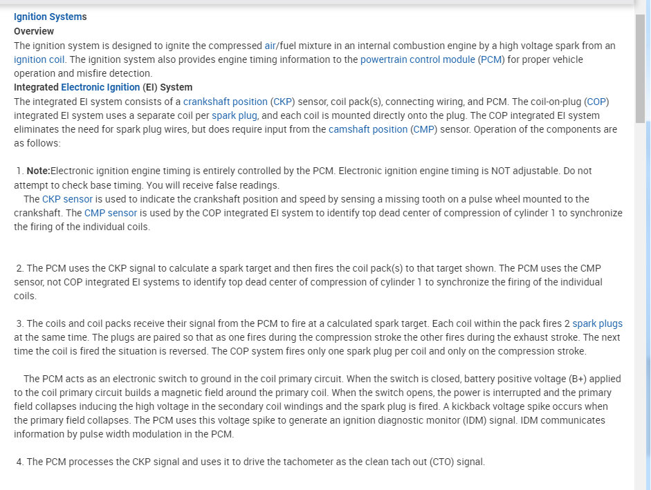

We need to see if the engine is losing fuel pressure or spark.
Here are guides to help us get started:
and

The fuel pump won't turn on.and it won't start with starting fluid. Changed fuel pump 2 times. All fuel and relays are good. Battery good.what else can we try?
Aug 12, 2020 at 6:12 AM (Merged)
JOETECHPRO
  • 705 POSTS
Hey JACOBR,
Can you please first check the inertia fuel cut off switch?
I have attached a description and location for the inertia cutoff switch.
Press the reset button and retry, if this makes no change then then disconnect the inertia switch and bridge the two connections.
Will the vehicle start now?
Regards, Joe
JACOBR
Already tried that!

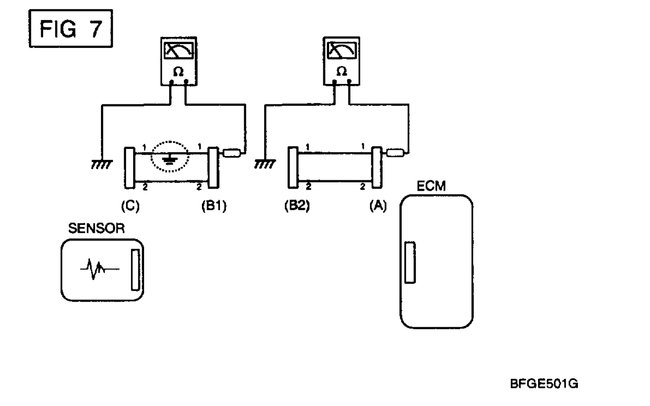

NANCY HEPOLA
My car will crank but wont start and no spark.I have changed battery,fuel filter, fuel pump.Crankshaft position sensor.What else can it be?
SCGRANTURISMO
  • 4,897 POSTS

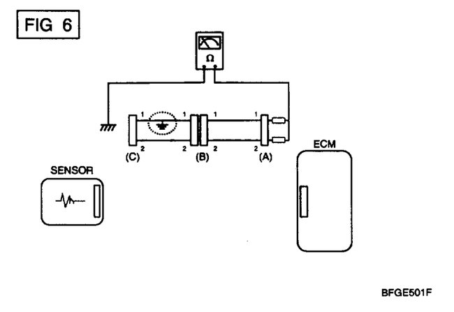

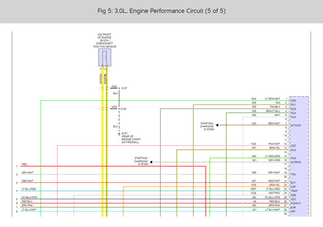

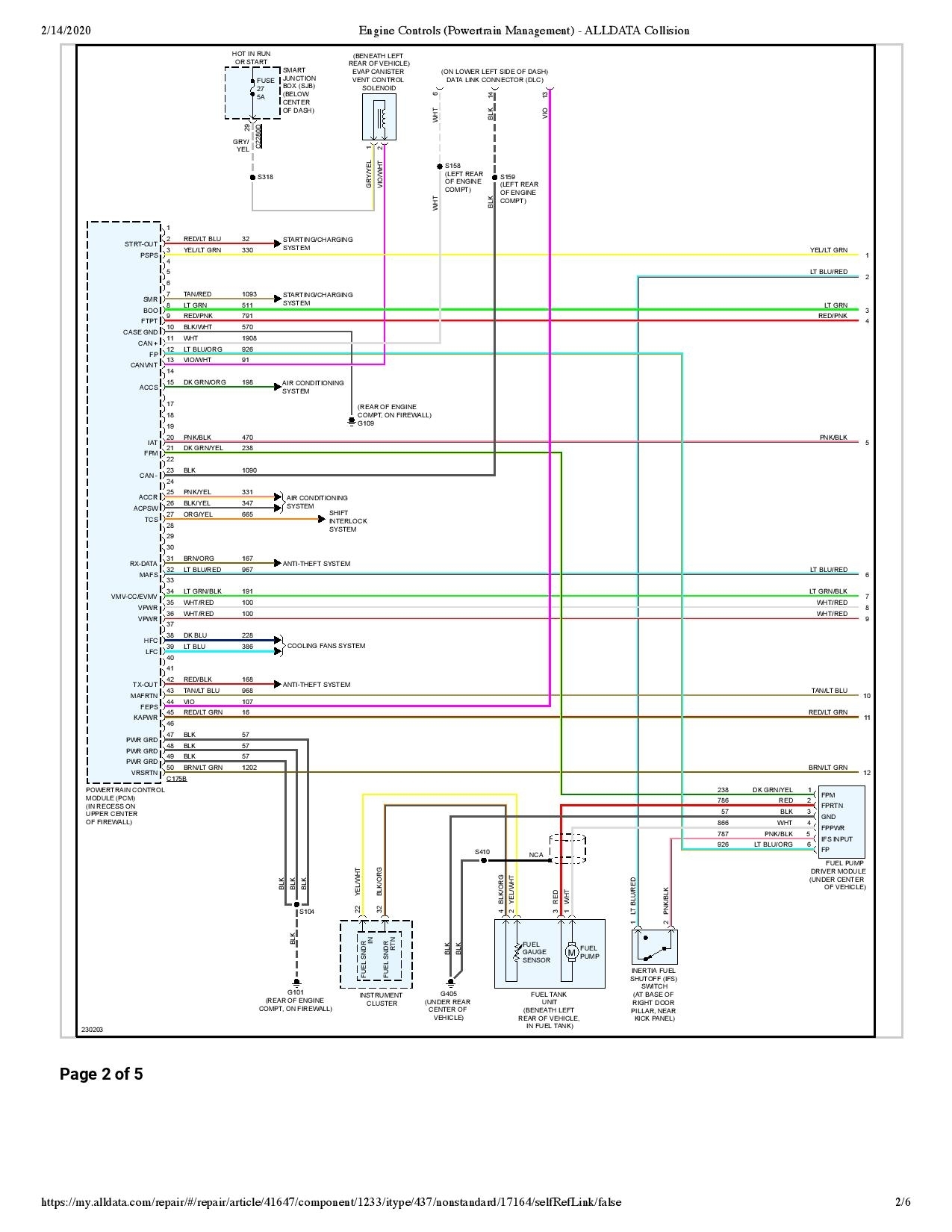

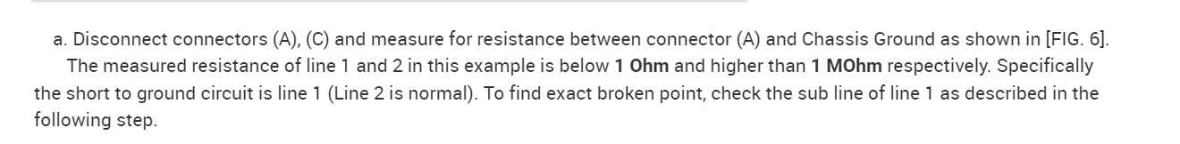

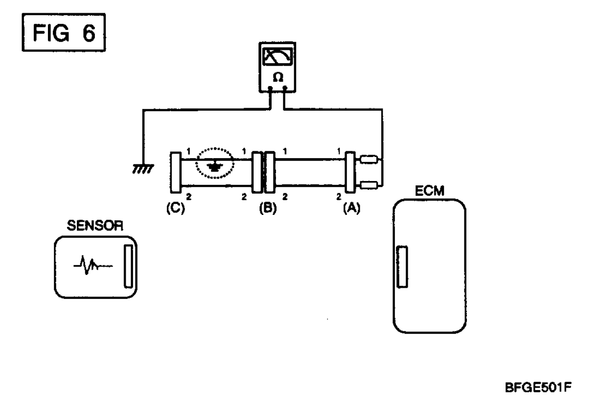

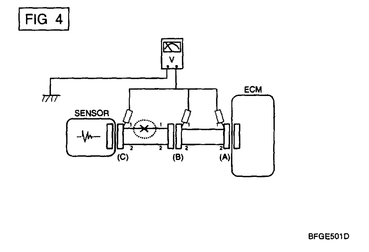

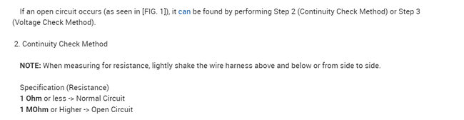

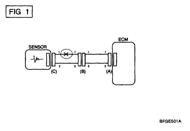

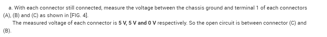

This could be a problem with the wires going from the Crankshaft Position Sensor (CKP) to your vehicle's Power-train Control Module (PCM). In the diagrams down below I have included a wiring diagram with the wires highlighted for you. You will need to check for an open in the circuit and I have included instructions for how to do that as well, but it will require you to use a multi-meter. Here is a link for you to go to if you are unfamiliar with how to use one.
Please check these wires and get back to us with what you are able to find out.
Thanks,
, Alex

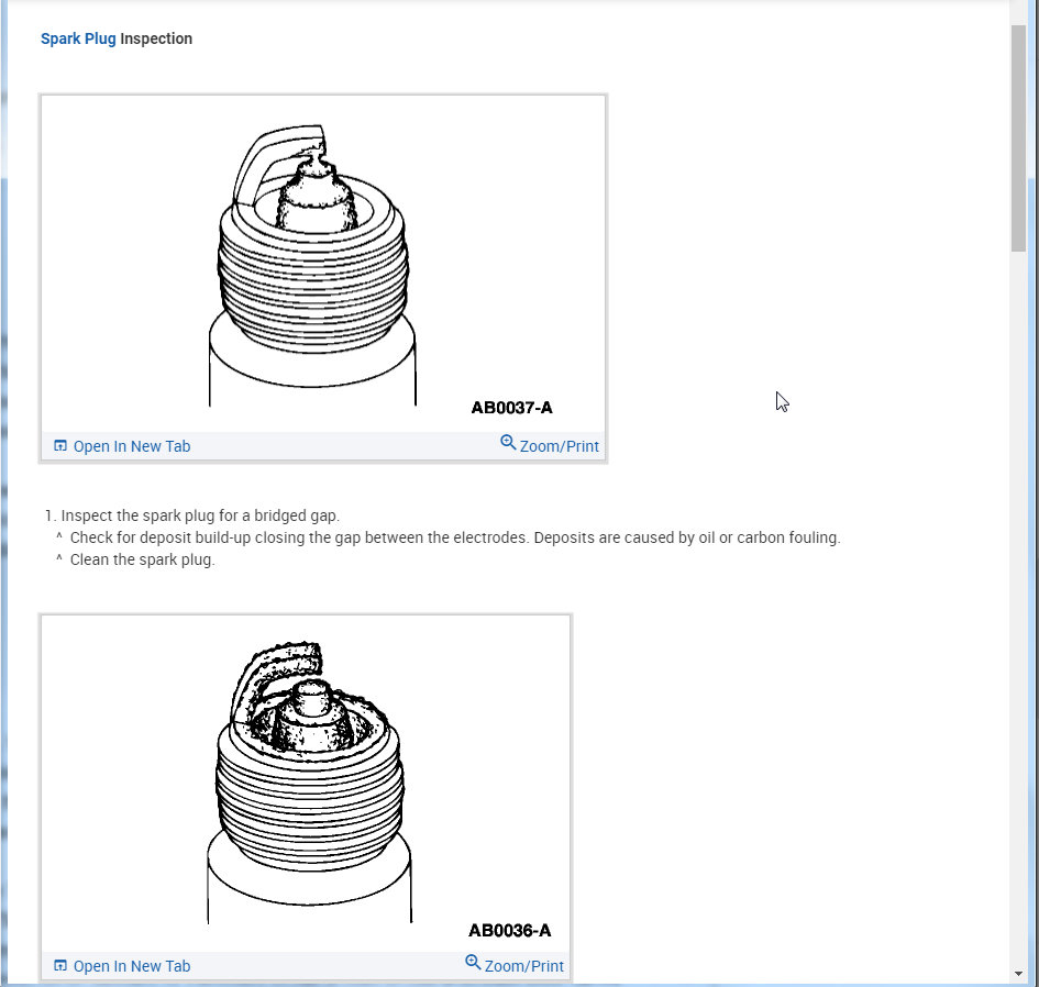

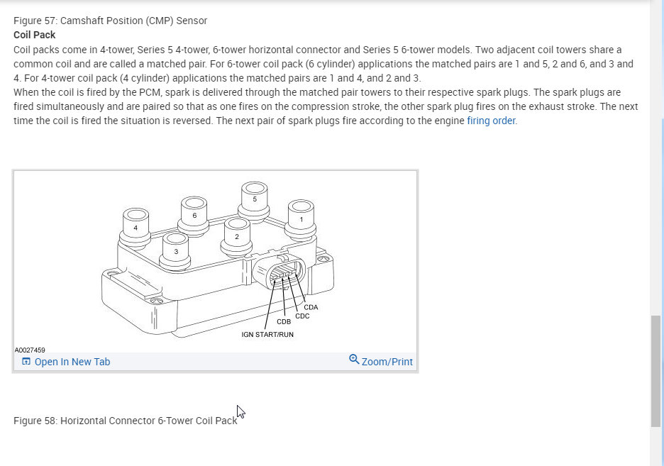

DANIELPSTANDRE

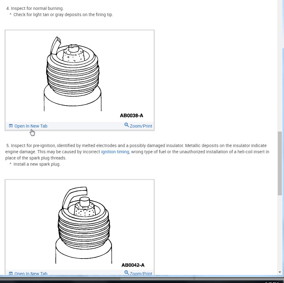

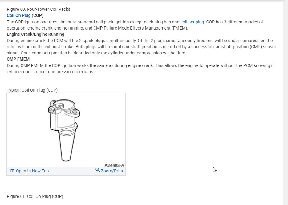

Someone changed all the plugs and coils.But they are aftermarket.The computer was also repaired and programmed and put back. it has spark but it seems yellow not blue. I do believe it has fuel pressure, but i am not sure yet.It wants to start but doesn't. The new plugs seemed soaked with gas.I don't know what to do from here.Another shop also tested the front for compression it read fine.
Aug 12, 2020 at 6:13 AM (Merged)

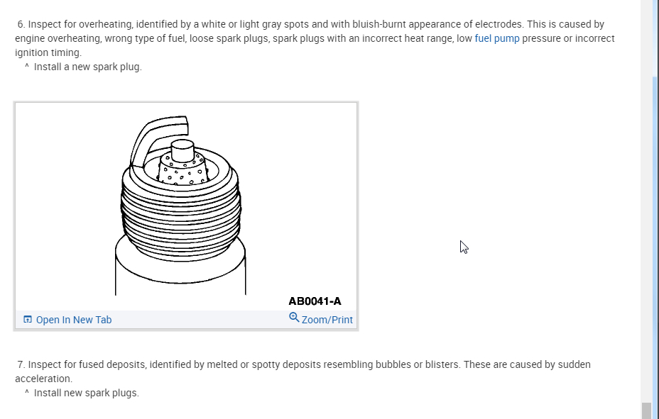

Okay. Based on all this we need to start with new plugs. If they are soaked with fuel, then you may have fixed the issue with one of the other repairs but all the cranking prior to the "fix" getting installed it could have fouled the plugs again. So put new plugs in and try cranking it. If it does not fire then stop cranking so you don't foul the new ones. At that point we need to check the spark again. If it is still yellow then we have a secondary ignition issue. However, this is unlikely due to it being new coils.
Let me know what happens when we get good plugs in there.
DANIELPSTANDRE
Okay, changed the new coil packs to better ones it did nothing.what does it mean when it will run without a spark plug in it?
DANIELPSTANDRE
I also tested the slark with a new spark plug not the one in it.
Did you change the spark plugs or the coils? If the spark plugs are fouled with fuel then they will not deliver the proper spark to allow it to start.
As for it running without the spark plug installed, I am not sure I understand. Did you remove the plugs and try to start it and it started? So it would not start until you removed a plug? How many did you remove when it started? Let me know if I am misunderstanding. Thanks

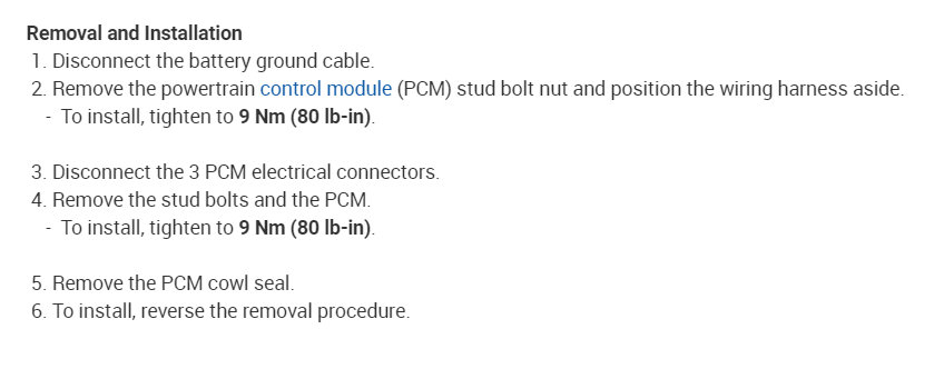

CRUISERBOY811

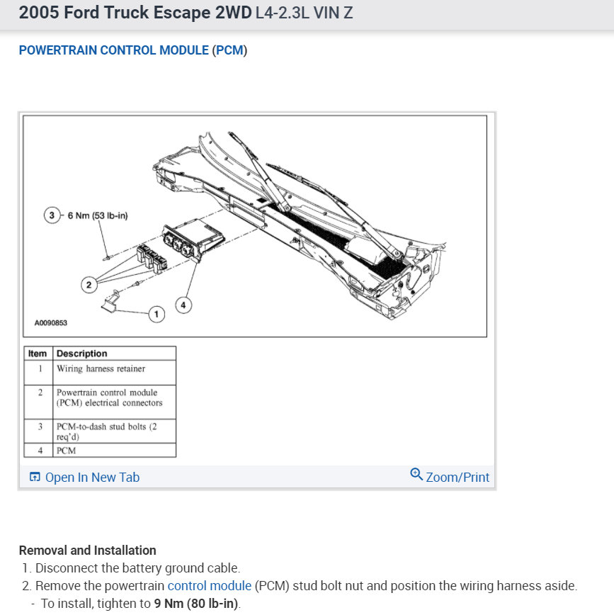

I have a 2005 ford escape 4 cylinder engine 2.3 liter ,it cranks but i can turn on the vehicle in any way not even with ether ,it displays only dashes on the odometer and i don't know what this means ,car wont start and the obd can does not link to the vehicle i have tried 3 more scanners an with all 4 scanners wont link too.the mileage registered is 75336 was placed on the work order.
Engine and transmission were pulled out just for a replacement of the front transmission seal and all has been placed in order i have check and double check all the electrical connections and rechecked all ground point and fuses ,relays and all that is involved ,there is a good spark in all 4 plugs and fuel pressure is in order but just wont start ,engine was running perfectly and smoothly once the vehicle arrived and engine also was covered for dust or water entries. any help would be great!
Aug 12, 2020 at 6:16 AM (Merged)
CJ MEDEVAC
  • 11,004 POSTS

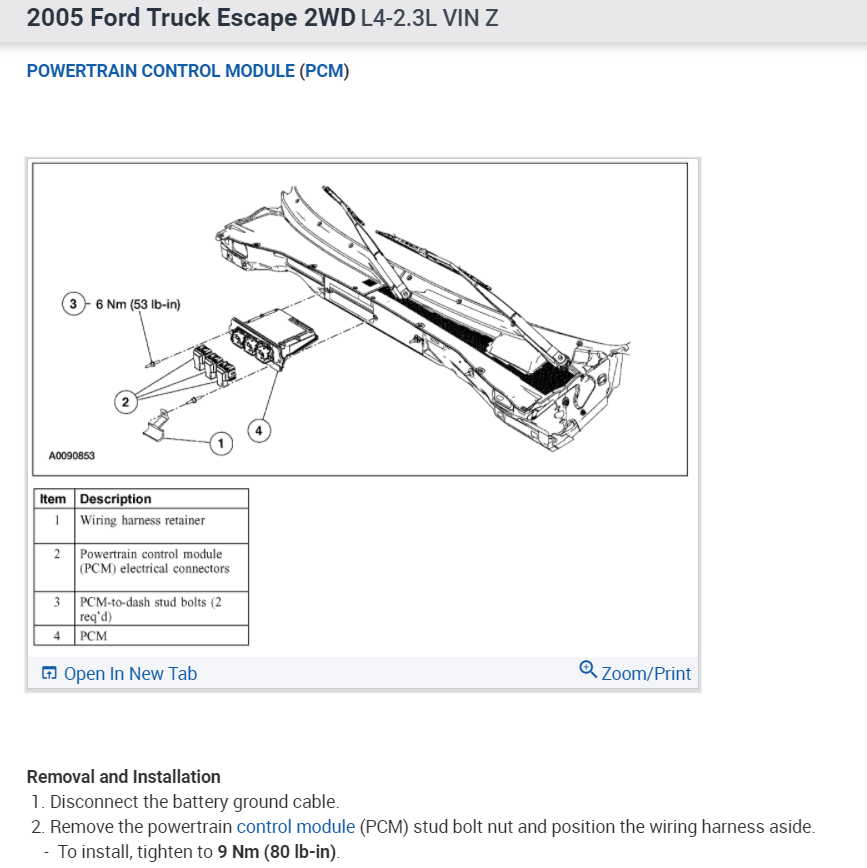

I have seen the PCM go bad in these cars here is how you can replace it in the diagrams below. Check out the diagrams (Below). Please let us know what you find.
