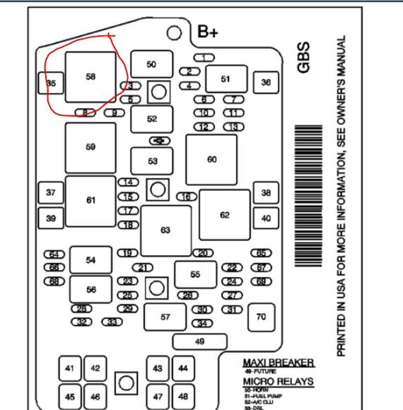

I have changed the cam sensor, have a new battery, fuses are good. I am not getting any power to turn the car over. The computer is working, the lights on the dashboard do come on, but still will not crank.
Nov 9, 2020 at 9:12 PM
Good morning,

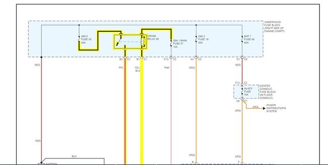

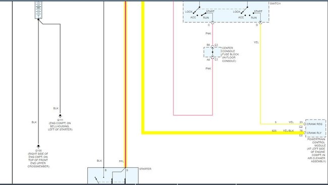

I attached a diagram for you to view the starting system.
You need to do some voltage testing at the relay to be sure the current is available for the starter to crank the engine.
