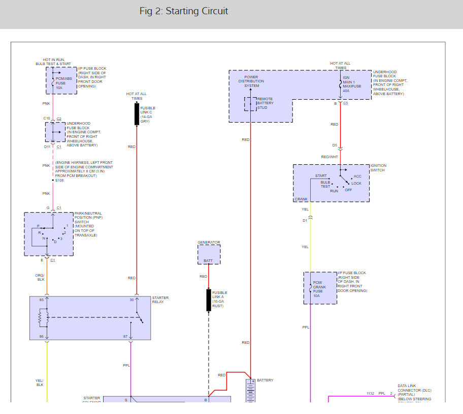

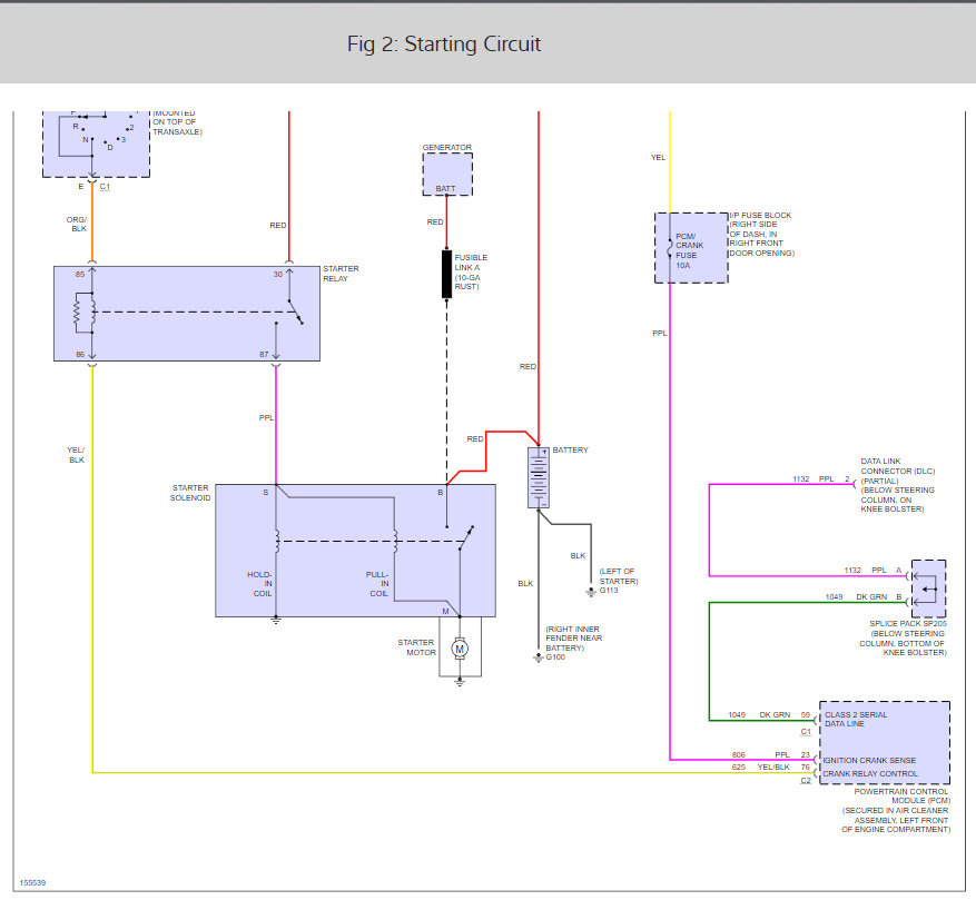

I changed the battery got a new one and a new starter. I had the alternator tested it passed. Then I put it all back together and it still will not start.
Aug 23, 2018 at 8:03 AM
  • 55,433 POSTS
It sounds like the starter has gone out but to be sure you need to test the starter trigger for power when the key is turned. Here is a guide to help you see whats going on:
Here is a guide to test the wiring and the starter wiring diagrams to help you see how it works:
