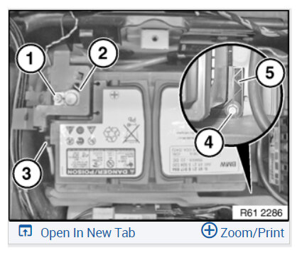

My battery drained; I went to AutoZone. Put the new battery in now. The car will not start. when I turn the key. It turns over, but it won't stop and the engine light comes on, no code. Someone at AutoZone told me. I need a program for the new battery if that's so how do I do that?

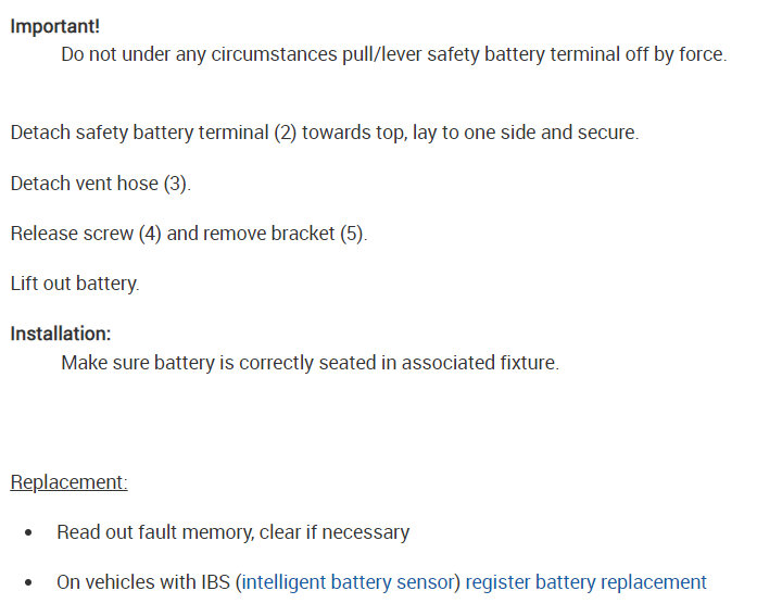

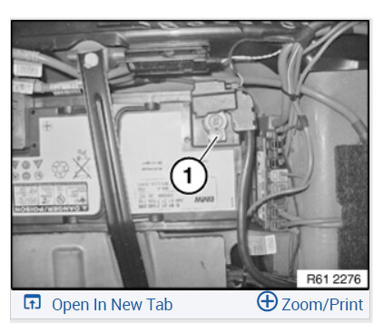

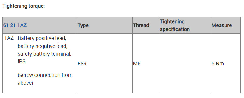

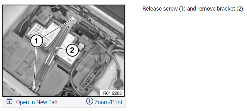

Yep, you must register the battery when installing a new battery here is information on it.
There are two ways to carry out a voltage interruption of the 12-V battery:
Manually by disconnecting the battery ground lead
With the diagnostic system
1. Manually: Carry out the following steps:
Switch off and disconnect battery charger
Turn off ignition.
For vehicles with ignition key: Ignition key in neutral position
Vehicles with ID transmitter: Remove ID transmitter from slot
For vehicles with Comfort Access: Secure terminal 30
Disconnect negative battery lead
Reconnect battery ground lead (to ensure bus activity)
Observe a waiting period of 5-10 s
Observe a waiting period of approx. 1 minute
Connect battery ground lead
Connect and switch on battery charger
Switch on ignition
2. With the diagnostic system:
03 Body
Voltage supply
Activate rest state
Power-down command
Here is more information:
If the vehicle electrical system of electric vehicles is not accessible due to a faulty 12 V battery, proceed as follows:
Battery exchange in electrified vehicles
Vehicles with the automatic engine start-stop function or particular engine types and optional equipment are equipped with a special vehicle battery (AGM battery), since only this battery type can provide elevated power requirements over the extended service life. Installing a different vehicle battery can cause problems with vehicle electronics, can reduce functions or can cause leakage of battery acid.
Vehicles with energy management systems (IBS, power module): Register battery exchange.
The vehicle electrical system is informed about the vehicle battery characteristic data, such as type, size, age and current power capacity. Therefore, there will always be only one work scope provided that is permitted by the current status of information.
When installing a new vehicle battery, the battery must be registered and thus must also be registered with the vehicle electrical system.
Diagnosis system:
Service functions
Body
Voltage supply
When retrofitting, a more powerful battery may be used. Standard batteries may always be replaced by AGM batteries with the same specifications.
When installing a battery of a different size or a different battery type, this change in vehicle data must be programmed into the vehicle data in accordance with specifications.
Check out the images (below). Please upload pictures or videos in your response of the problem so we can see what's going on.

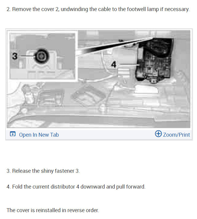

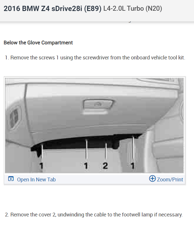

Yep, it has been a minute. I hope all is well. So, it sounds like you had a voltage surge when you connected the battery which can happen, I would start by checking all fuses. here is a guide to help and I have included where the fuses are, please test them with the system on:
If all of the fuses are okay let's do a CAN scan. You can get a CAN scanner (Controller Area Network) which will work on most cars from Amazon.
https://youtu.be/u-4syLc-ifQ
Check out the images (below). Please upload pictures or videos in your response to the problem so we can see what's going on.

Hello Ken, my friend, I hope all is well. You're not going to believe what happened. Apparently, I have mice or rats in my garage. They got up in the engine in chewed wires. I guess I best not let the car set so long without starting it. I got it fixed the car runs great. thank you for your support as always, Kenny
