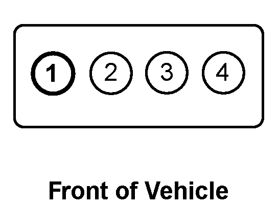

Truck was running a bit sluggish and did the whole tune up now it doesn't want to start.
Apr 25, 2021 at 11:50 AM
  • 110,240 POSTS
If this started since the tune-up, are you sure that the spark plug wires are installed correctly? I attached the firing order below. Let me know.
Also, let me know what all was done for the tune-up. If possible, record the engine cranking and upload it for me to hear. I may be able to recognize the problem if I hear it.
Here is a link you may find helpful. It discusses the most common causes of a crank no start condition.
Apr 25, 2021 at 2:01 PM
JOSE MUNOZ
Oil, filter, cables, spark plugs, distributor cap and that thing that goes under the cap. firing order is right. check for sparks on each plug. got I took off the hose after the gas filter to see if gas is going up there is. it cranks but just won't turn over. oh, and I think it had the original stuff cables, cap, cables, were numbered and cap still had the Nissan logo.
