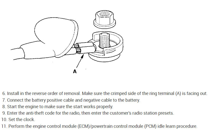

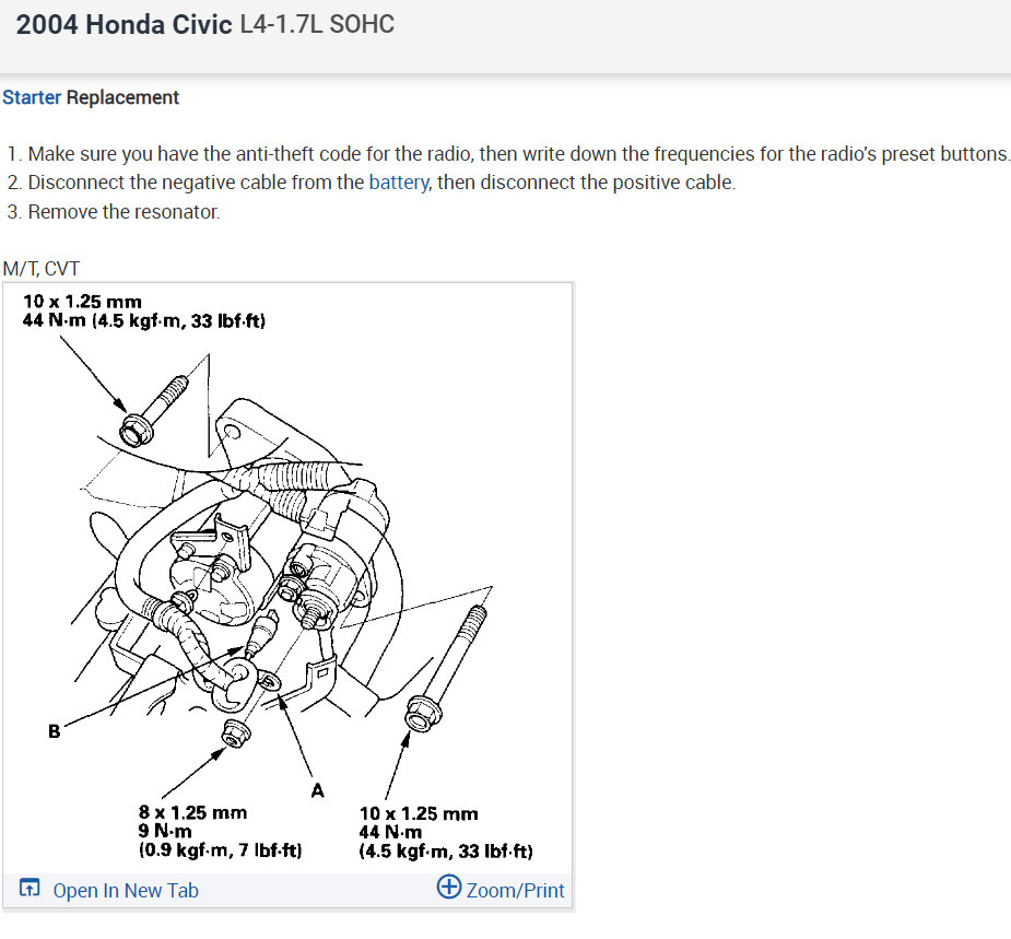

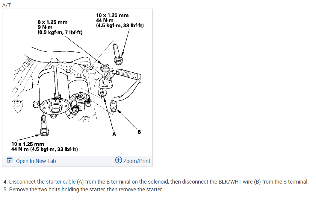

Hondas had this problem, replacing the starter motor usually fixes it. here is how in the diagrams below. This guide can help as well:
Check out the images (below). Please upload pictures or videos in your response of any problems so we can see what to help you with.
Oct 7, 2024 at 10:32 AM
H20HH
i will replace starter and see how that goes… hoping that takes care of this! will let you know how it goes, thank you!

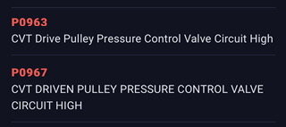

i replaced the starter, unfortunately no change with the condition of the vehicle. it’s as though my obd scanner became some form of shut off switch and the car has no electrical power or the power gets drained very quickly the moment i remove the scanner from the obd port.

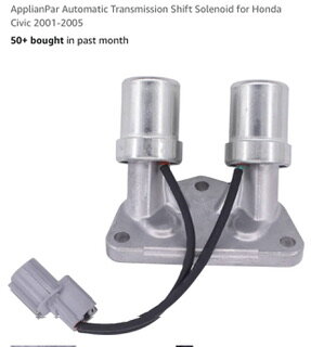

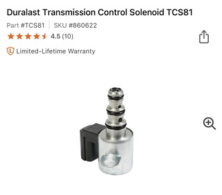

also now i’m getting a check engine light with P0963 and P0967 and the D light is blinking. i’ve replaced the transmission shift solenoid and also the transmission control solenoid, photos of parts replaced and obd codes attached.
any ideas/suggestions now?
