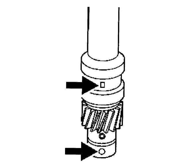

I was coming home from trip when it cut out and quit running. I replaced distributor due to wear on it. I just did a complete tune up. I thought it might be fuel related check filter fuel pump. Then I decided to try starter fluid to get it to start. It backfired through tail pipe and throttle body. I am not sure where to go next. I would deeply appreciate any help!
BTW I had new distributor put in by ASE certified mechanic!

I just turned it over and it is not moving at all. You can hear pressure popping through the throttle body like a rush of air pushed hard through it! Yes plenty of fuel pressure!

Okay, time to check compression. Check it to be sure you do not have a bad timing chain.
Also, I am concerned that the distributor is not installed correctly.
1. Bring cylinder number one piston to Top Dead Center (TDC) of compression stroke.
imageZoom/Print
2. Install the distributor cap screws.
3. Install the distributor cap.
imageZoom/Print
4. Install a NEW distributor gasket onto the distributor.
imageZoom/Print
5. Align the indent hole on the driven gear with the paint mark on the distributor housing.
5. Ensure that the distributor rotor segment points to the cap hold area.
imageZoom/Print
7. Align the slotted tang in the oil pump driveshaft with the distributor driveshaft. Rotate the oil pump driveshaft with a screwdriver if necessary.
8. Align the flat (1) in the distributor housing toward the front of the engine.
9. Install the distributor and distributor clamp.
imageZoom/Print
10. Once the distributor is fully seated, align the distributor rotor segment with the number 8 pointer that is cast into the distributor base.
11. If the distributor rotor segment does not come within a few degrees of the number 8 pointer, the gear mesh between the distributor and camshaft may be off a tooth or more. Repeat the procedure in order to achieve proper alignment.

You need to verify the distributor was installed on top dead center compression. Everybody makes mistakes. That is why I want you to verify.

I know for a fact he did not put it on TDC. On first he marked the older one then installed the new one by marking on the old one and started the truck right up! So I am guessing he did it wrong then?
Saturday, May 19th, 2018 AT 3:49 PM
  • 52,797 POSTS
Good possibility. You need to bring up the timing mark to TDC number one cylinder on the compression stroke. The mistake that is made is you can align the mark but it is on valve overlap instead which means the distributor is 180 out.
