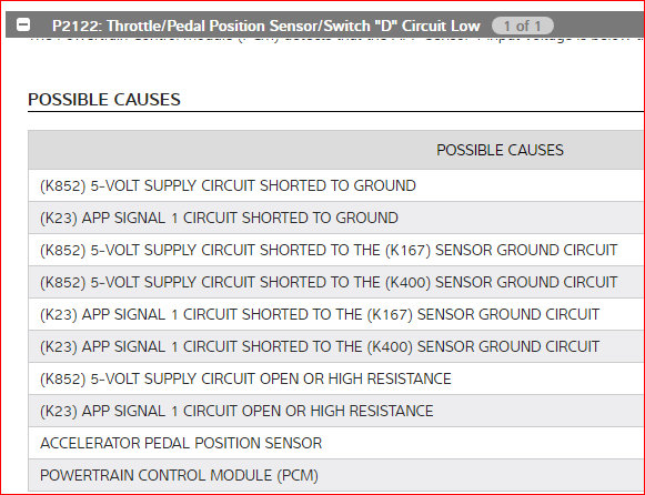

Dash warning light (electronic throttle control system). Scanner gives code P2122. throttle/pedal position sensor/switch D circuit low.

Hello, I'm Danny,
I've attached a list of things to check for possible causes.I'm also attaching a tutorial showing how to test wiring.
Hope this helps and thanks for using 2CarPros.
