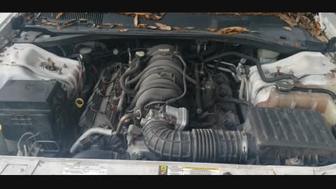

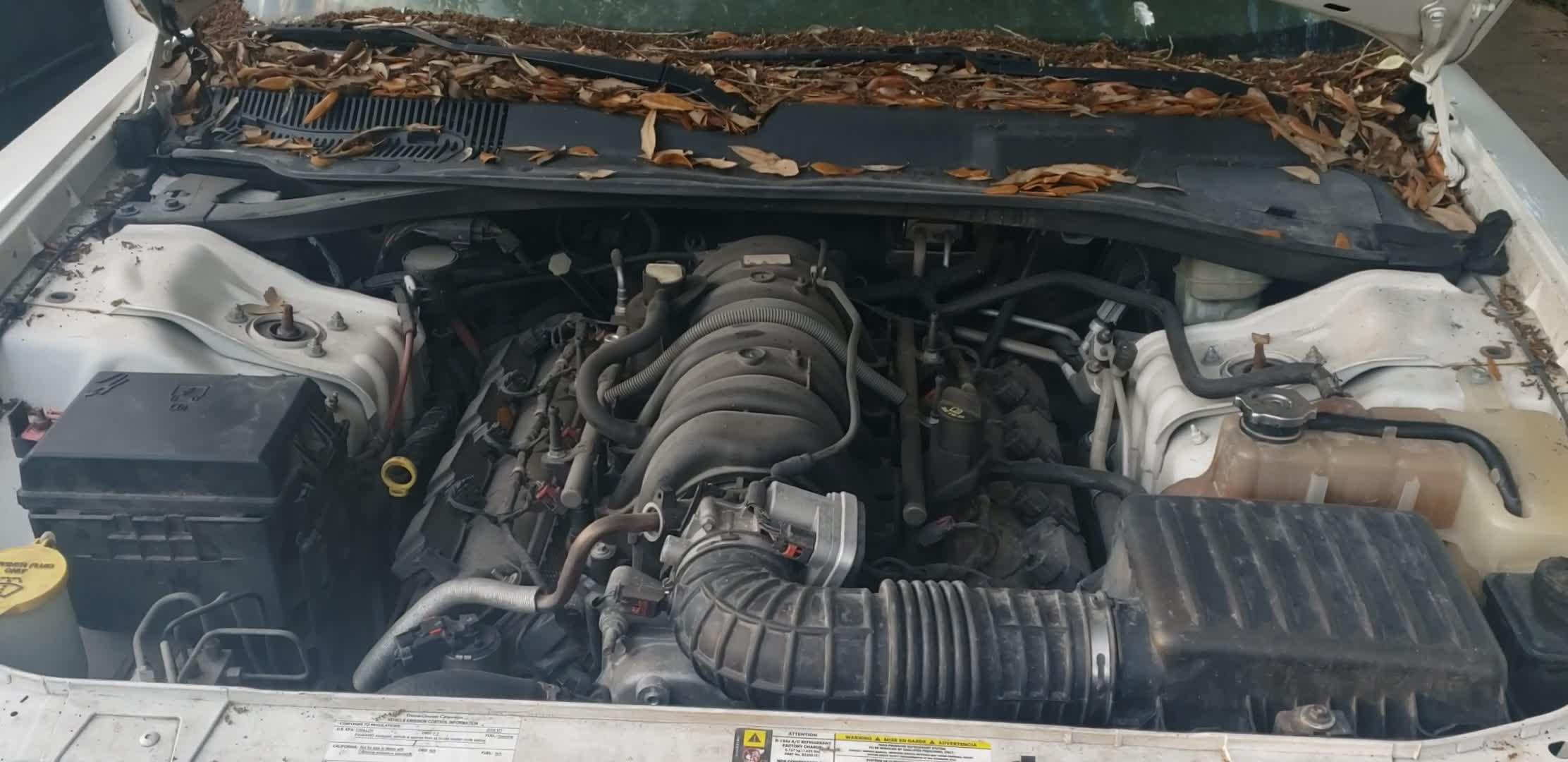

Car just cut off and wont start. When turning the key fob it just has a loud clicking sound and the engine overheats without starting.

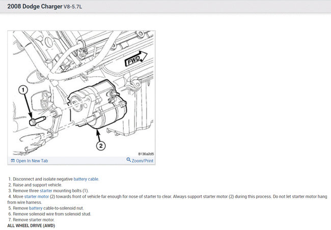

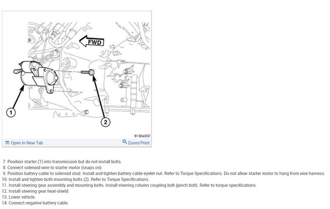

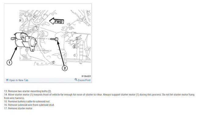

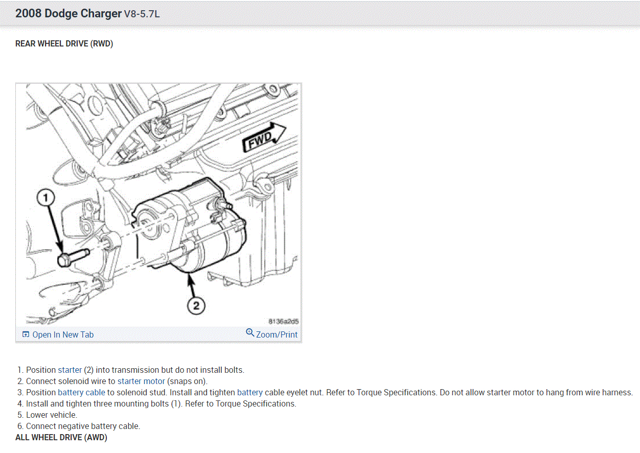

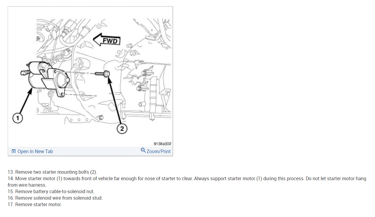

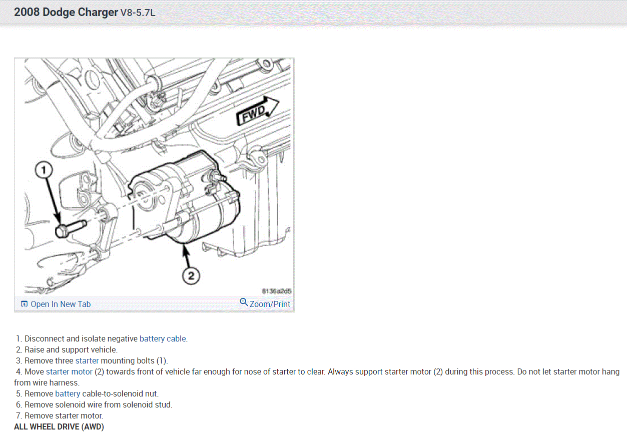

If you are able to turn the engine by hand, we need to remove the starter and have it bench tested at a parts store. I have a feeling the Bendix is working and engaging with the flywheel, but the starter isn't turning at all.

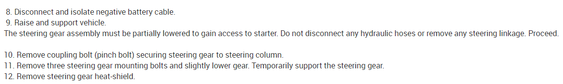

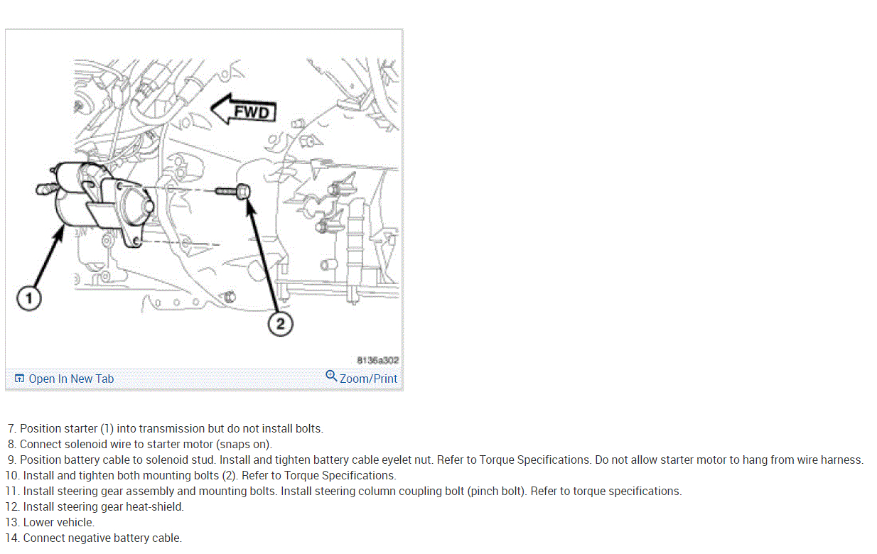

If you need to remove it, here is a link to get you started. It explains in general how one is replaced.
If you at the attachments below, they include the directions and pictures for removal and replacement specific to your vehicle.
