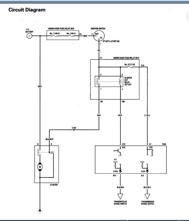

I have a new battery in engine compartment. I tried replacing starter but nothing happens when I try to start it the dash lights up fine when ignition is turned but all I hear is a click in the back seat and that is it. New starter has the same symptoms. Is it possible the hybrid battery needing replaced can cause this? It will not jump start either. Even with jumper cables you get same symptoms. I am stumped as I would have thought it was the starter.
Aug 1, 2020 at 11:26 AM
We need to start with checking what the voltage is at the starter on both wires that are going to the starter while you are cranking the engine. This will confirm that we are dealing with a voltage issue going to the starter. This will rule out the starter as we need to make sure you did not get a faulty starter right out of the box. It is unlikely but will cause many more headaches if we assume it is okay.
As for you question, the starting system is part of the 12 volt system and has nothing to do with the high voltage system. If there is an issue with the high voltage system it could cause the PCM to prevent the start but this doesn't sound like that is happening, at least not from what I am hearing.
I attached the wiring diagram and let's start with this voltage and go from there. Thanks
Aug 3, 2020 at 12:45 AM

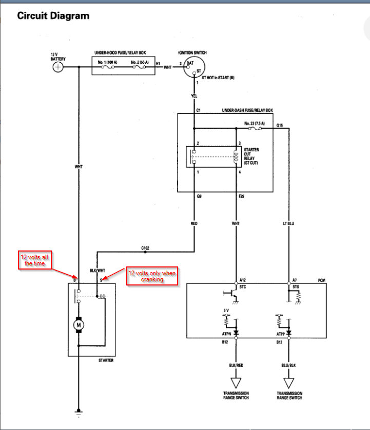

So I swapped the starter cut relay with power window relay and windows still work. So it’s not the relay. If I pull the lead which bolts to the starter and hook the positive lead of volt meter to it while grounding the black lead how many volts should I get when cranking? 12?
Aug 6, 2020 at 12:07 PM
You should have 12 volts on both wires but what color was the wire that you unhooked? You need 12 volts on what should be the white wire from the battery, all the time. In other words, this should have 12 volts no matter what position the key is in. The other wire, should only have 12 volts when you are cranking the engine and you do not need to unhook it from the starter. Just leave it connected and put your meter on the stud and check your voltage when cranking. Let me know and we can go from there. If you don't have 12 volts on this wire, let me know the actual voltage because that will matter. Thanks

So I tested battery and have 12v just to check it. Did continuity test on main fuse and it is fine. Put red lead on bolt that wire attaches to and grounded the black and get no readings with or without turning key. I presume the other color wires are at the plug. I will have to take a couple things off to reach it and unplug to test. Any other thoughts before I do that?
Aug 9, 2020 at 9:06 AM
DTDODD1422
  • 18 POSTS
Just double checked I have 12v at the nut. Originally I had my tester on wrong voltage.
Aug 9, 2020 at 9:27 AM
Okay. I just want to confirm the wire color that you got 12 volts on. If you have 12 volts on the control wire while cranking (the labeled "12 volts when cranking" on this diagram) then you need a starter. The fact that you put a starter on it and have the same issue, I suspect this is not the case. So I suspect you tested the battery feed wire that has 12 volts all the time.
Also, just a thought that we should confirm. If you are getting a click but the starter is not turning over, just make sure the motor is not locked up. You have not mentioned anything that would make me think that before now but you should be able to turn the engine over by hand with a socket on the crank pulley bolt.
Aug 10, 2020 at 11:58 AM
DTDODD1422
  • 18 POSTS
So we test the connector to the starter and had 12v when turning key. I put a socket on the crank shaft and it turned both directions with not too much effort. Went back to auto store and had them test that starter. Guess what. He couldn’t get it to do anything. Ordered another and will make them test that one as well before bringing it home and installing it. Will let you know the verdict. Thanks
