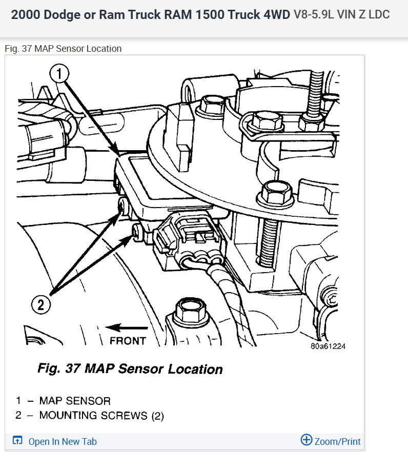

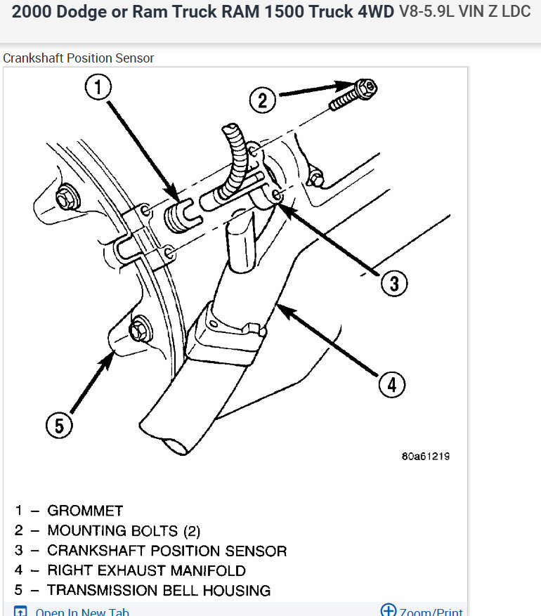

So for a while when it rained occasionally it wouldn’t start without jumping it off. Flash forward most recently the hood flew up on me just as I was starting to pick up speed after leaving home. Took the hood off to change or fix the hinges and hubby noticed a scrubbing sound when driving and braking so changed out the pads and rotors. Well, he didn’t get it all the way back under the carport and thus Brutus isn't starting. With much aggravation we (yes, we) got the distributor cap off and fully cleaned it noting no water present. So, I changed all the fused a I had replacements for and still it won’t what I call catch he says start. Just turns. About to go change out the plugs and wires and cap and rotor and just in case wanted other things to try if this doesn’t work. FYI hubby bought it brand new in 2000 right after he graduated from the cat diesel school in Nashville. So, it is very important to us. Especially since I first met him like two weeks after he got it. So, advice is greatly appreciated

Yep, I can help you get it running, it sounds like the crankshaft angle sensor is not working but we can test that by checking for spark, this guide can help:
https://www.2carpros.com/articles/how-to-check-for-ignition-spark
Also, you can try starting fluid to see if the problem is fuel related, also how does the engine sound when cranking over, normal? If you upload a short video of the engine cranking, I can tell if the engine is hurt or not.

Here is the crankshaft angle sensor so you can check it out, also I would unplug the MAP sensor and try to start it because if this sensor goes bad it will not allow the engine to start. Check out the images (below). Let us know how it goes.
