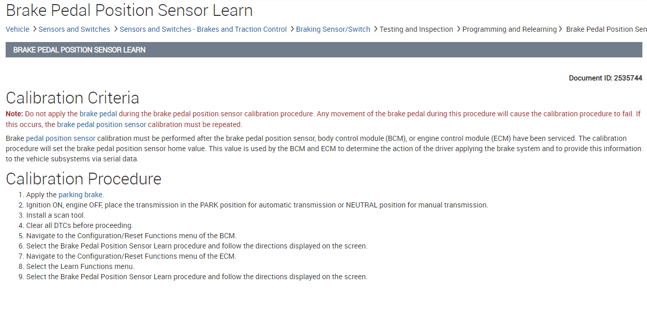

Transmission will not shift when brake pedal depressed
2015 BUICK ENCLAVE
123,000 MILES • 3.8L • 6 CYL • 2WD • AUTOMATIC
TUCKER1963
You can start what 3 minutes depress brake pedal and try to shift, it won't shift.

Hi Tucker1963,
We can help. it sounds like a brake switch issue,
First scan for codes. (see links below)
If there is no codes stored continue to brake sensor calibration.
I am glad to help you. If there is anything else we can help you with please contact us again. Thank you for choosing 2CarPros.
