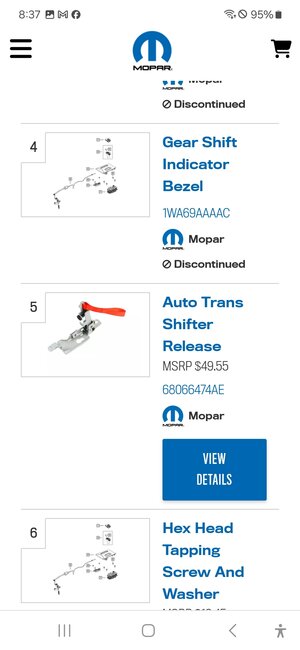

The console shifter won't move when the car is running. It will move but not shift into any gear when not running. Under a storage tray to the right of the shifter is an orange pull strap the controls a lever. I thought it was the shifter override, but it doesn't appear to be. Is there another shifter override in front of the console shifter. The knob is held on with a torx screw, so I wasn't able to remove it when I went to check the situation out. I did confirm that the shift cable was attached to the transmission linkage, but I didn't try shifting the transmission at the linkage yet. The instrument cluster dropped out but the fuse in the truck is good. I couldn't find any designated under the hood to the instrument cluster. I'm not sure if the two issues are related or if we're looking at a BCM or ECM issue. I will get the shift knob off and the cover plate so I can see if the cable is connected to the shifter. What would be causing the shifter to be locked? I look forward to your response, right now the car is stuck where it is. It does start and idle fine.

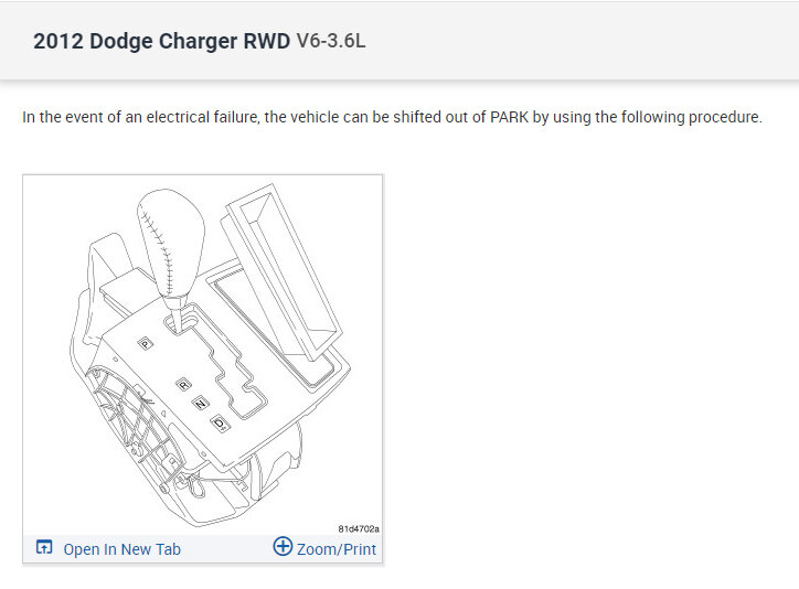

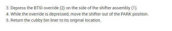

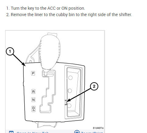

Are the brake lights working? Power to the park lock actuator comes from the brake light switch.
As far as a bypass, I attached the directions below. Give that a try and let me know if it helps.

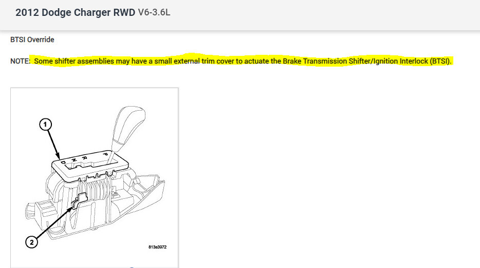

I will find out if the brake lights work. However, this vehicle does not have that override. There is an orange pull loop on a steel lever that lifts up? Aren't they also supposed to have another override? It seems the shifter is stuck in the middle range of the gate between P and D. When it is manually moved it goes right back to that position.

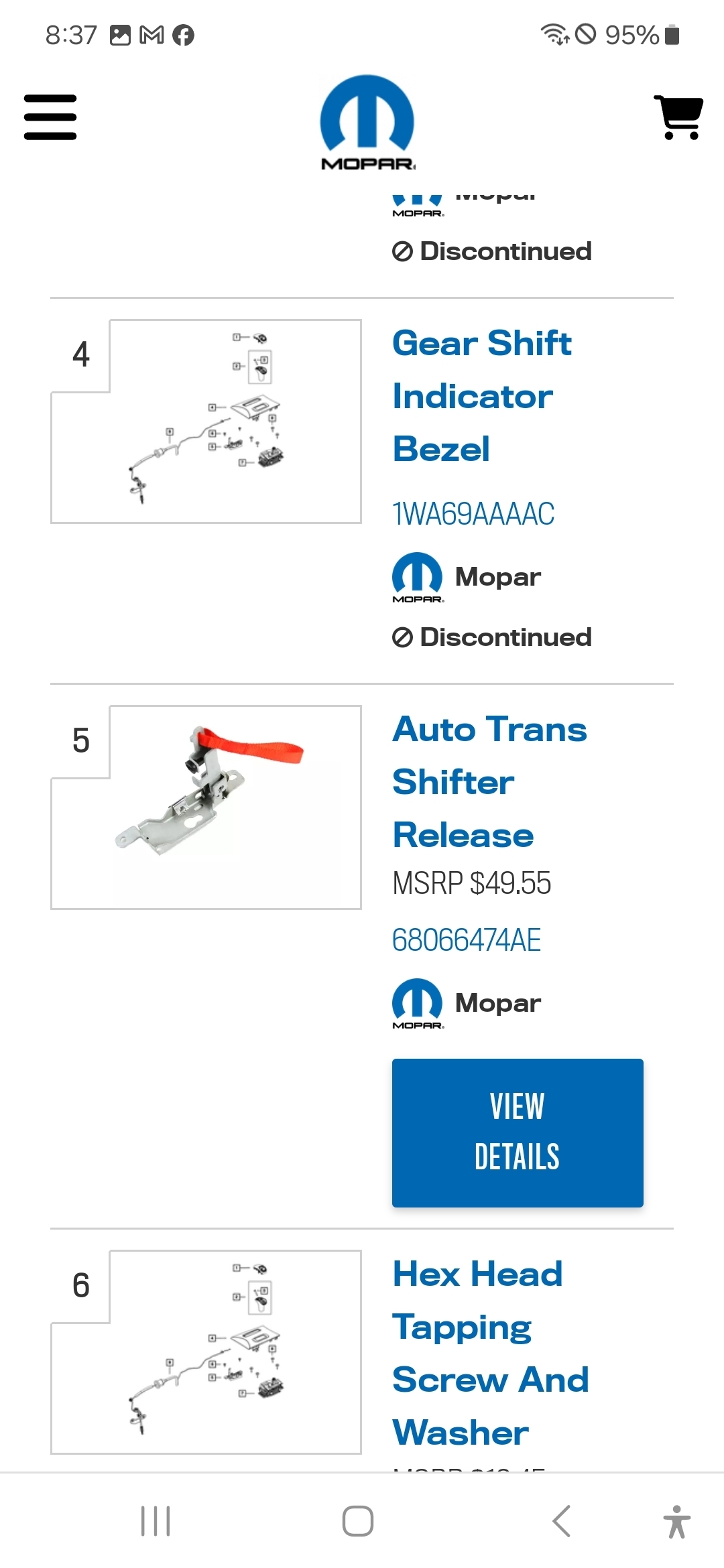

  • 110,194 POSTS
Jeff,
I attached a pic below that I found. Does this help? Other than these two, nothing other is provided for this vehicle.
See pic below.

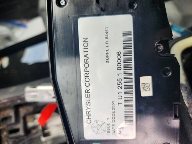

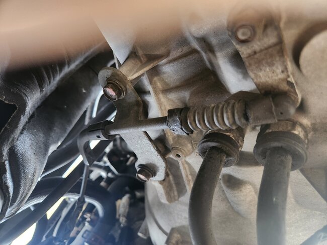

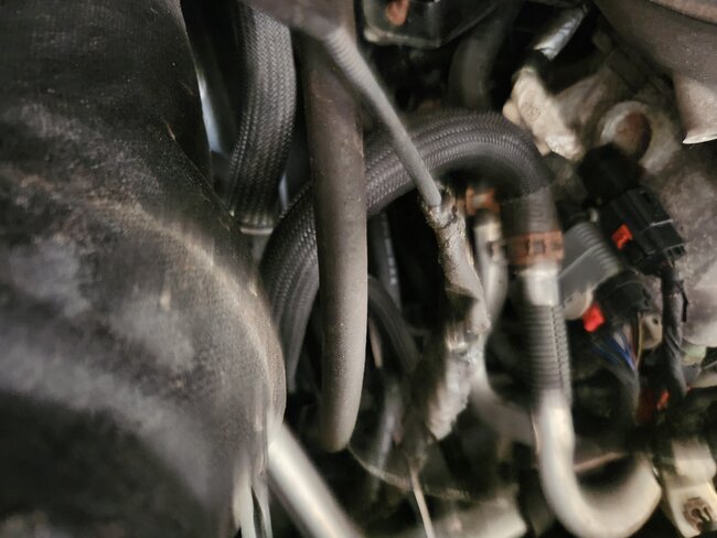

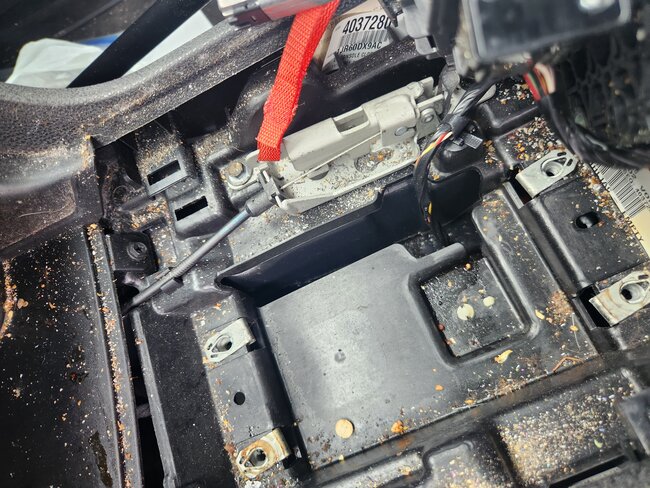

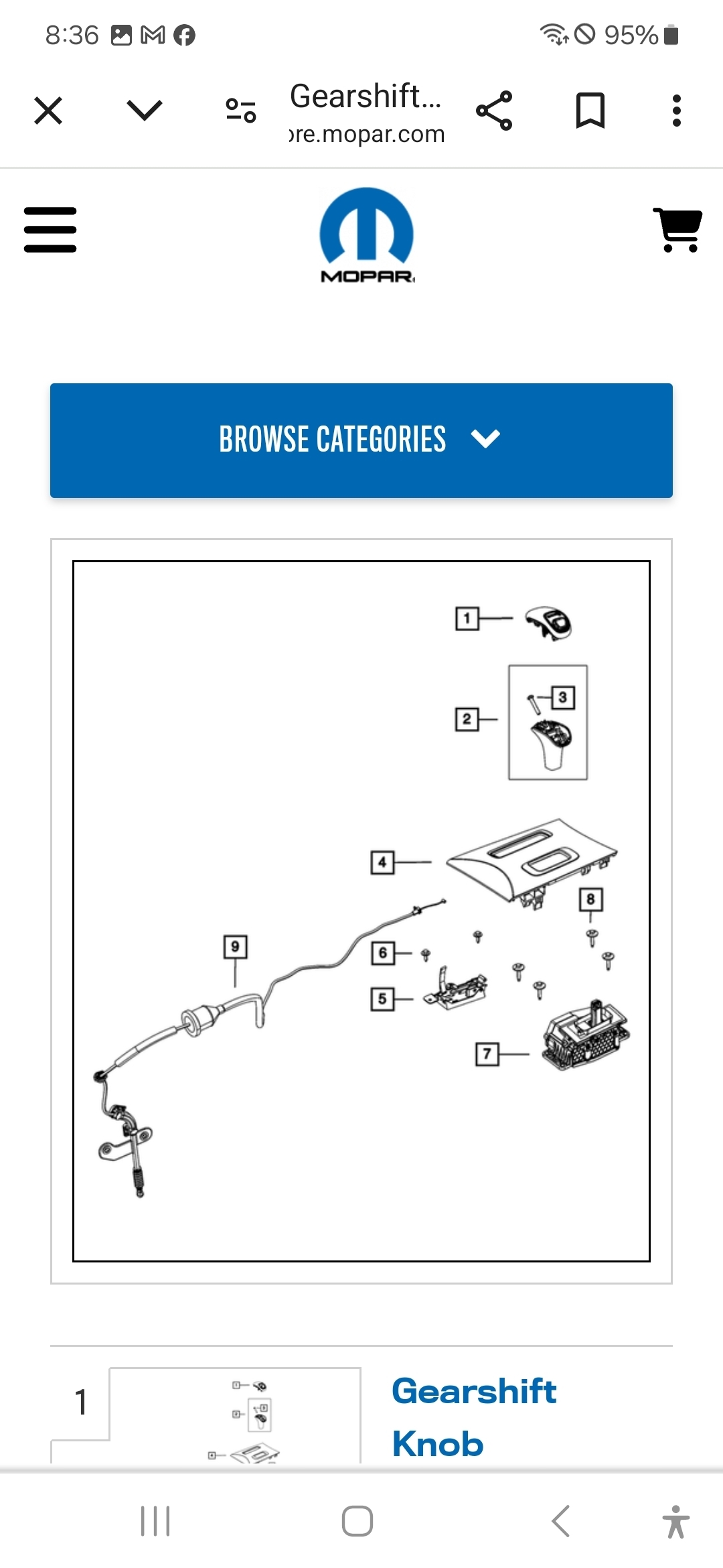

I was able to look more closely at the shifter. There's no attachment to the cable. It appears to be electronic and I'm assuming it controls a servo that actuates the cable on the transmission. The brake lights work but I don't know if this shifter block is even getting current. I'm attaching photos of the box, the lever we previously spoke about and the linkage on the transmission as well as the cable. Where the cable originates is somewhere under the dash. Where the cable attached to the lever goes or what it does is anybody's guess. As you can see in the photos the shifter is stuck in the middle of the range of travel. I also tried pushing up on the linkage where the cable connects and was met with sprung resistance. The last picture is the Fusebox. There's a spot for a transmission relay but there are no pins there or a relay. The transmission shifter fuse is good.
May 27, 2024 at 3:34 PM
  • 110,194 POSTS

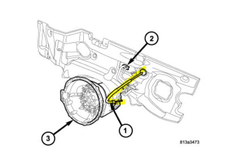

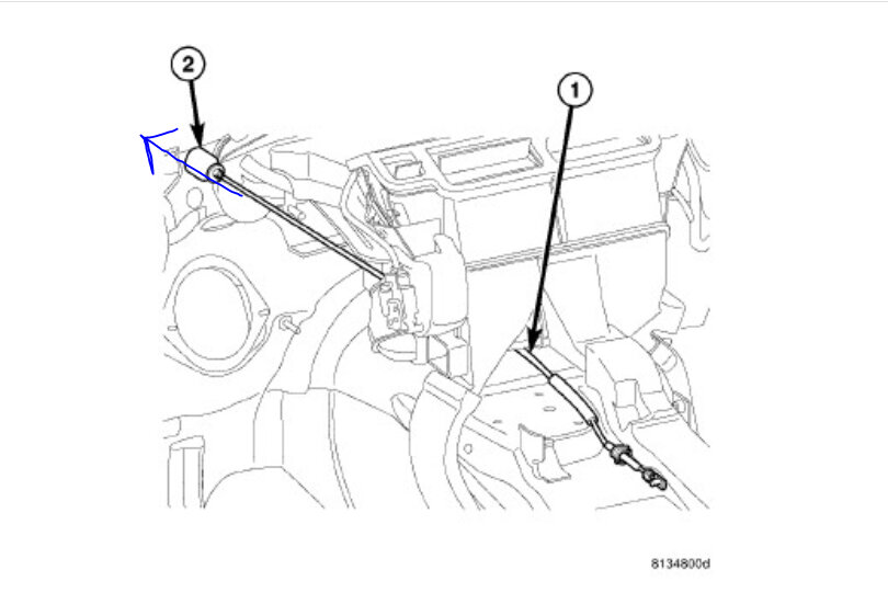

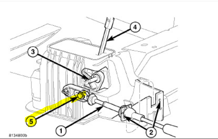

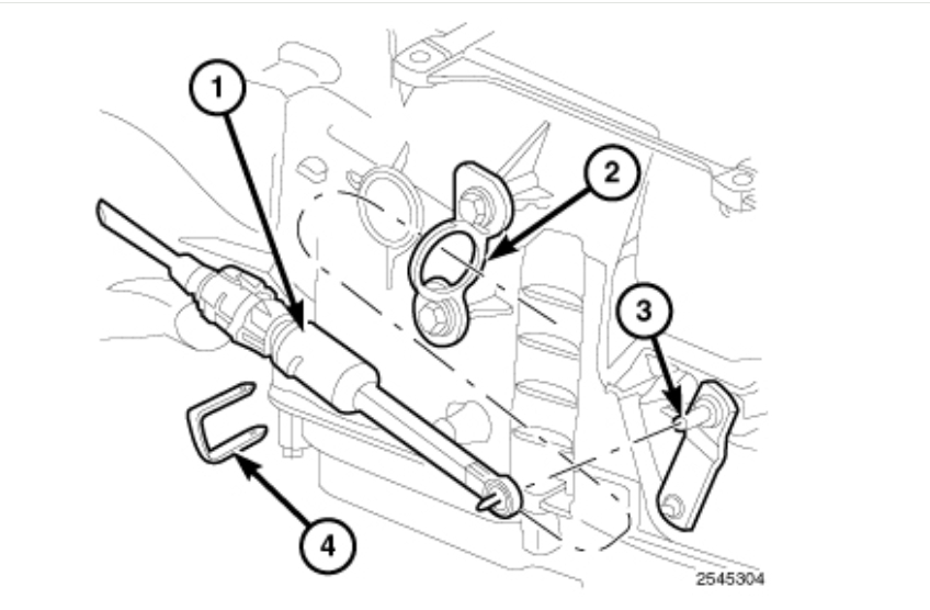

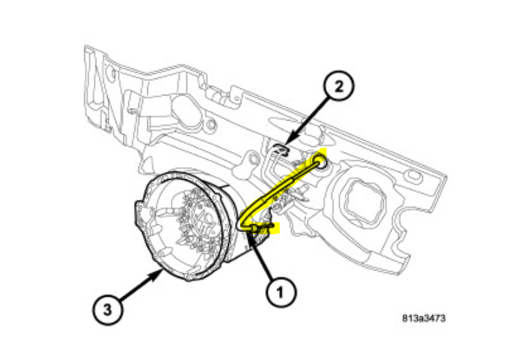

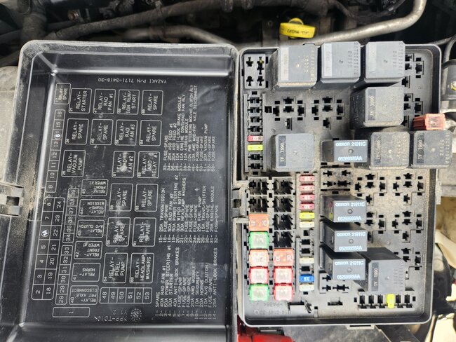

There is an adjustment on the cable where it attaches to the shifter. See pic 1. Pic 2 shows the cable runs under the dash and comes out under the hood. Then it attaches to the transmission shift lever. See pic 3
Let me know. The relay spot is unused.
See pics below. Note: My information is based on a floor shifter.

Here's some photos of the system and parts. The cable doesn't attach to the shifter control which is baffling. The only cable is attached to the park release.
May 27, 2024 at 6:43 PM
  • 110,194 POSTS
I checked 2011 and 2013 to see if it may have been a midyear change. Both additional years vehicles are the same as the 2012.
So, to confirm what you are saying, if you open the hood, there is no cable coming from the firewall to the transmission as seen in the pic below.
See pic below

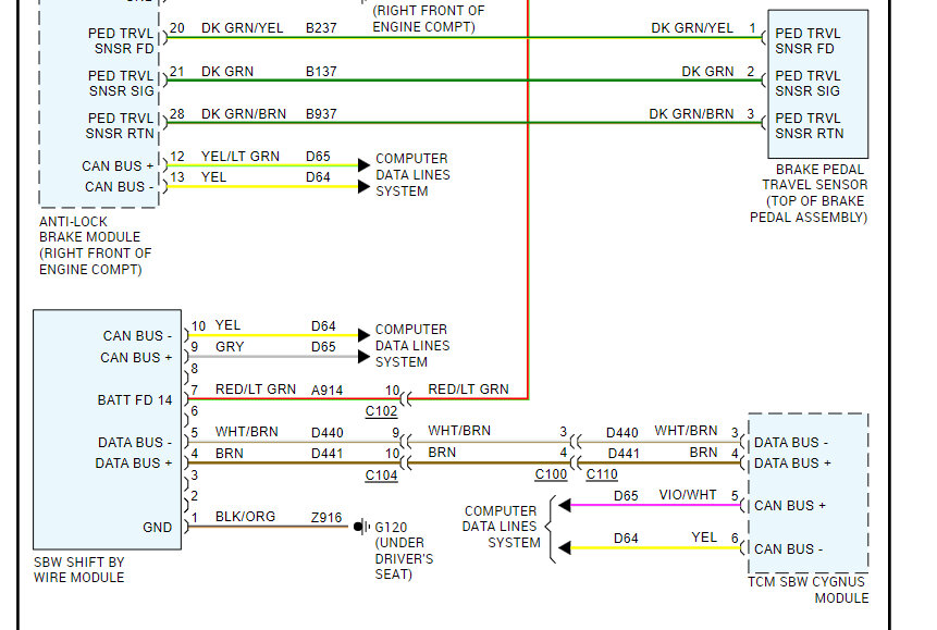

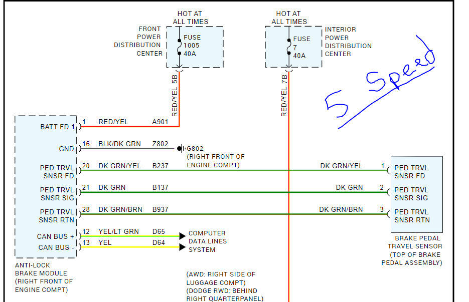

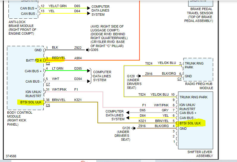

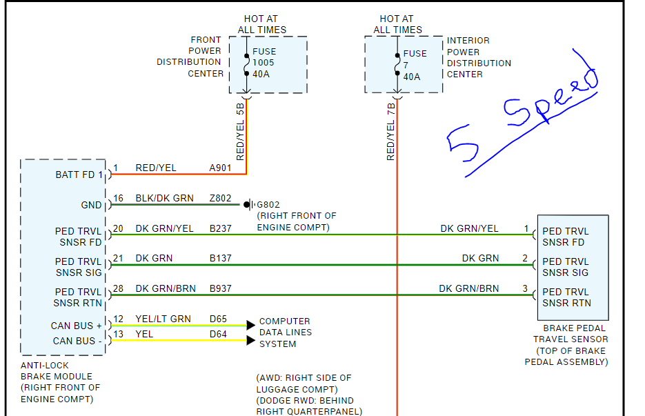

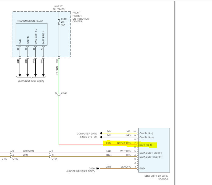

  • 110,194 POSTS

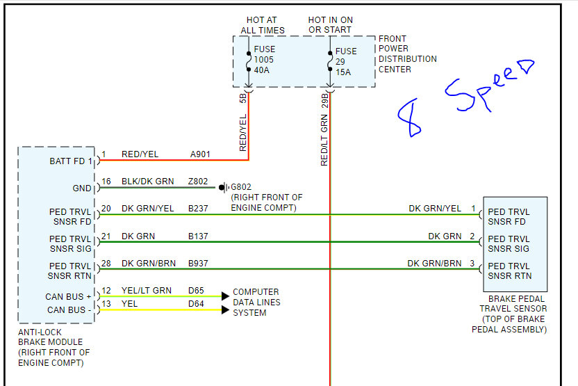

There are two different transmissions that are possible. One is a 5-speed, and the other is an 8-speed.
I attached wiring schematics below. If you have the 8-speed, it has a shift by wire design (SBW) that I have a feeling you have. If that is the case, we need to scan the can-bus system to determine the cause of the issue. In this design, different modules communicate back and forth via the CAN (controller area network).
Here is a link that explains how it's done:
With the 5-speed trans, you can check the actuator for power via the brown wire with a yellow tracer at the shifter assembly. You should have battery voltage.
I attached the wiring schematics for both designs below. Note there are no identified actuators for the 8-speed. Instead, it is done via the can-bus SBW. The first two pics are the 5-speed and the last two are the 8-speed. I had to cut the page in half to make it readable for you, but I did overlap them so you can follow from one to the next.
Let me know if this helps.

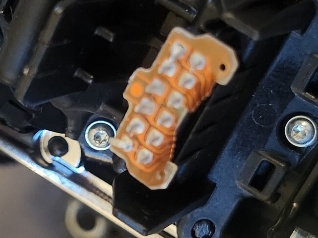

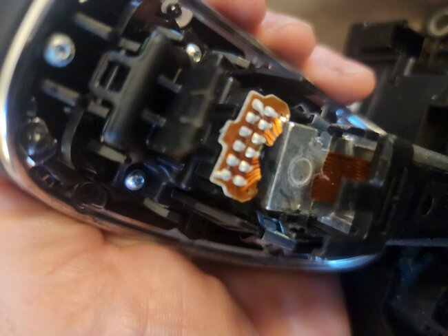

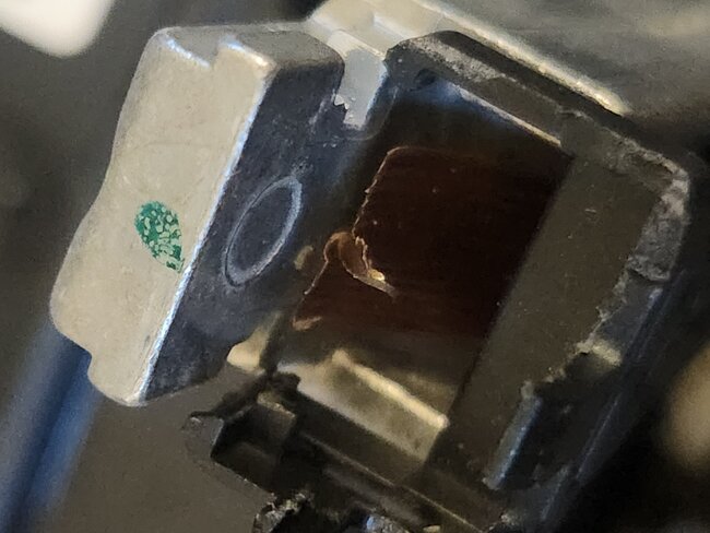

Well, there was no connector inside the driver's kick panel, but the photos will show a definite problem. There's no continuity in the electrical connection to the shifter knob. I'm not sure if this tore when I pulled the knob off or before. Either way it didn't work before. The problem is the cover plate can't go over the shifter with the knob on. Videos show removal of the knob without damaging this ribbon. Any ideas?
Jun 9, 2024 at 6:26 PM
  • 110,194 POSTS
Wow, that doesn't look good. I don't feel that it is repairable and will need to be replaced. Have you tried finding one yet?

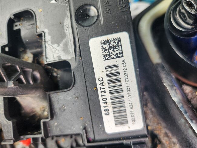

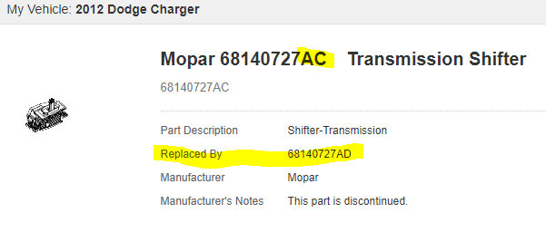

Yes, but there seems to be 2 part numbers. The only difference is the last letter. One ends in AC and I believe the other ends in AD # 68140727AC is the number of the one in the car. Is there a difference in the two parts? Also, which wire supplies power to this shifter?
Jun 11, 2024 at 6:57 AM
  • 110,194 POSTS
I attached a pic below of the wiring to the shift module. I highlighted the only fused power supply. Other connectors are part of the CAN.
The part numbers are for the same part. The one ending with AD is the replacement part number. See pic 2 below.
Let me know if that helps.
