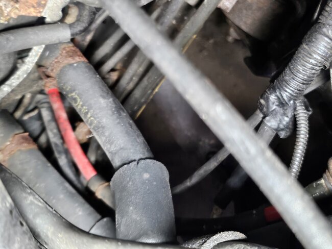

I have replaced the clutch slave, master cylinder, clutch plate, and cover plus release bearing. There is a slight leak that I'm ordering the hose for today in the hydraulic line shifter cables appear to be fine also the pedal has little resistance I've adjusted the pedal to no avail. Is there anything else I should be looking for besides replacing the hydraulic hose?

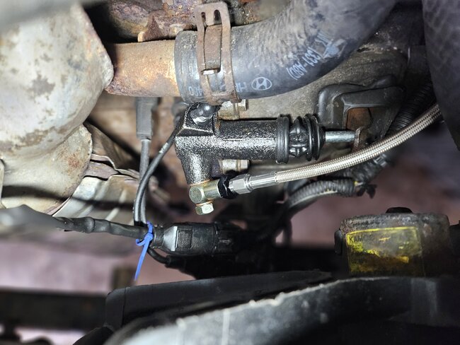

If you remove the slave cylinder, does it move when the clutch is pressed?
See pic below.
Jan 31, 2024 at 10:29 AM

I put in a new hydraulic line last night. There are no leaks, the master cylinder and the slave are new and I also installed a new clutch kit.

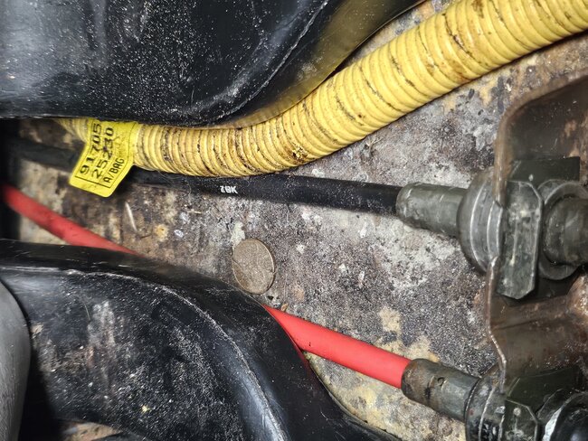

Also, noticed last night after replacing the line that when I tried to go into gear it feels like the shifter is off, so I'm assuming that would have to do with the shifter cables but not sure exactly what to do with that. I'm checking them today to see if there's any kind of break in the line or visual imperfections.

I do recall the bushing looking worn where it attaches to on the linkage, I don't know how big a deal that is but wanted to mention it.

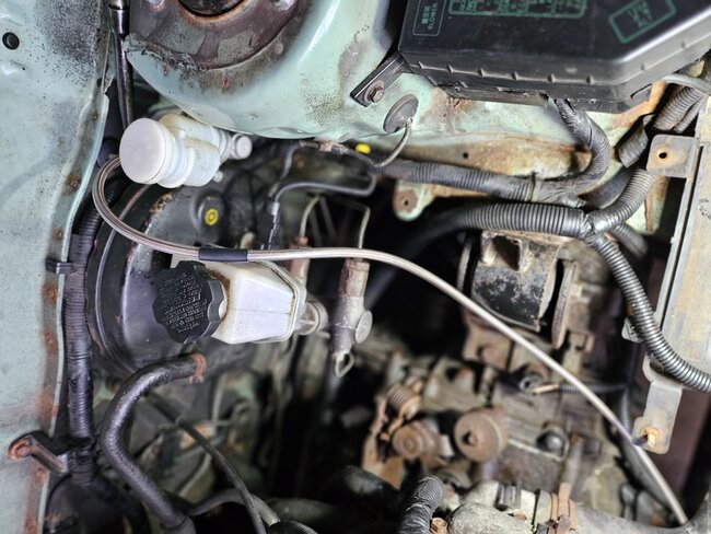

Here's the slave cylinder and then the linkage is on the second one.
Feb 1, 2024 at 5:09 AM
  • 110,248 POSTS
It appears to be doing its job. Try this. With the engine off, place the engine in gear with the clutch released and see if you can move the vehicle manually. If not, try the same thing with the clutch depressed to see if it is releasing.
If it is releasing, it could be a shift linkage issue. Have a helper shift through the gears while you watch to see if the linkage cables at the transmission are working correctly. There should be two cables on this vehicle.

I've looked at the cables the one bushing is a little worn but I wouldn't think enough to cause any harm there's no breaks and they seem to be pushing and pulling okay I mean just by hand I don't really know enough about it to say 100% that's the truth just seems so.
Feb 3, 2024 at 2:30 AM

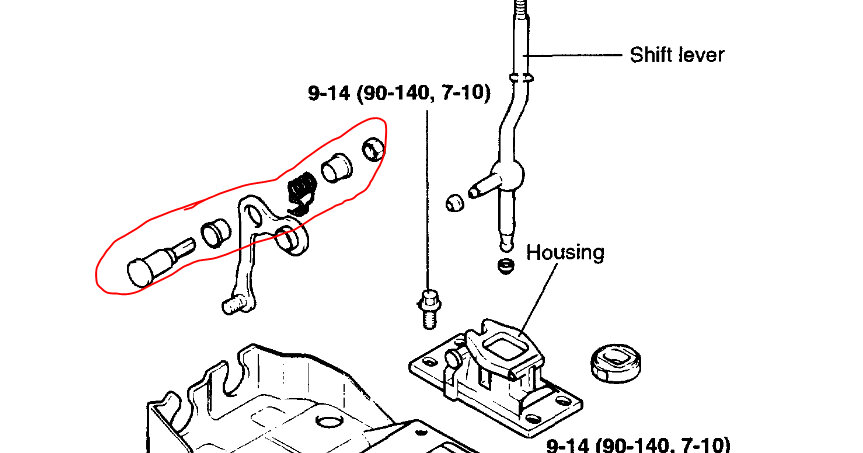

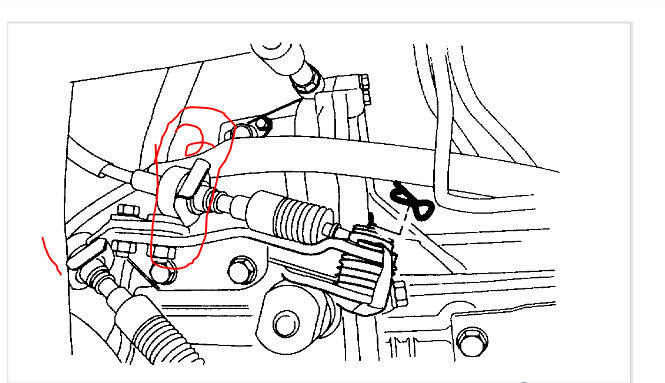

  • 110,248 POSTS

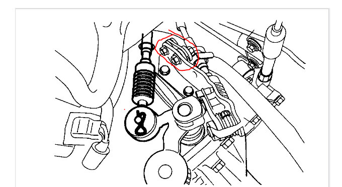

It sounds like there is a shift cable issue. If you have the shifter exposed in the vehicle, check to make sure the cables are attached to the retainers and there isn't a linkage issue there. See pic below.
See pic below.

I found a broken bolt in the linkage under the hood. repairing it now to see if that slipping may have been the issue.

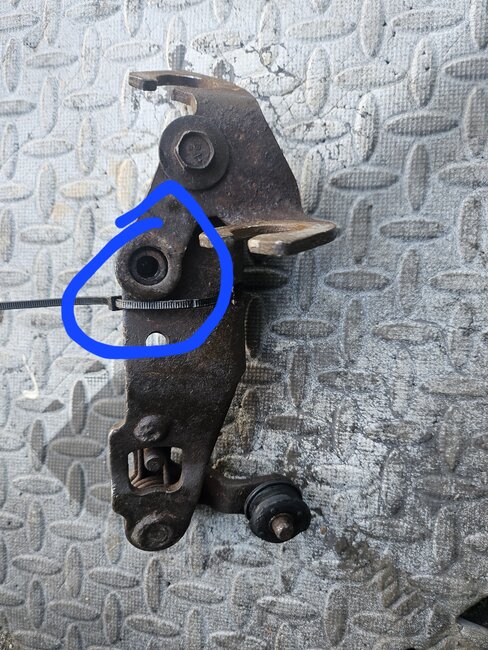

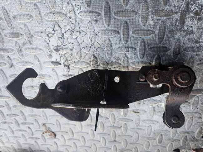

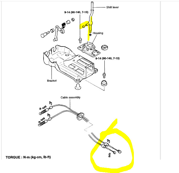

Can you tell me if this gets a bolt in it? I don't know if one's missing from it or what but it appears so the other side however has a fixed nut and what looks like the tip of what used to be a bolt but I am not sure.
Feb 6, 2024 at 10:44 PM
ANN SENN
  • 49 POSTS
Other side.
Feb 6, 2024 at 10:45 PM
  • 110,248 POSTS

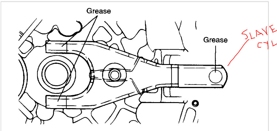

I attached three pics below. The last pic I numbered. Number two, I believe, is where we are looking on your part.
Also, it appears a bolt broke. In your second picture, which is a welded nut to the part and you can still see the threads from the original bolt still there.
Let me know if this helps. Looking at the manual and then your pics, the orientation is different, so I had to spin the laptop in circles a few times to make sense of it. LOL

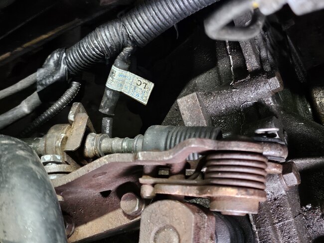

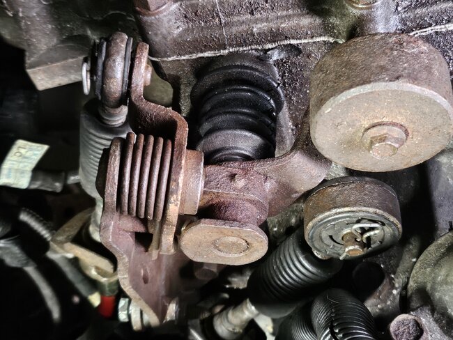

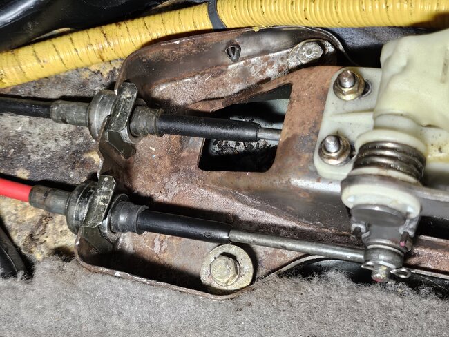

So sorry for the delay, I was sick as a dog but here are the pictures.
Feb 10, 2024 at 6:03 AM
  • 110,248 POSTS
Sorry to hear you've been sick.
Everything looks good in the pics. When you try shifting, can you see movement in the cables at the transmission?

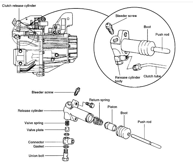

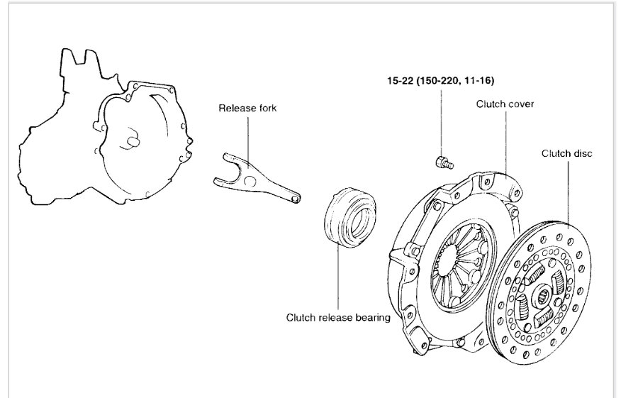

I went back and watched the slave cylinder operate. It appears to work correctly. Even if the transmission was internally locked, when you press the clutch, it should disengage and allow you to shift.
Take a look at the two pics below. When the clutch was replaced, did you inspect the clutch release fork? Is it reaching the release bearing to disengage the clutch? Something in there isn't doing what it is designed to do.
