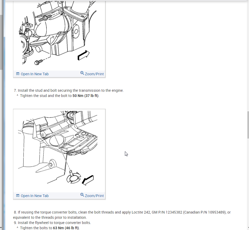

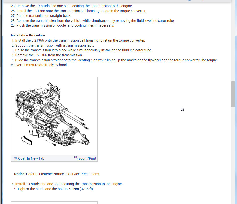

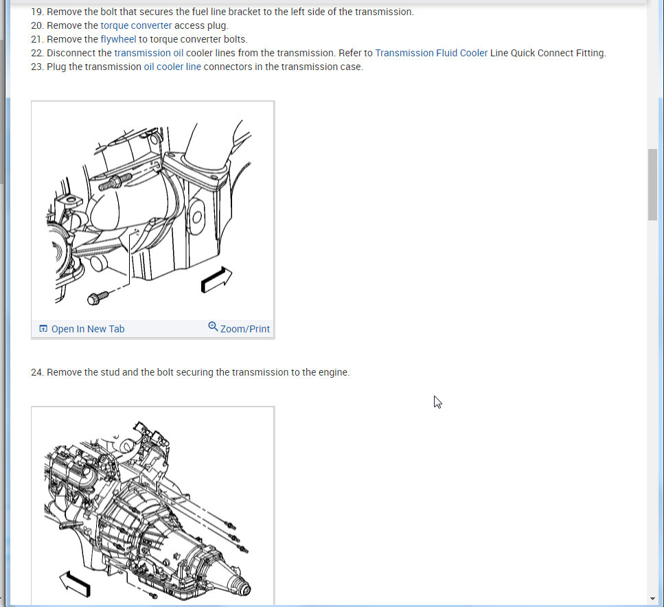

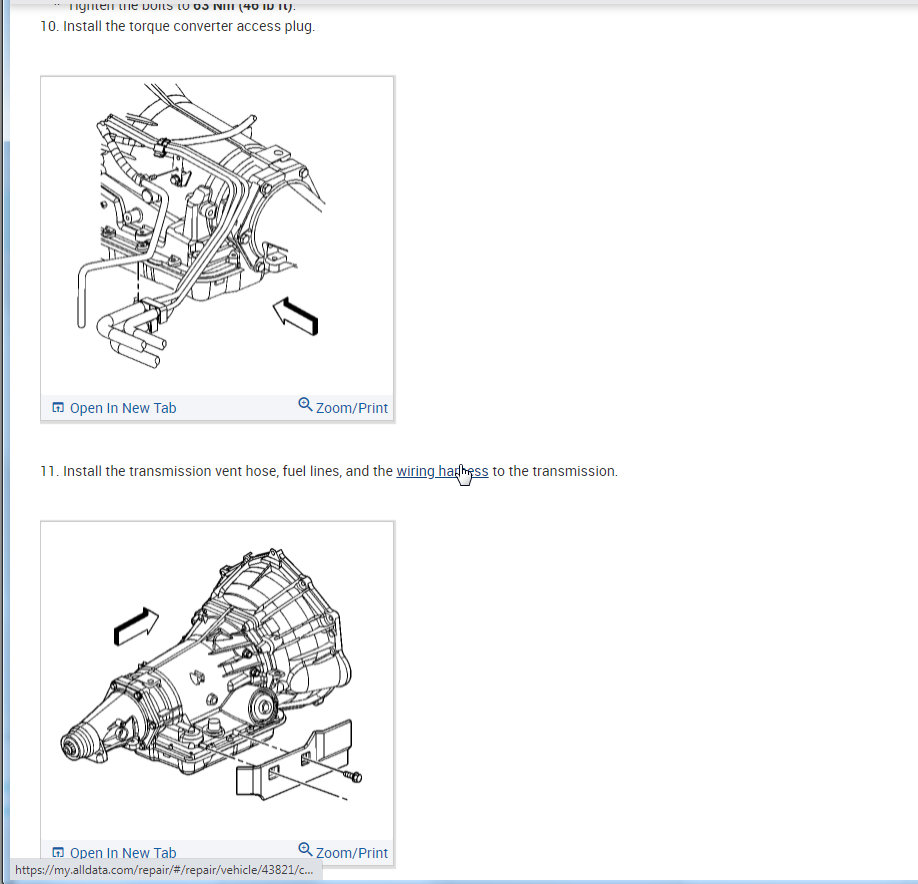

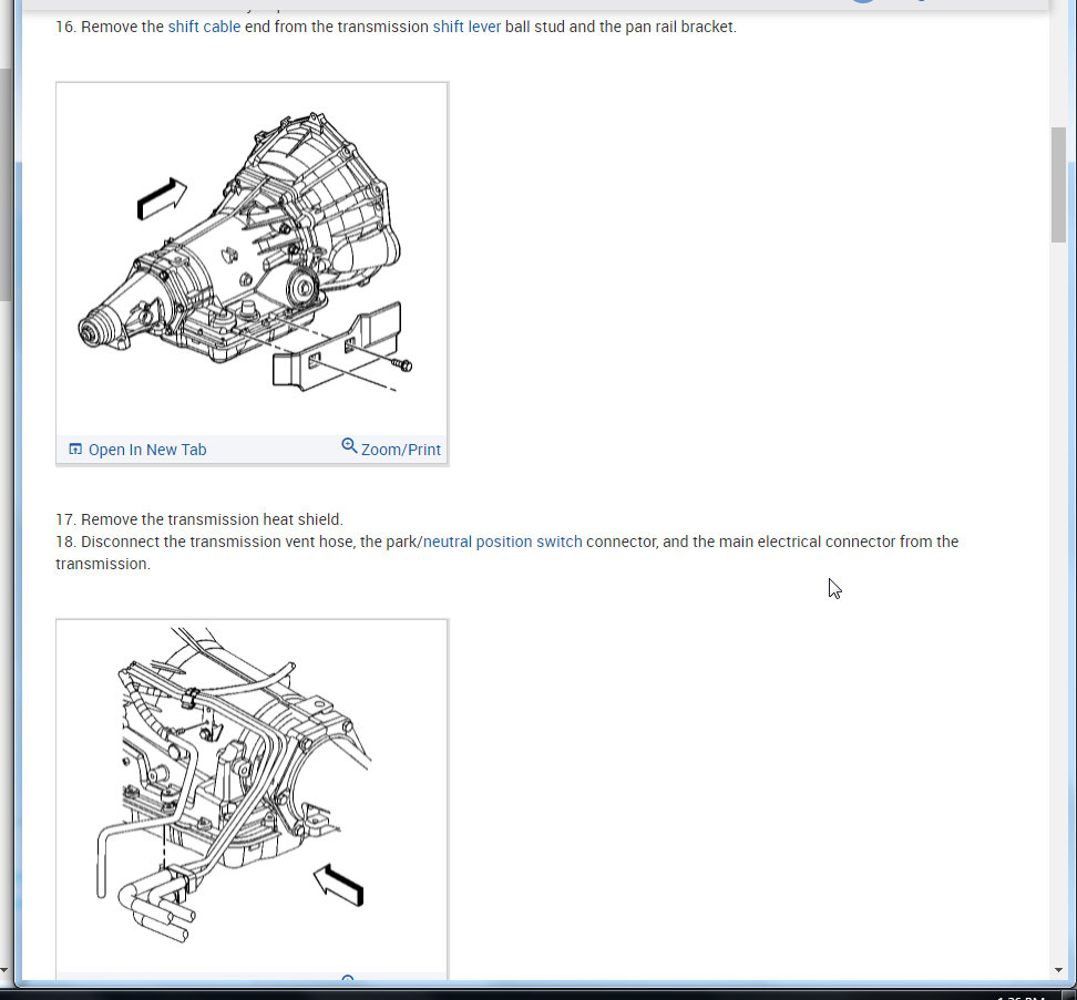

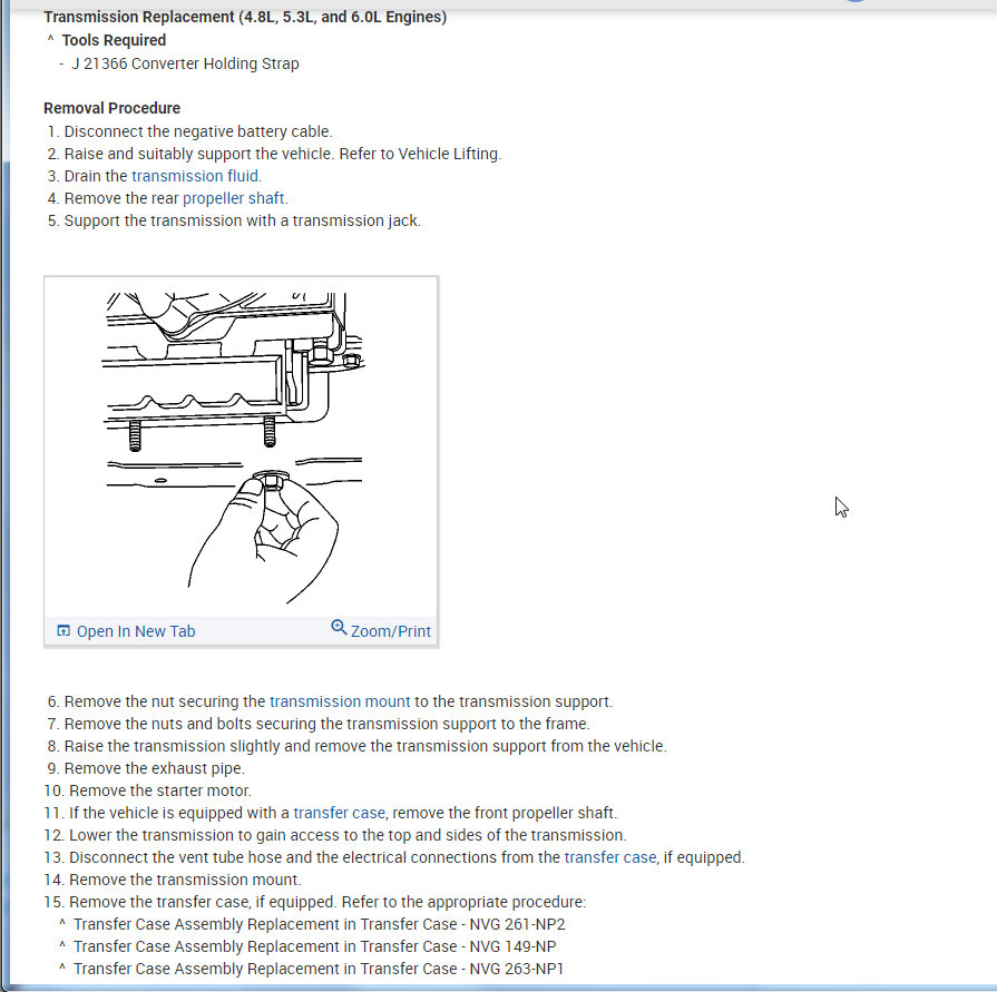

So randomly my transmission decided that after going into third on the way to fourth it just wanted to slip gear and do nothing, figured blew transmission so i need to replaced it with new one. I'd appreciate any help, thanks.
Sep 12, 2019 at 9:10 PM

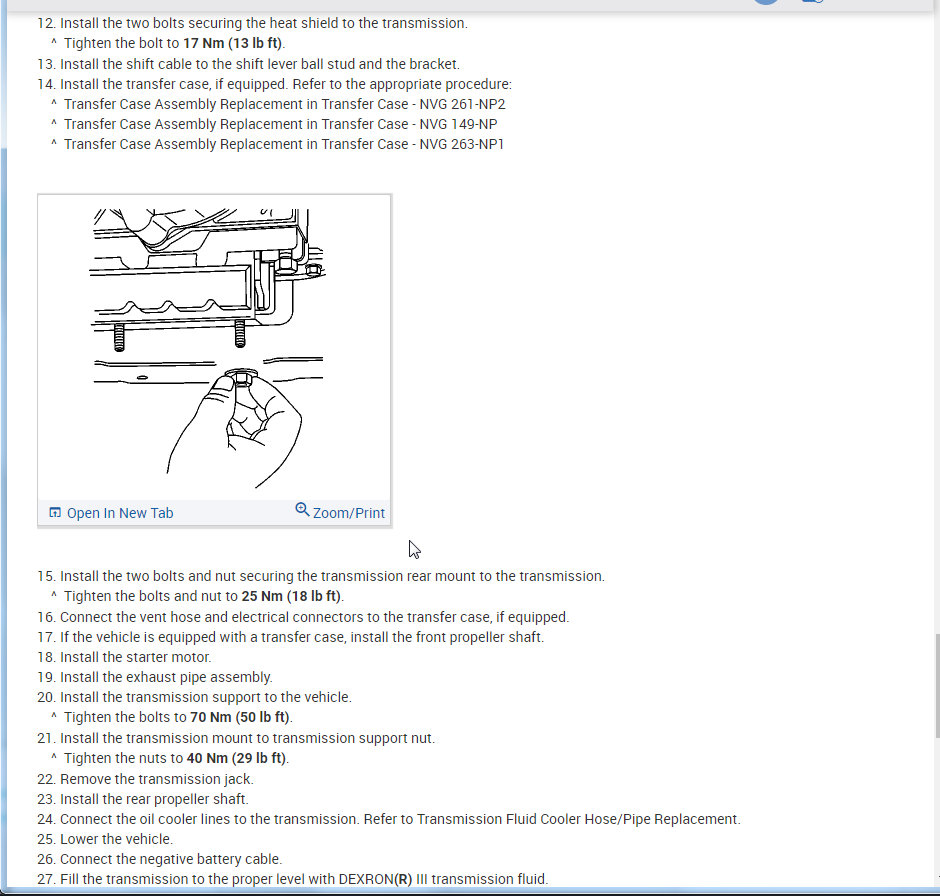

It does sound like you need to new unit. Here is a guide that will help with this:
https://www.youtube.com/watch?v=3vJAojsrfuU
Below is the process from the manual on how to replace the unit.
Please run through this material and let us know if you have other questions. Thanks
