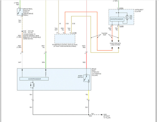

My vehicle listed above will not come out of park.
Mar 10, 2022 at 2:58 PM
  • 110,194 POSTS

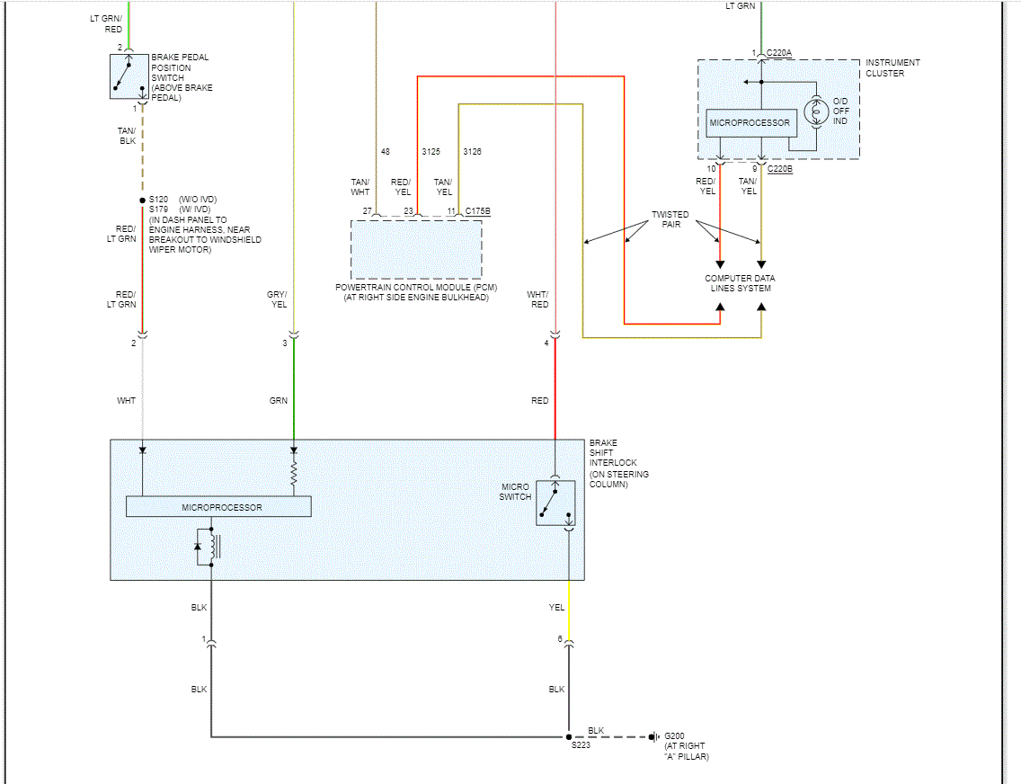

I have a question. Are the brake lights working? I ask because the shift interlock is actuated via power from the brake light switch. Check that first.

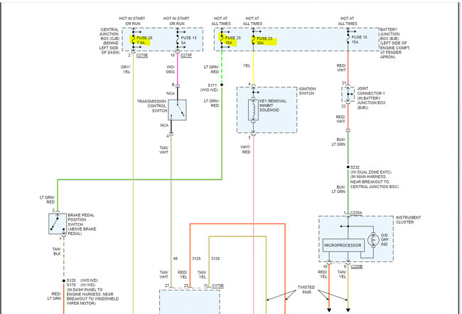

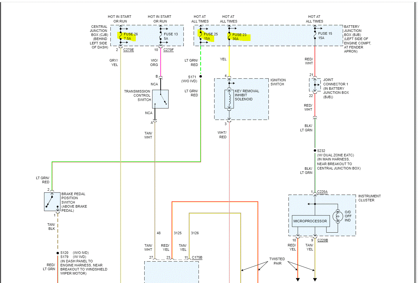

Next, I attached the wiring schematic below. Confirm the fuses I highlighted as good as well. In addition to checking the fuses, make sure they have power to and from them.
Here is a link you may find helpful.

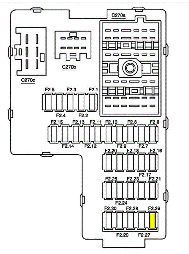

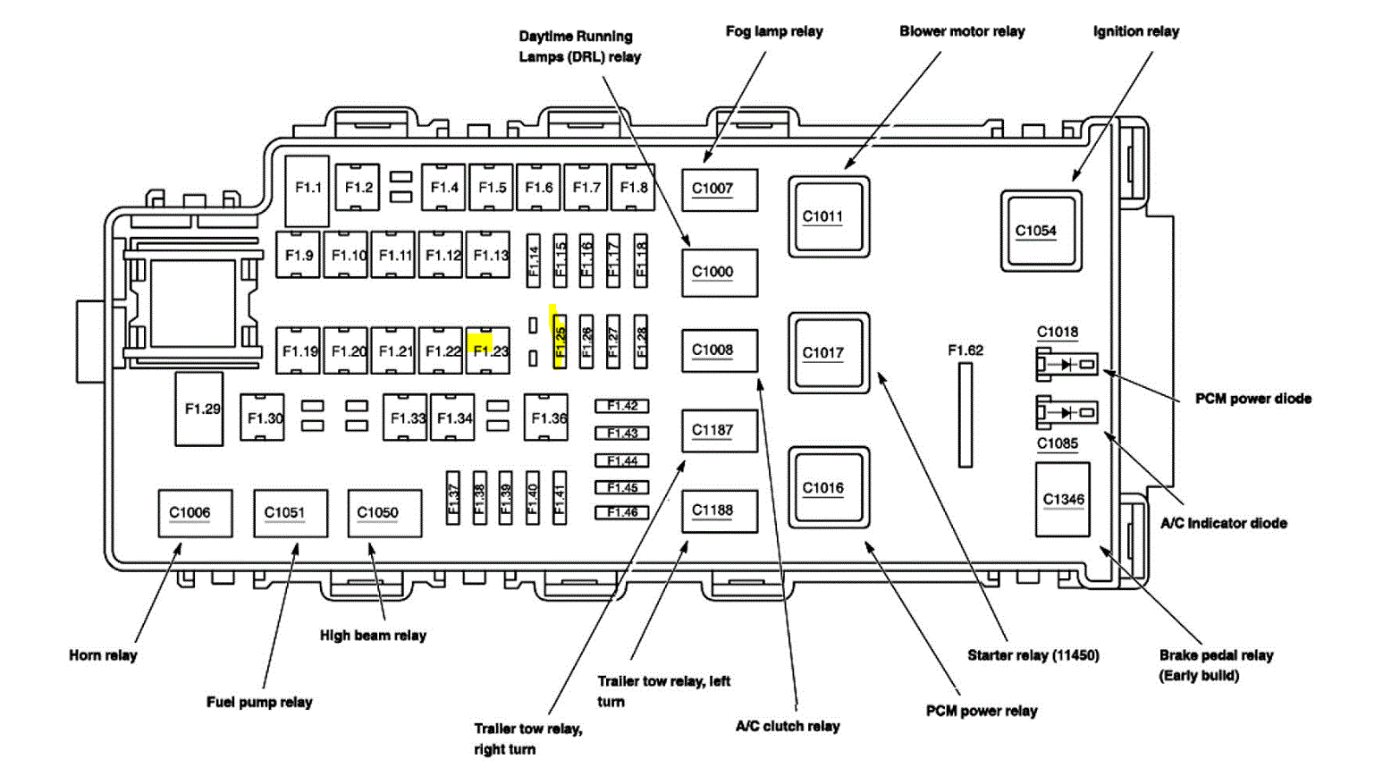

I attached the wiring schematic below for your reference. Also, the last two pics show the fuse boxes, and I highlighted the fuses to check.
