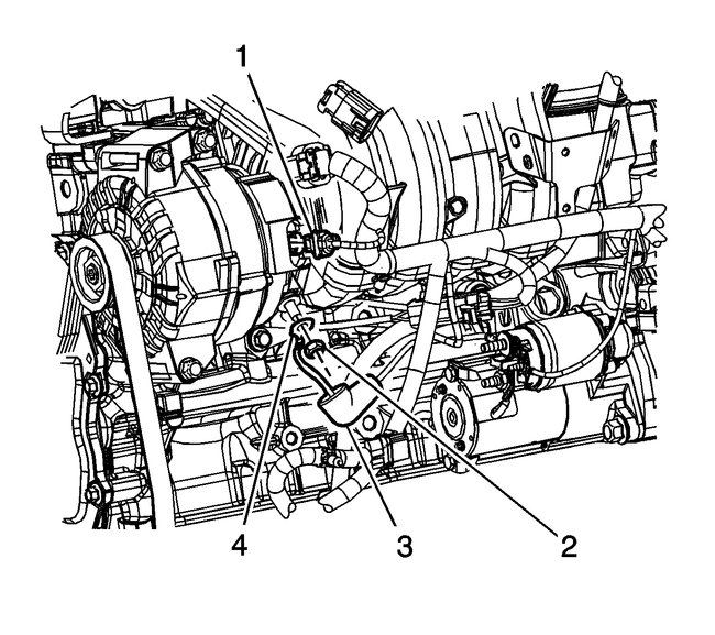

SCOTT PORTER
Throwing several different voltage codes and with it hooked to another vehicle via jumper cables all lights are out and it runs fine. Alternator?
Oct 20, 2020 at 12:34 PM
  • 110,190 POSTS
It is very possible it is related to the alternator. That makes sense. Do me a favor. Here is a link that explains how to check the alternator. All you need is a voltmeter or even a multi-meter. Do this and let me know the results.

Here are the directions specific to your vehicle. The attached pics correlate with the directions. Just make sure the battery is disconnected before you start working on it.
________________________________________
2007 Pontiac G6 L4-2.4L
Generator Replacement (LE5)
Vehicle Starting and Charging Charging System Alternator Service and Repair Removal and Replacement Generator Replacement (LE5)
GENERATOR REPLACEMENT (LE5)
Removal Procedure
pic 1
1. Disconnect negative battery cable.
2. Remove the air cleaner resonator.
3. Remove the drive belt.
4. Remove the radiator inlet hose.
5. Disconnect the generator electrical connector (1).
6. Reposition the rubber boot (3).
7. Remove the engine harness terminal lead to generator nut (2).
8. Remove the engine harness terminal (4) from the generator stud.

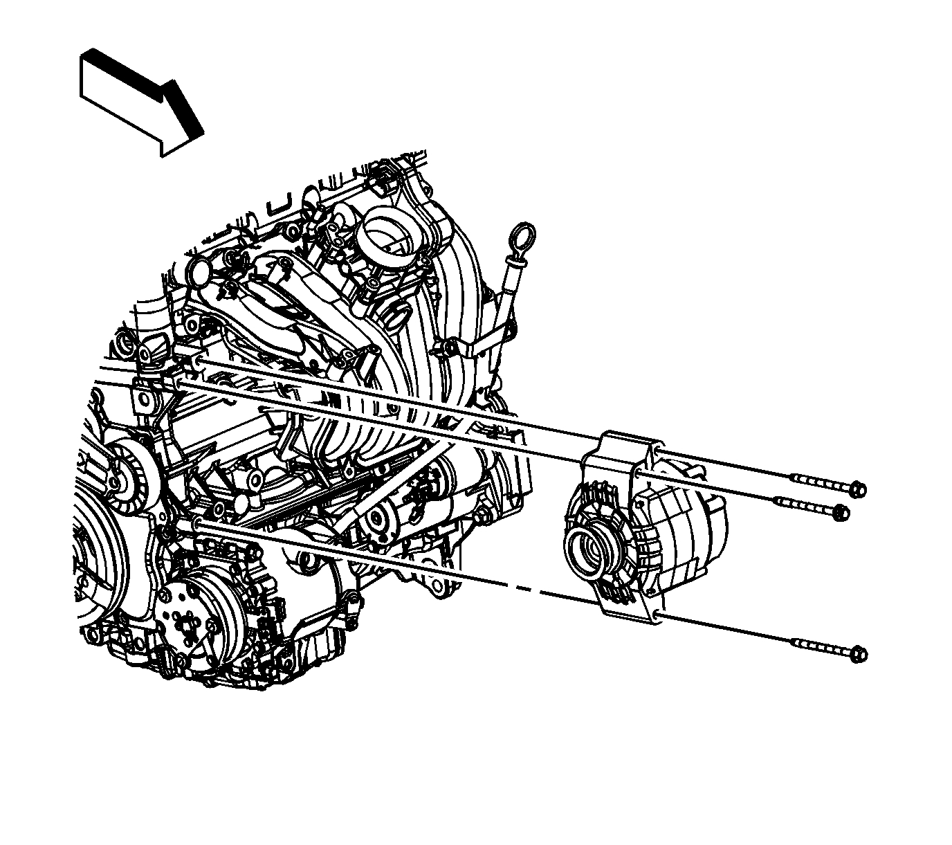

pic 2
9. Remove the generator bolts.
10. Remove the generator.
