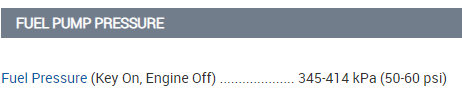

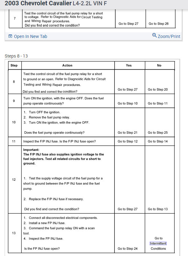

Starter burned up so I replaced. Car started and ran for two seconds, and now it won't run at all. New starter works though. It's like the fuel pump isn't turning on. What would cause this and where's the fix?

This not starting can be for lack or fuel or lack of spark.
Check to see if you are getting fuel. The ideal pressure should be 50-60 PSI with key on, engine off.

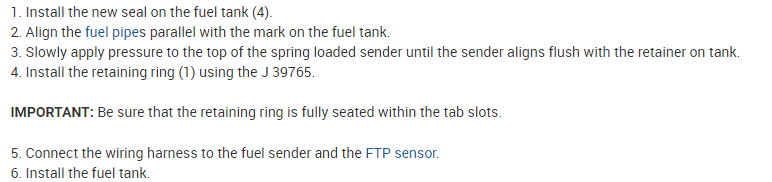

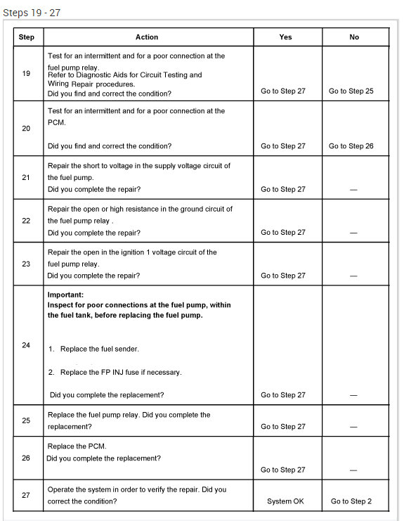

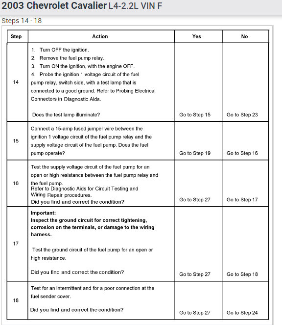

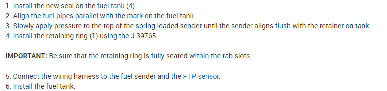

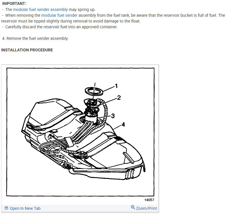

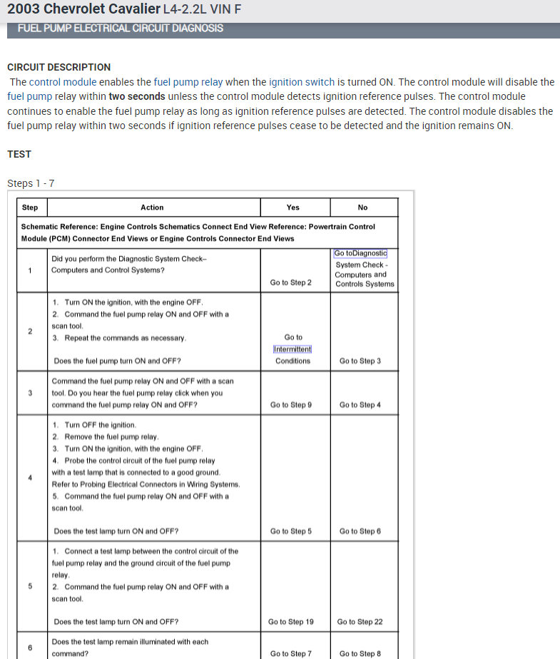

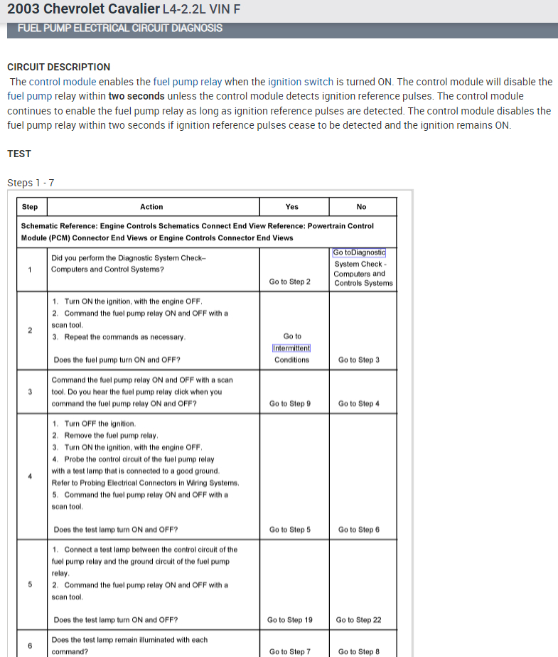

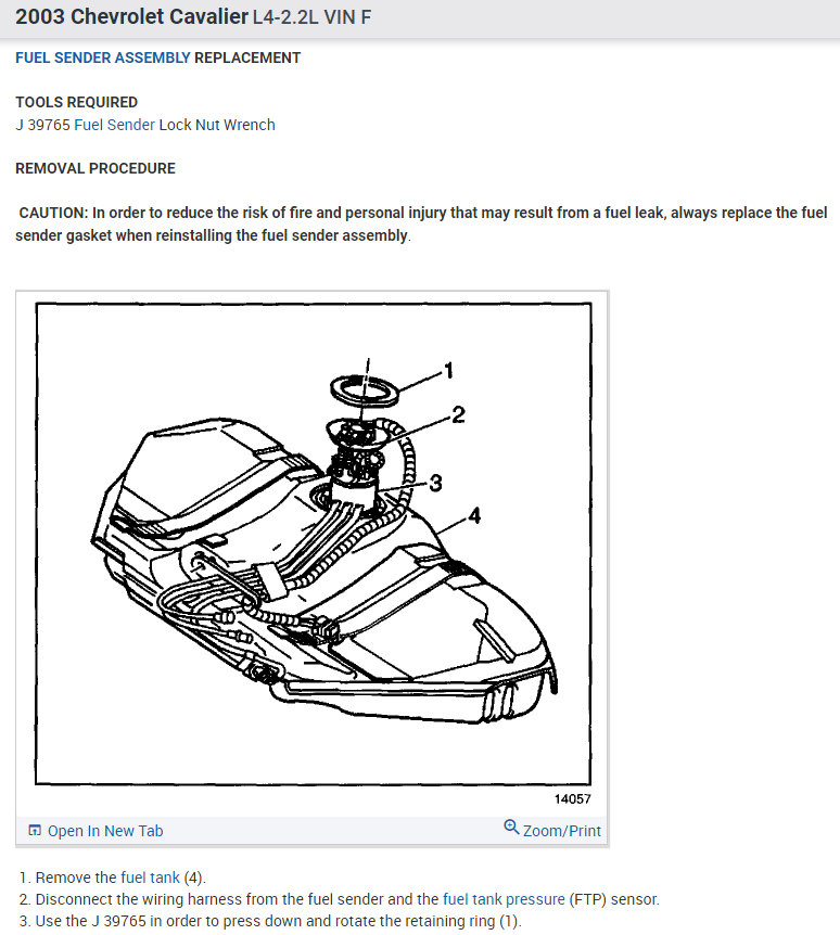

I have attached fuel system diagnosis and pump replacement procedure.
