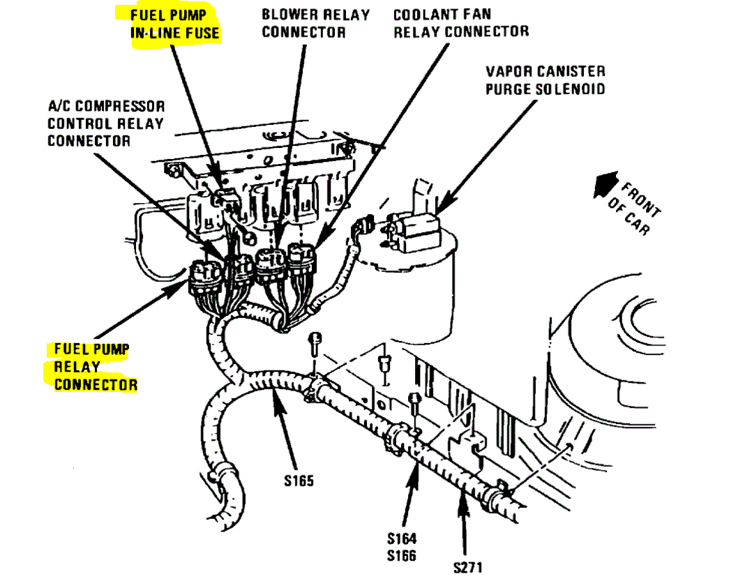

I have put a fuel pump, ICM fuel pressure regulator, a crank sensor, harmonic balancer, and coil packs. it run until warm then shuts off won't start till cool. I sprayed start fluid it runs.
Aug 14, 2021 at 12:21 PM
  • 110,248 POSTS
If it restarts and then stalls when using starting fluid, then it is fuel related.
Do me a favor, check the fuel pump relay and the fuel pump inline fuse. I realize the fuse has to be good for it to work at all. However, if it is loose or corroded, it could lose connection. Also, if you haven't checked the relay, check that. The Fuel Pump Relay is located in the right hand front of the engine compartment, on the relay bracket. See pic below

The fuel pressure is perfect. However, if it starts with starting fluid, then it is fuel-related. If you haven't already, check the relay to make sure that isn't the problem.
If it checks good, then I need you to check for an injection pulse when the engine won't start. If the pressure is good, something is preventing the fuel from getting into the engine.
