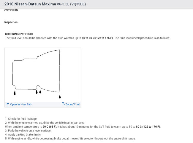

After shifting the transmission into driver and pressing on the accelerator the engine revs, but the car does not move?
2010 NISSAN MAXIMA
100,000 MILES • 2WD • AUTOMATIC
SHERAHJESSIE JOHNSTON

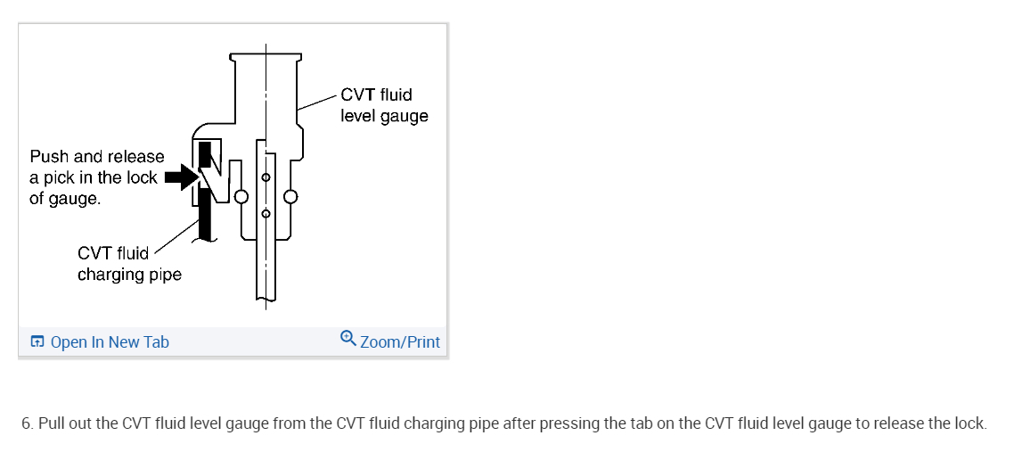

When I start the car and put it in drive, I can push the accelerator all the way to the floor, and it won't rev up and won't go anywhere.
May 30, 2023 at 3:09 AM
  • 55,121 POSTS

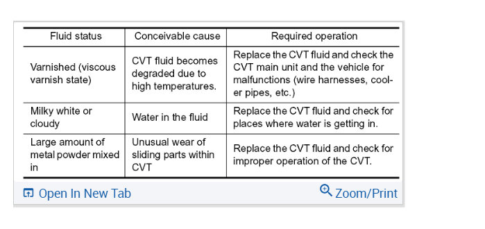

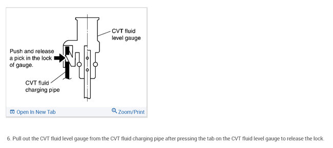

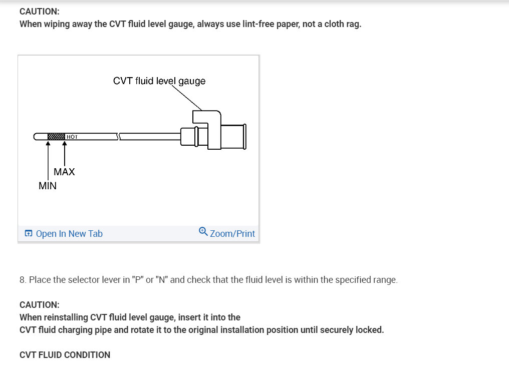

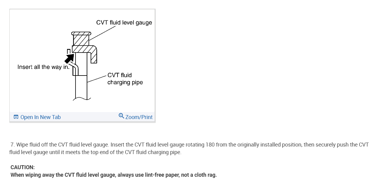

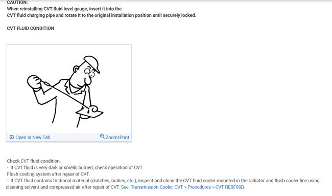

You may have a broken CV axle, or the transmission is bad but i would check the level and condition of the fluid and then run the codes to see what comes up.
You can get a CAN scanner (Controller Area Network) which will work on most cars from Amazon.
here is a video to show you how:
https://youtu.be/u-4syLc-ifQ
and
Here is one for about $99.00 if you need it:
https://amzn.to/3ZixY4v
Here is how to check the fluid and a guide as well:
