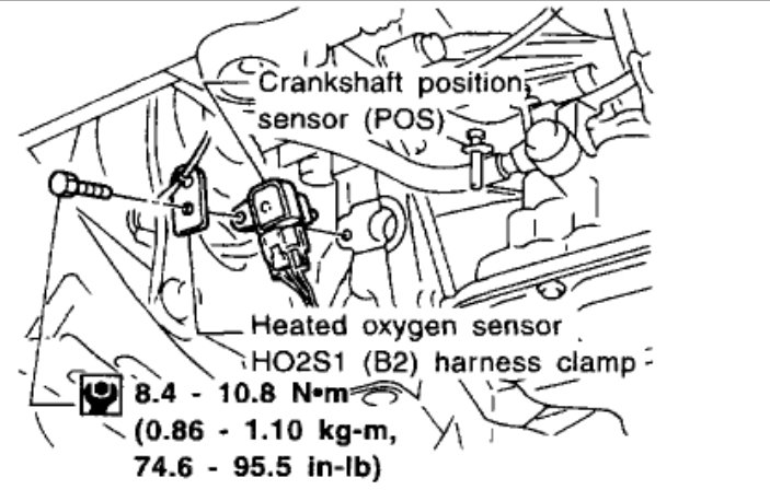

Will not rev pass 3,000 rpm's
276,000 MILES • V6 • TURBO • 2WD • AUTOMATIC
CDUREL
Replaced:
MAF.
TPS.
Ignition coils and plugs.
Car still will not go above 3,000 rpm's. Have cleaned out the throttle bottle and IACV. Code still reads P1320 and P0505. Which is the coils and IACV.
May 5, 2018 at 4:43 AM
  • 55,748 POSTS

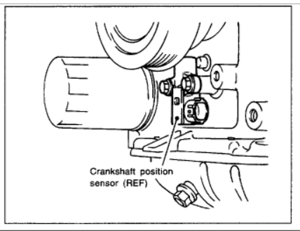

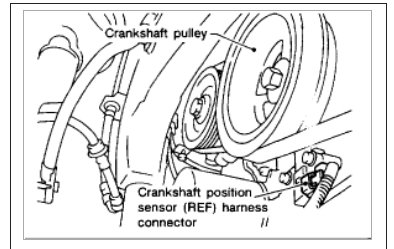

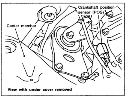

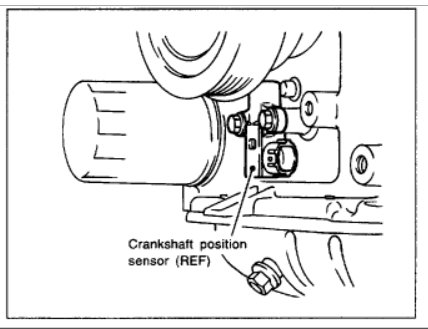

This sounds like the crankshaft angle sensor is having a problem. Here is a guide to show you what you are in for when doing the job.
Here is the location on your car.
May 8, 2018 at 5:06 AM
