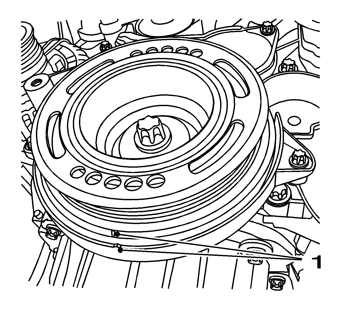

The engine ran hot. We shaved the cylinder heads. Now it starts but does not rev out completely. What is the problem?

6. Set crankshaft balancer in direction of engine rotation to cylinder 1 TDC of combustion stroke (1).

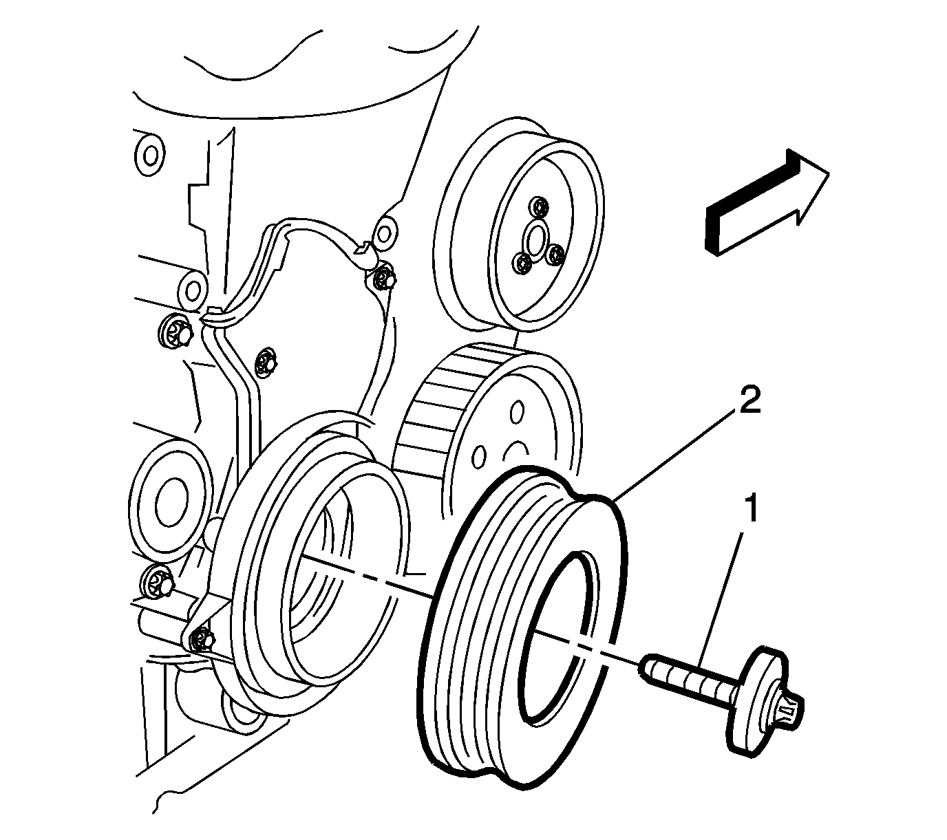

7. Remove the crankshaft balancer bolt (1).
8. Remove the crankshaft balancer (2). Refer to Crankshaft Balancer Replacement See: Harmonic Balancer - Crankshaft Pulley > Removal and Replacement > Crankshaft Balancer Replacement.

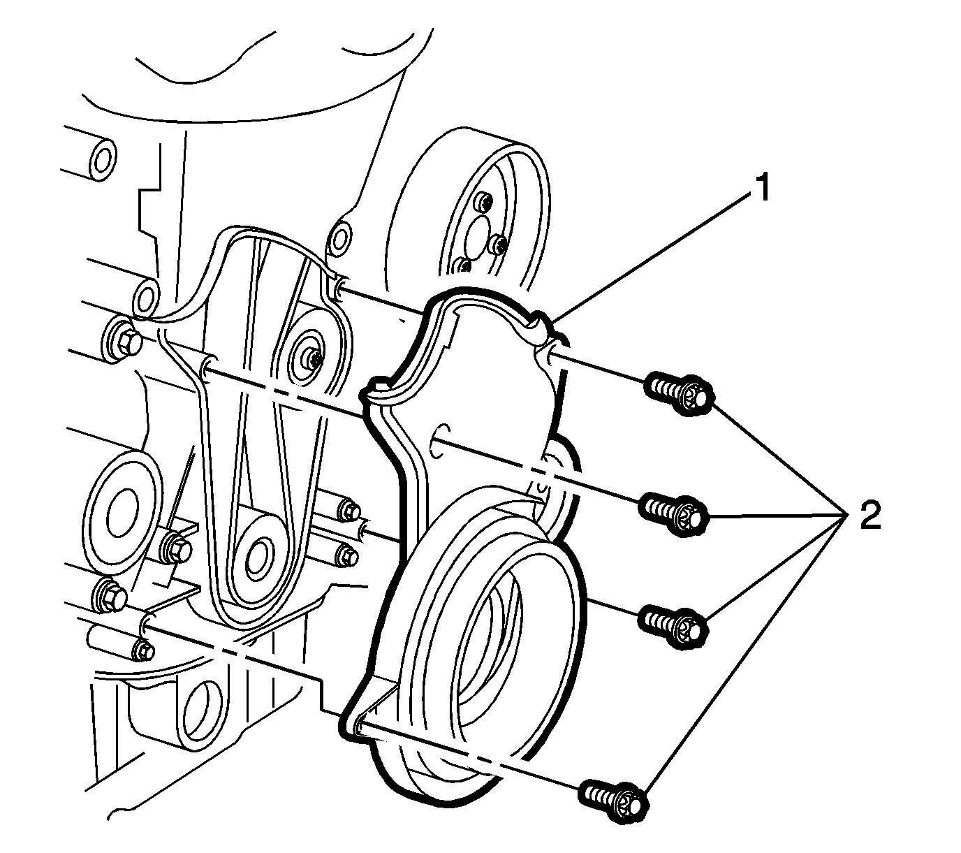

9. Remove the 4 lower timing belt cover bolts (2).
10. Remove the lower timing belt cover (1).

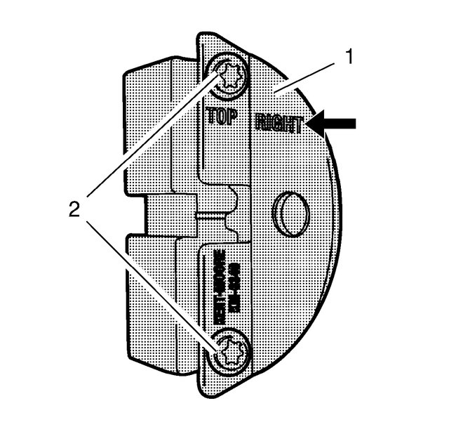

The right half of the EN-6340 - locking tool can be recognized by the lettering "right", arrow, on the tool.

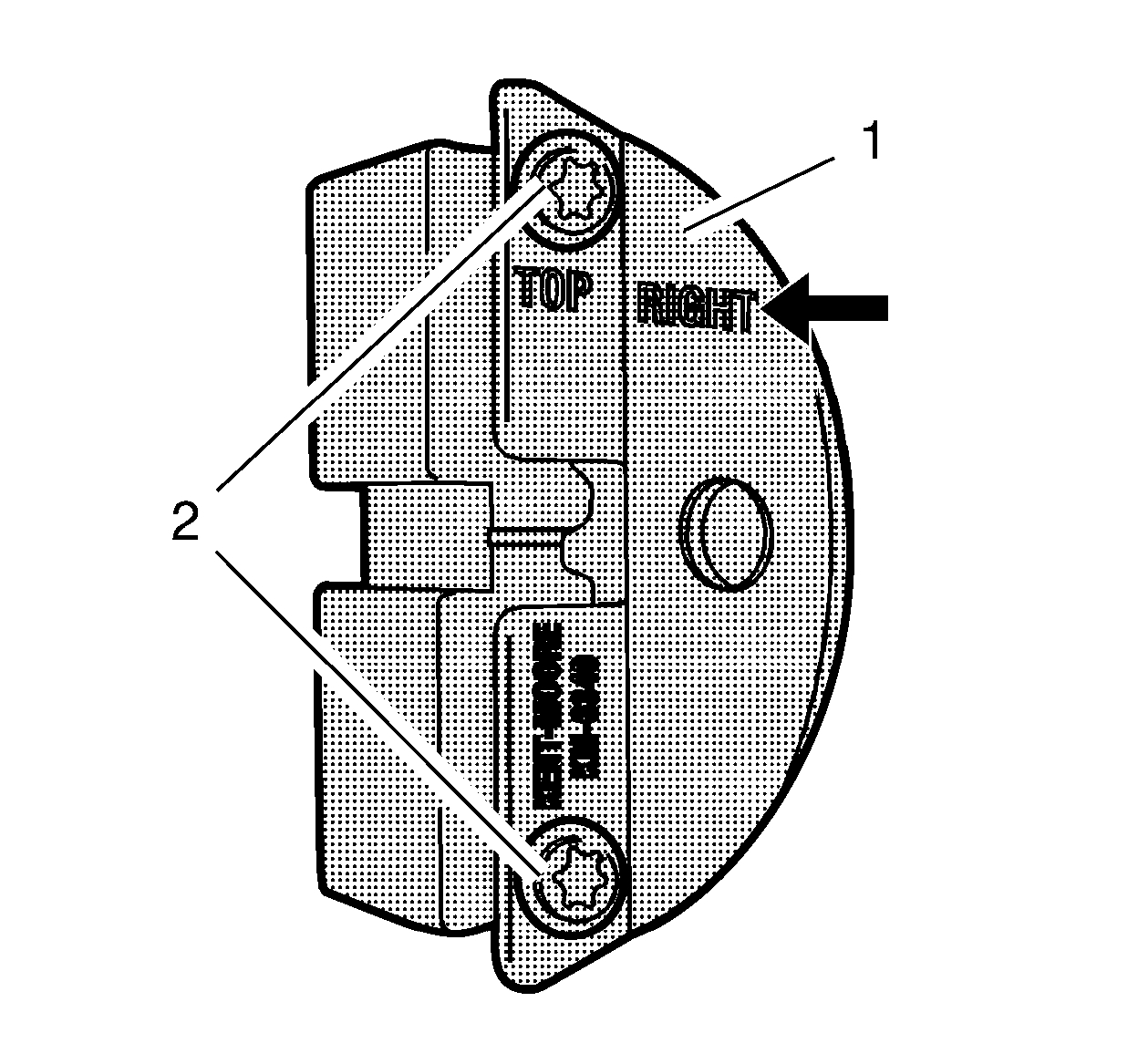

11. Prepare the right half of the EN-6340 - locking tool.
1. Remove the 2 bolts (2).
2. Remove the front panel (1) from the EN-6340-right - locking tool.

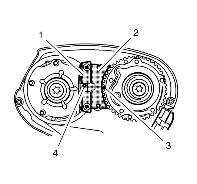

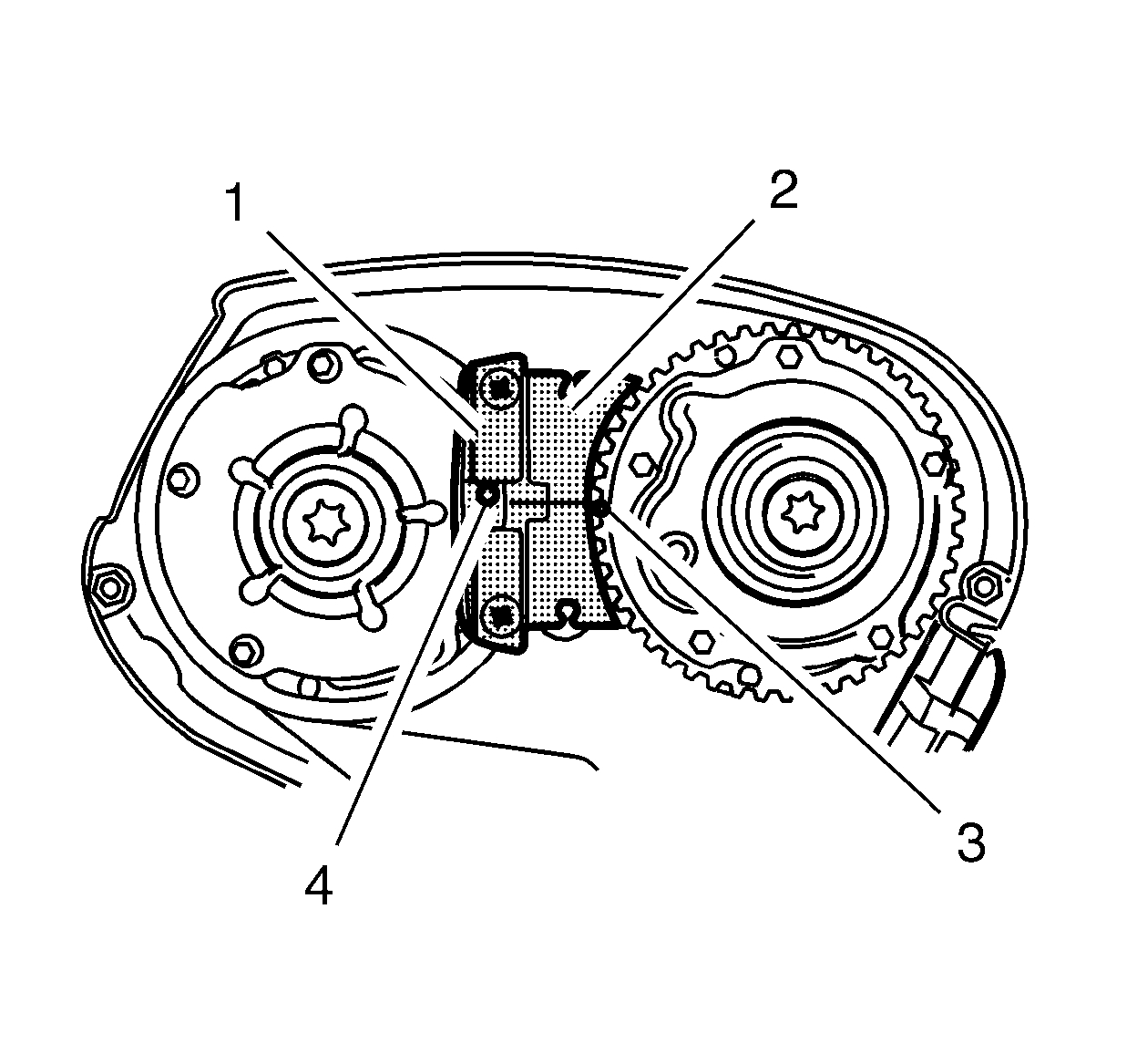

12. Install EN-6340 - locking tool into the camshaft position actuator adjusters.
Note:
The spot type marking (4) on the intake camshaft adjuster does not correspond to the groove of EN-6340-left during this process but must be somewhat above as shown.
1. Install EN-6340-left - locking tool (1) in the camshaft position actuator adjusters as shown.
Note:
The spot type marking (3) on the exhaust camshaft adjuster must correspond to the groove on EN-6340-right.
2. Install EN-6340-right - locking tool (2) in the camshaft position actuator adjusters as shown.

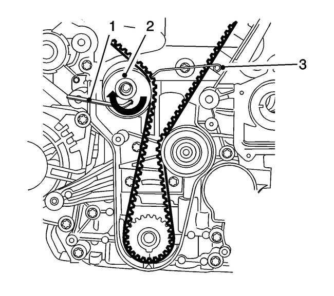

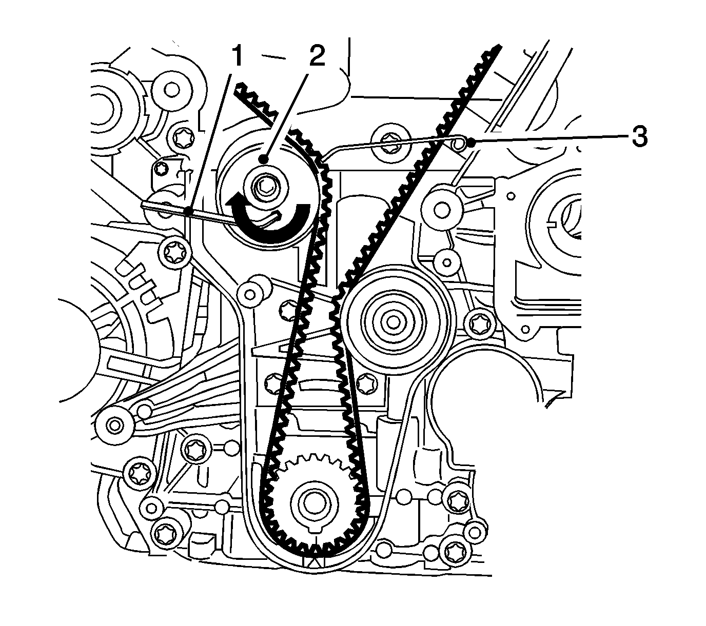

13. Apply tension to the timing belt tensioner (2) in the direction of the arrow, using an Allen key (1).
14. Install the EN-6333 - locking pin(3).
Note:
Note the direction of the belt.

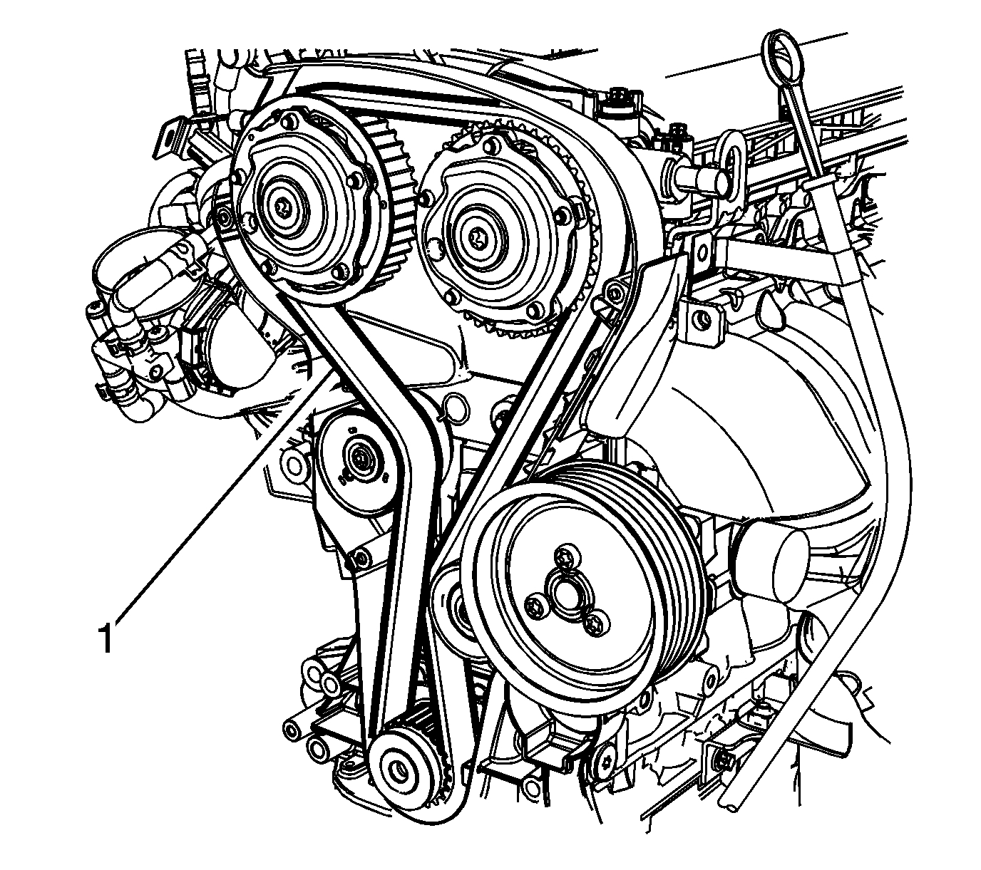

15. Remove the timing belt (1).

1. Install the timing belt (1).
2. Guide the timing belt past the tensioner and place it on the crankshaft sprocket wheel.
3. Place the timing belt on the exhaust and intake camshaft position actuator adjusters.
4. Apply tension to the timing belt tensioner (2) in the direction of the arrow, using an Allen key (1).
5. Remove the EN-6333 - locking pin (3).
Note:
The timing belt tensioner moves automatically to the correct position.

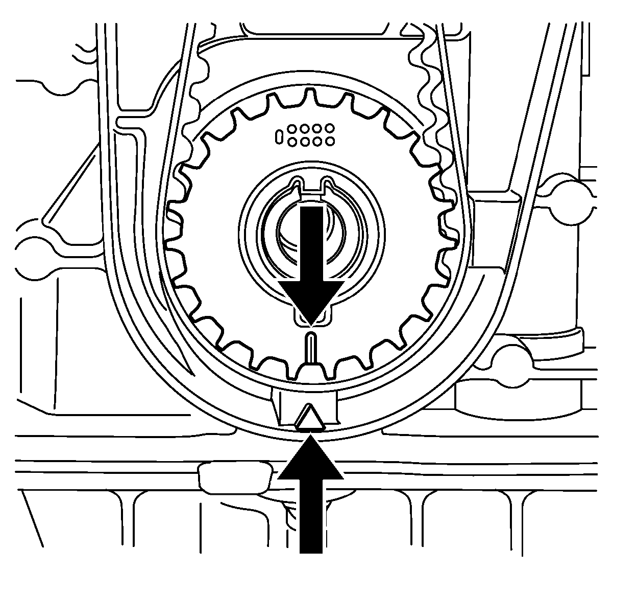

6. Check the timing.
Note:
Note the marking at the camshaft sprockets.

The spot type marking (4) on the intake camshaft position actuator adjuster does not correspond to the groove of EN-6340-left during this process but must be slightly above as shown.
2. Install EN-6340-left - locking tool (1) into the camshaft position actuator adjusters as shown.
Note:
The spot type marking (3) on the exhaust camshaft position actuator adjuster must correspond to the groove on EN-6340-right.
3. Install EN-6340-right - locking tool (2) into the camshaft position actuator adjusters as shown.

The timing belt drive gear and oil pump housing must align.
8. Control the crankshaft balancer position.
