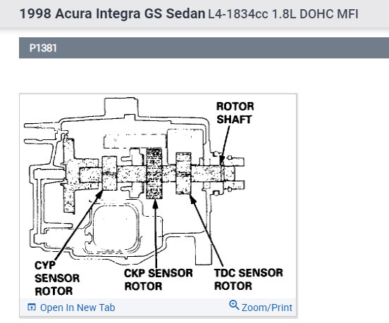

Code p1381, will not pass emissions smog test?
1998 ACURA INTEGRA
193,225 MILES • 1.8L • 4 CYL • 2WD • AUTOMATIC
NICKERSON.J

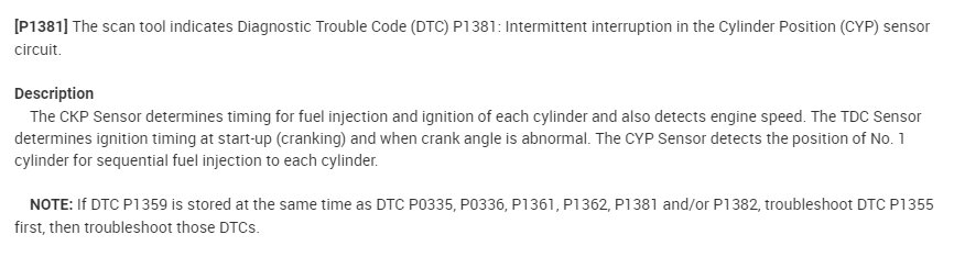

The code p1381 comes up cylinder position sensor. High on Hc (PPM) NO (PPM).
Feb 25, 2023 at 1:46 PM
  • CAR REPAIR CONTRIBUTOR
  • 110,190 POSTS

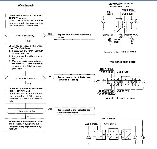

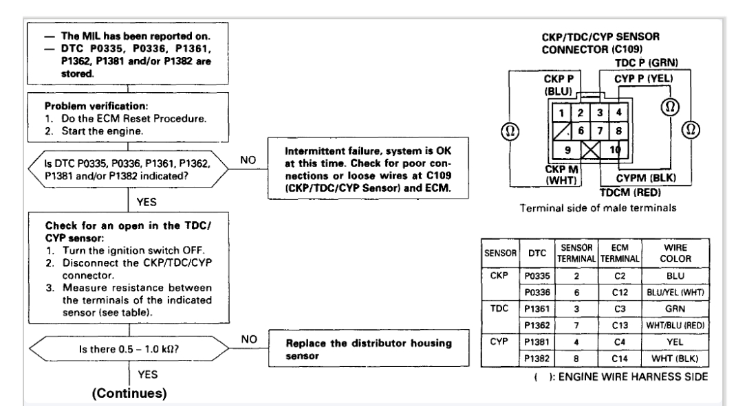

The code indicates there is either a wiring issue to the sensor or the sensor itself has failed.
Do me a favor. I attached the diagnostics below specific to this code. Take a look through them and let me know if you are comfortable performing them.
