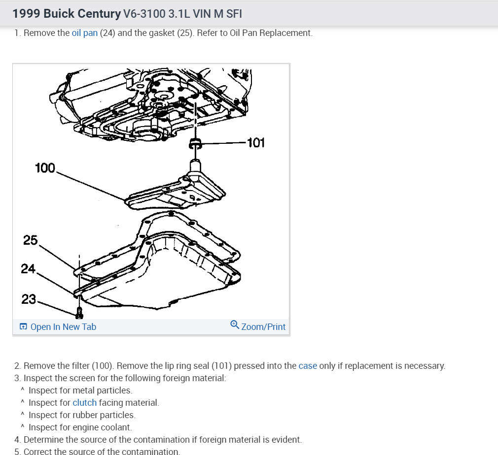

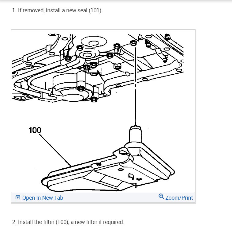

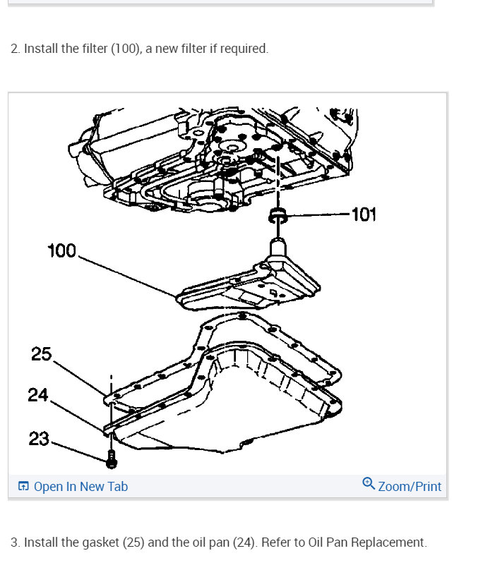

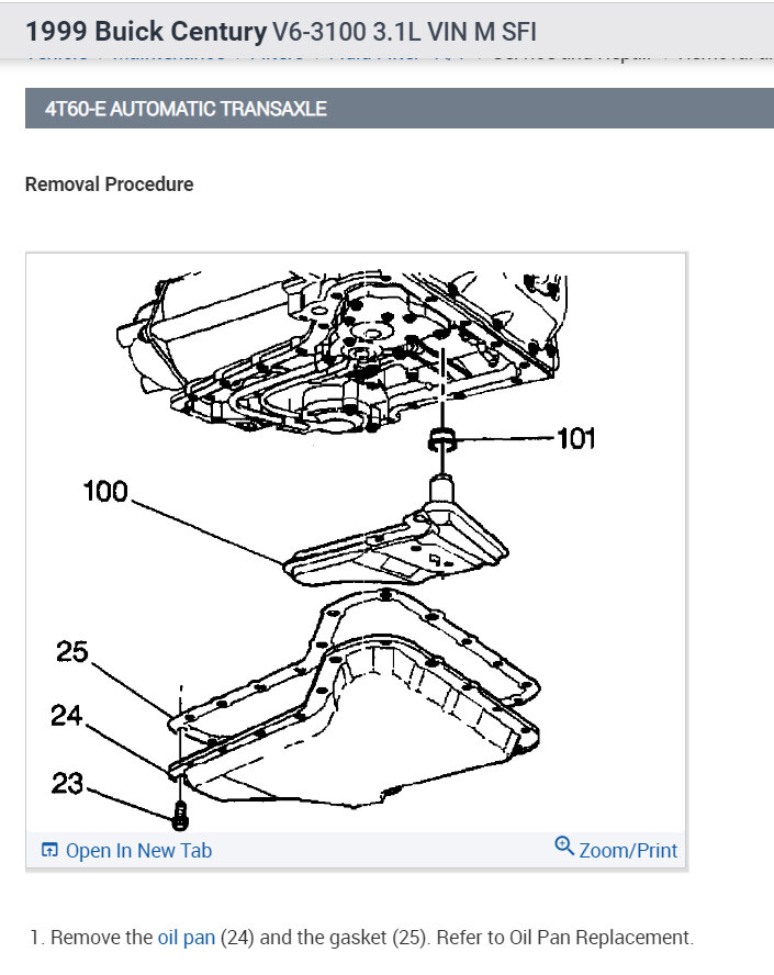

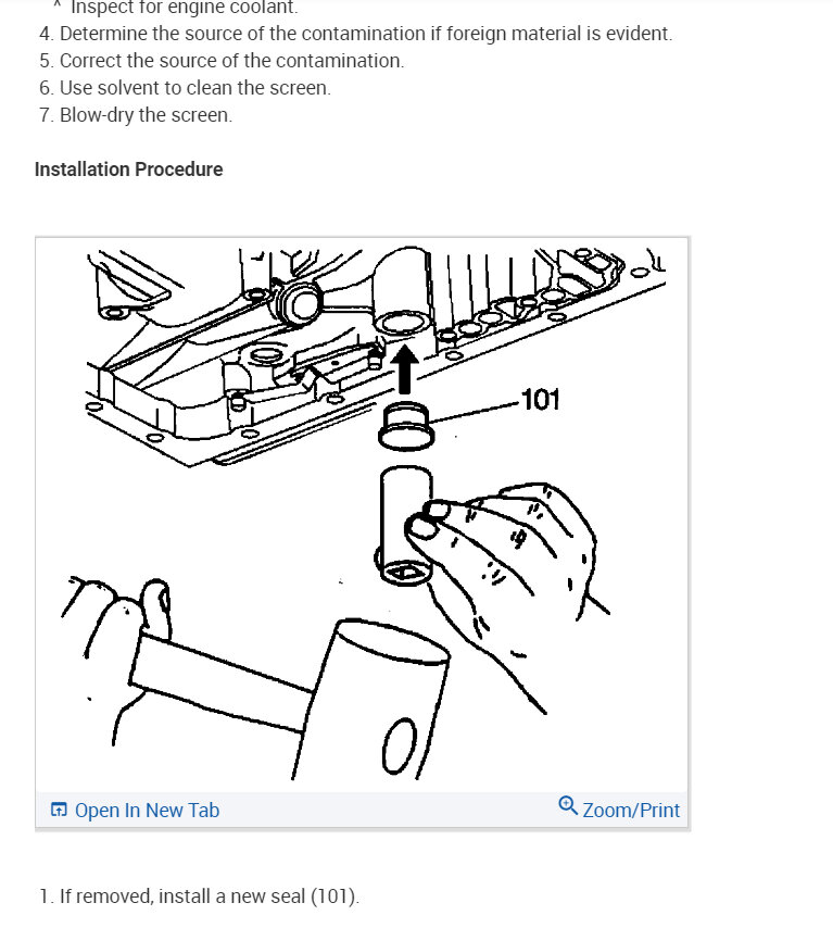

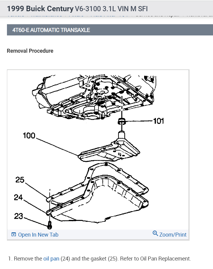

First, I would service the transmission and make sure the fluid is full, also I would replace the pan gasket as well. The filter could have fallen off into the fluid pan which will cause the problem you have described. If this doesn't help, then the transmission will need to be rebuilt. Here is a guide to help walk you through the steps with instructions below to help you on your car:
Check out the images (below). Let us know what happens and please upload pictures or videos of the problem.
