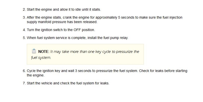

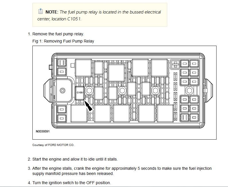

I am including two images that detail how to release the fuel pressure before starting the test. This is so you do not get sprayed with gas and get it all over the place.
Do that and let us know what you come up with.
