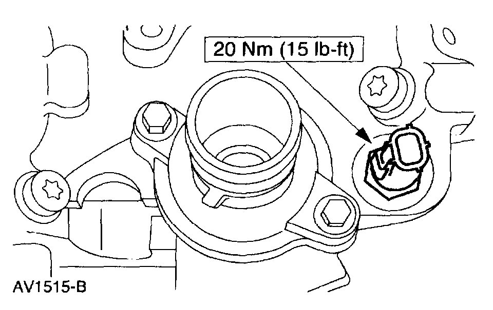

The fuel pressure is right where it should be. So, why all the fuel? Do not run it more than you have to otherwise you will be replacing catalytic converters too. Since the pressure is good, lets check the coolant temp sensor. It tells the computer the temperature of the coolant. With that information, the computer adjusts the fuel/air mixture. If it thinks it is -50 degrees F, it will dump fuel to make the engine run.
If your scanner has live data, check the CTS and see what temperature it is reading. If you find it is bad, the sensor is next to the thermostat housing. I attached a picture of it for you.

Live Data ECT temp.89f. ECT volts 2.52 . ECT status No Fault, .Ambient Temp 91f. ECT self test pass.

This ranger 3.0L flex fuel has had a lot of parts put on it. Plugs, wires, cam and crank sensors. Sense ECT test engine will not start. Poss.plugs soaked with fuel. And cam synchronizer checks good.

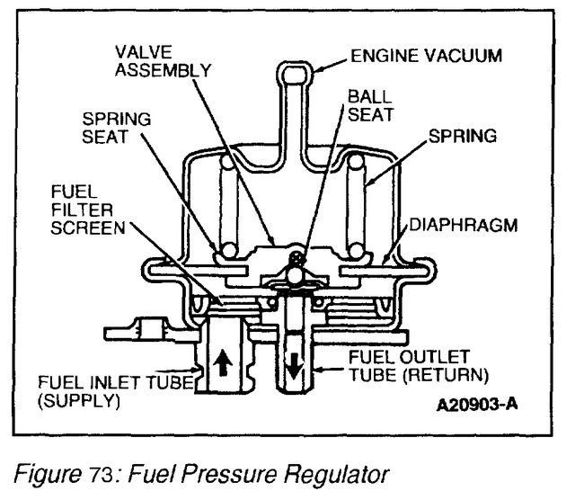

Okay, I removed the fuel pump fuse and it just cranks no start. Reinstalled fuse and tried starting it again. It wanted to start but never did. Is there any way to test the in tank fuel pressure regulator?

The fuel pressure regulator is attached to the fuel rail downstream of the fuel injectors. Pull the vacuum line off it and check if there is fuel in the hose. I have to be honest, based on how you said pressure was jumping around, I feel it is bad. The pressure should not jump as high as it is. You may be sucking gas through it via engine vacuum.

Yes I know it looks like one. But they call it a fuel pulse damper. It is not serviceable. The actual fuel regulator is part of the fuel pump assembly. I am just not sure how to test it in the fuel tank.

Hi. The component you are referring to is not a regulator. The damper, which is part of the pump assembly, basically is to keep the fuel pressure steady when the injectors are opening and closing. There is no test for that component that I have ever heard of. I checked both of my manuals and there is nothing indicated.

Okay, so the regulator is on the fuel rail? Because that was one of the first things I checked. No fuel at all in the vacuum hose. So where do I do from here?

Yes, it is on the rail. I have to be honest, it is hard to believe that all six injectors would have stuck open at the same time. That leads me back to the regulator, or there is an ignition timing issue. I am going to ask the owner of the site for his opinion. One of us will get back with you ASAP. Lets see if he can more insight.
