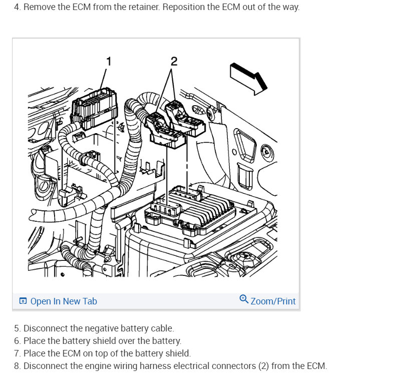

I did not see the video. I would help if I could see what's going on. It does sound like the PCM is going out though due to the random and ever changing codes. I would check the PCM grounds and power inputs and all fuses. If everything seems okay clear the codes and then without starting the engine turn the key on and then read the codes again and then post them.

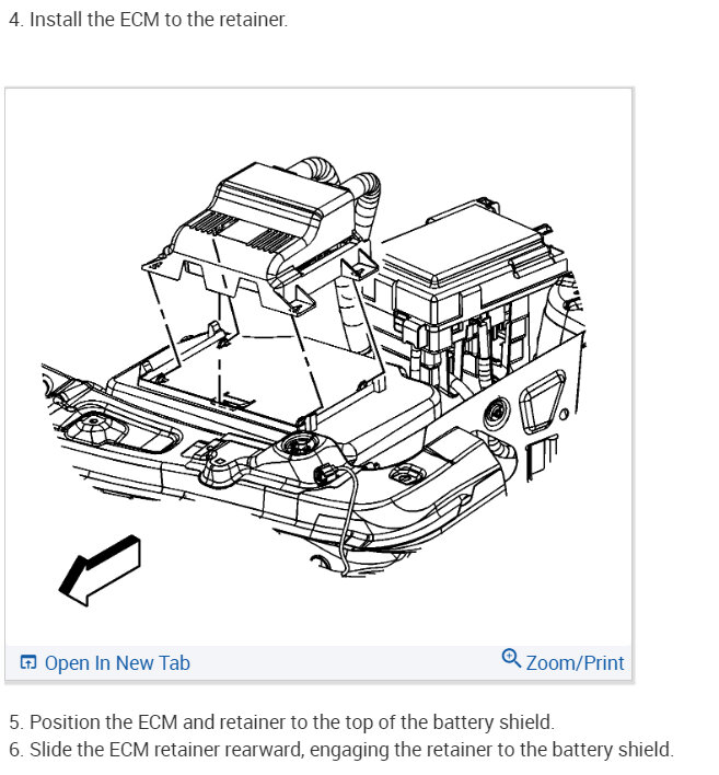

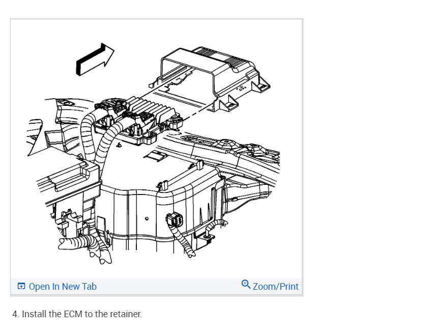

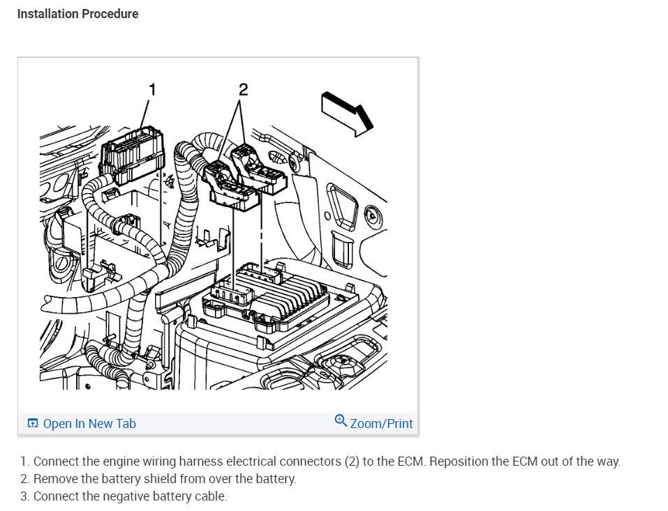

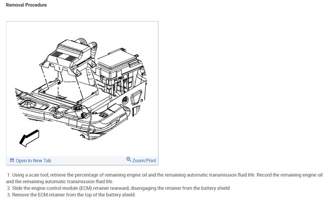

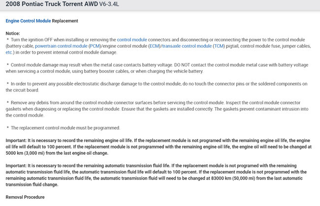

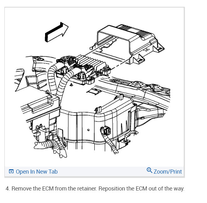

Here is how to change out the PCM in case you need it, you can get a preprogrammed unit by searching Google or Ebay. Check out the images (below). Let us know what happens and please upload pictures or videos of the problem so we can see what's going on.

Thanks Ken, the mileage is in kilometers, that 78,000 miles on it. I took the complete throttle body off today, cleaning it and maybe putting a new MAF sensor on, there was a nut missing from the MAF where it joins the throttle body. Im going to pull the coil and put a new one. While its off I'm changing the plugs in the back and front with fresh NGKs. I'll let you know when it's back together, and well see if it runs better. After that it's on to a new ECU and get it programed. P.S. Also, got a new battery.
