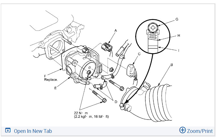

We cleaned the air intake port on top of the engine. We sprayed a little engine valve cleaner into the air port. The Engine will start but shuts off when it idles.

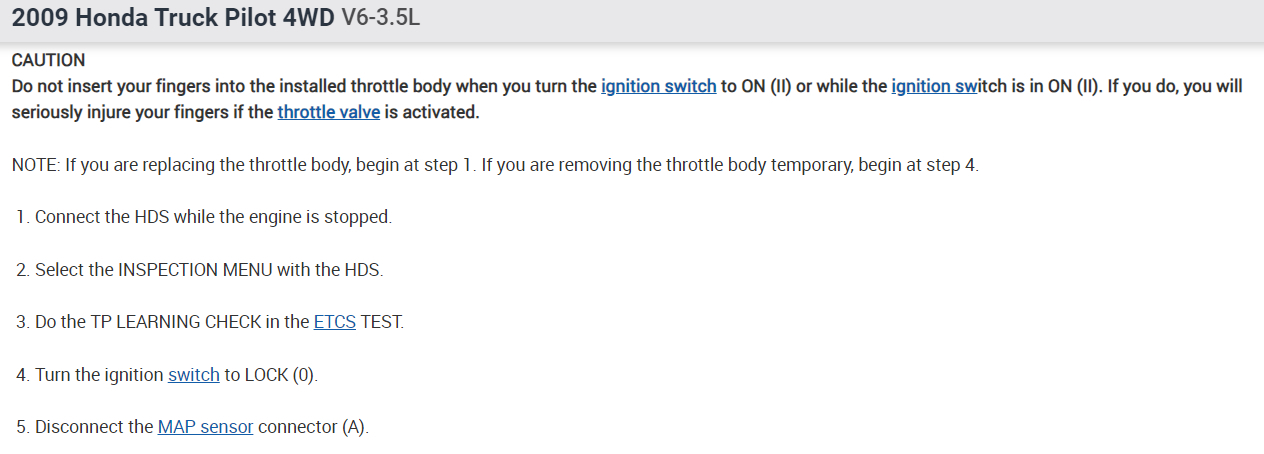

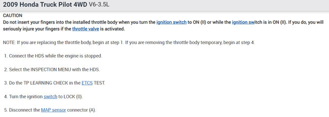

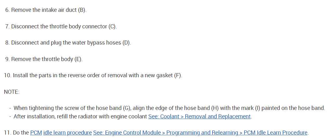

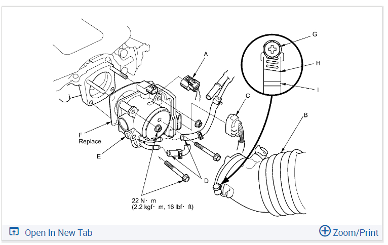

Air intake port? Do you mean throttle body? If so, did you remove the wiring connector or move the throttle bore butterfly plate? If so, the throttle bore will need to have a relearn procedure to help it run correctly again, here is a guide to help you understand what the problem is, and I have included instructions on how to fix it in the images below.

Check out the images (below). Let us know how it goes.
