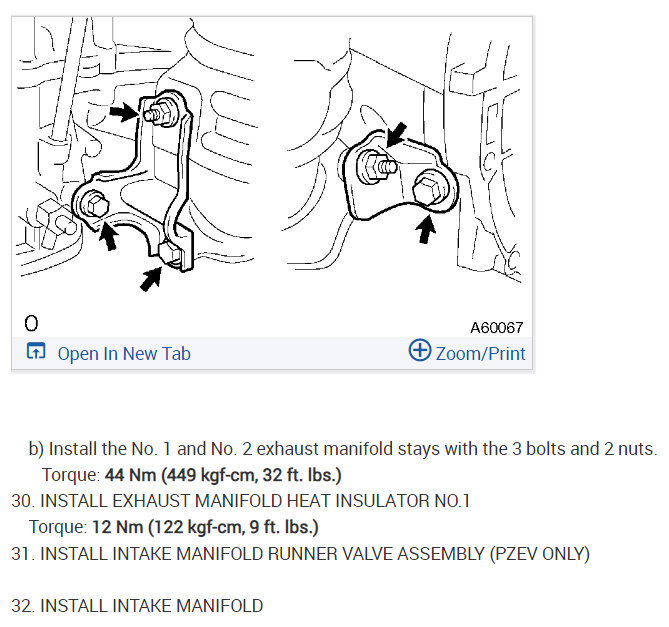

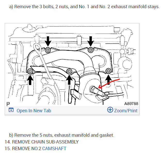

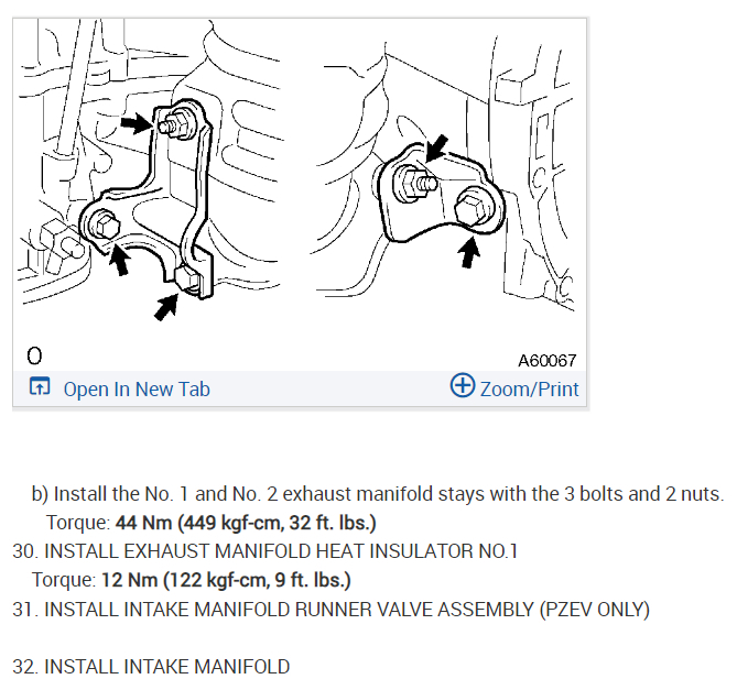

My Toyota Noah 2006 start and doesn't accelerating well it's not go over 2000 RPMs when rev.
Jul 9, 2024 at 12:43 AM
  • 55,583 POSTS
There are three main reasons this can happen, first please check the air filter. If that looks okay let's test the primary catalytic converter. You can remove the primary oxygen sensor which should help.
here is a guide to help:
You also could have low fuel pressure but let's run the codes as well.
