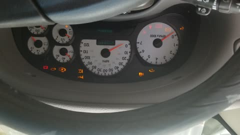

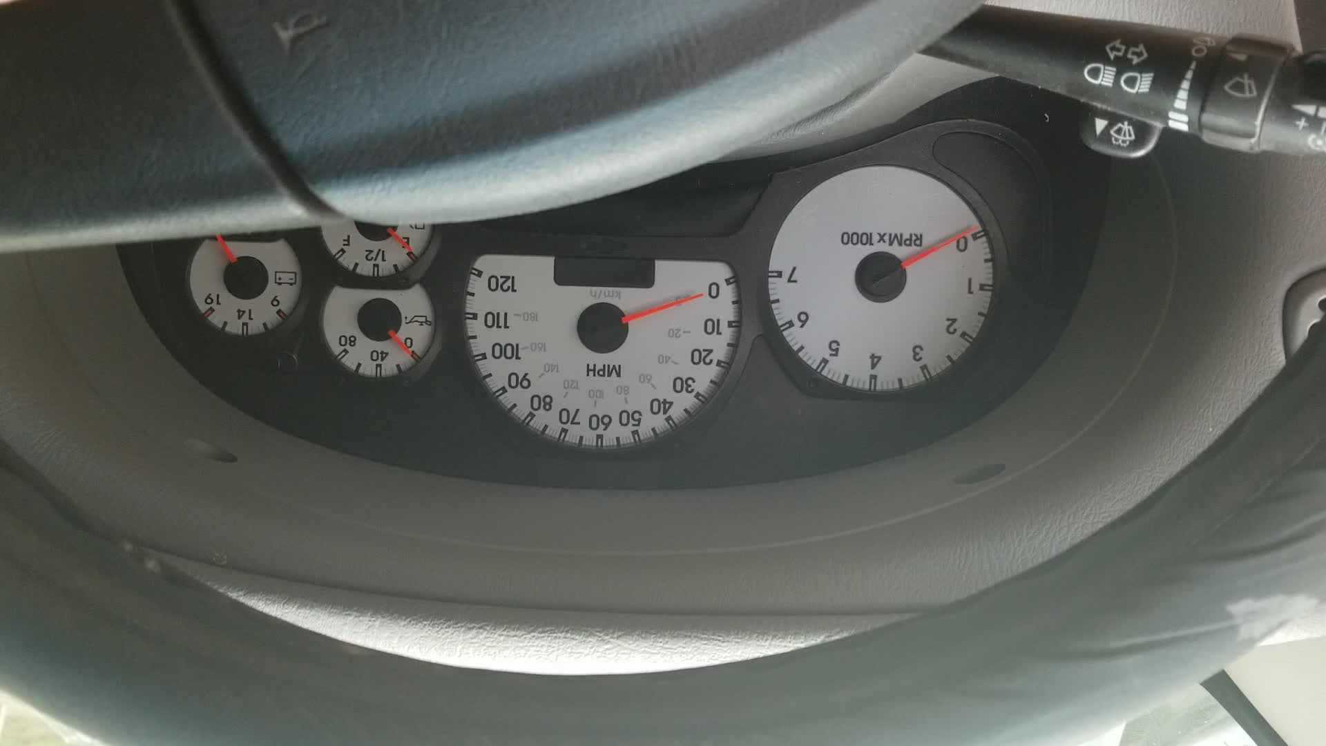

Got this SUV back in October, drove it for ten days and as it was being driven with cruise the rpm's revved up and then lost all gears except park. I'm no mechanic. Need ideas or help please.

Sorry for the late post, at first it wasnt throwing a code and then just a week or so ago it threw a code stating like the throttle body or pcm so we changed those and it still wont go into gear. I'm at a loss for words. My husband is going crazy over it. Not sure what else to do. You can move the shifter yes but no movement is correct. The fluid didnt look bad, had a few shavings but nothing horrible in it.

Will the engine rev up in neutral? Also, can you check to see if the reverse lights come on? Can you please shoot a quick video with your phone so we can see what's going on? that would be great. You can upload it here with your response. There is a pressure control solenoid that goes out in these cars but I wanted to see if the reverse lights work that will tell us if the gear range sensor is working.

Says this video uploaded, any thoughts would be fantastic. The SUV and motor seem to be in fantastic shape

Yep the engine is fine, it sounds like a transmission input or output shaft has broken, the engine is fine except for the tach that does not seem to follow the engine. I would start by removing the transmission case to spin the shafts to see if there is something broken, then remove the transmission and check the shafts, if everything is okay send the unit in for a rebuild or get a rebuilt unit fro the dealer which is what I recommend. Was there any noise before this happen? This video will give you an idea of what you are in for when removing the transmission. The code you have has nothing to do with the problem.
