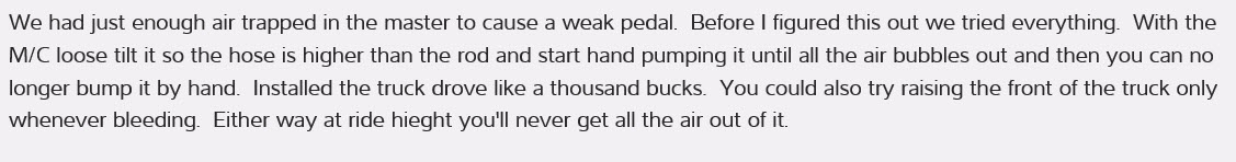

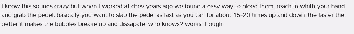

Stopped at the gate would not go into gear after that replace clutch master cylinder the clutch throwout bearing pressure plate and slave cylinder. it is hard to bleed out and it still wont go into gear. I do not have a scan tool it feels like it is in neutral really loose and the shifter was also taking part in like that. Everything looked okay would the shift solenoids make it so it would not go in any gear like it was always in neutral and not going to any gear there was no squealing or squeaking or grinding noises before this happened.
Aug 20, 2016 at 2:38 AM
HMAC300
  • 48,601 POSTS
you do not have any shift solenoids on a manual transmission. these are a pain to bleed see pictures for tips on how to bleed master so system will work and you will be able to shift it. these are tips from guys in the field who have had trouble with this. if all else fails rent a power bleeder from a rent it shop. make sure master is full when you do this.
