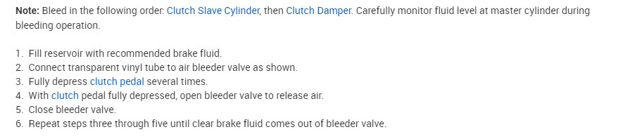

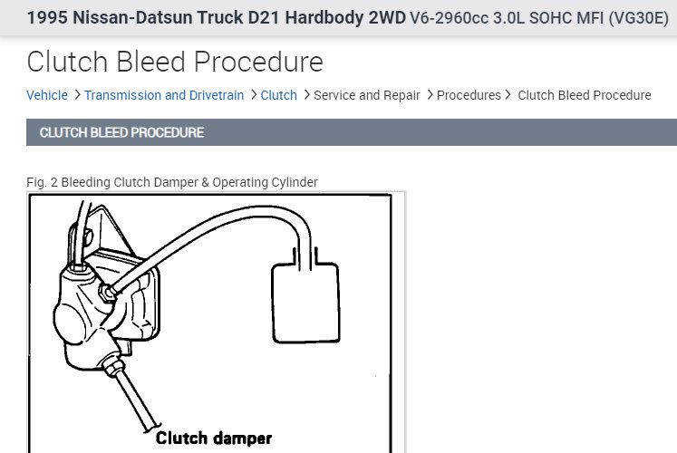

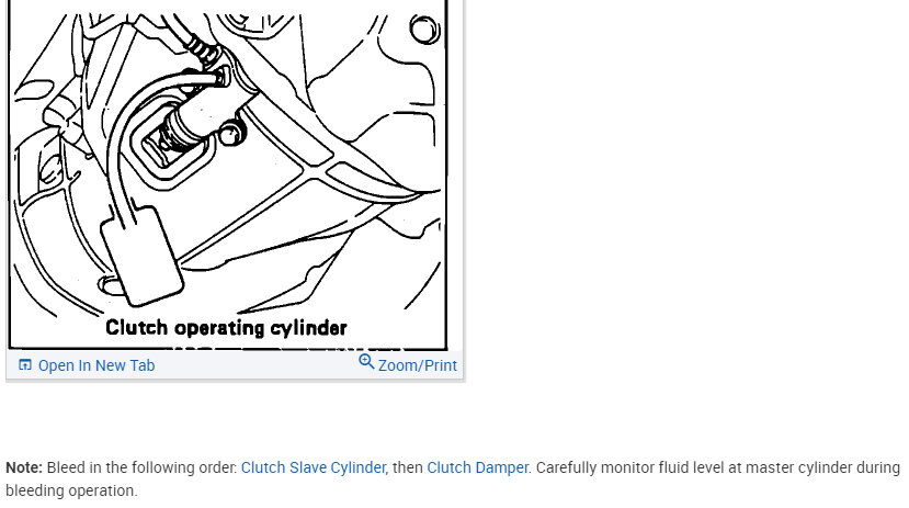

I attached the clutch bleeding procedure below. Take a look and let me know if you have already done this. If you haven't, try it to see if there is possible air in the system. Hopefully, that is all that is wrong.

Hi and thanks for the reply. I see where the damper is. Question though. Those lines do not attach to my master cylinder, but a couple do go to the brake master. Does that still help me bleed the clutch system? If so, do I then need to bleed the Clutch Master? I am replacing the clutch master thinking that might be the issue. I understand that it is slave first then damper by the way. Just wondering about damper part of it and if I then bleed the master last, or not? Thanks
Jun 27, 2023 at 1:51 AM
  • 110,251 POSTS
It's been a while since I've worked on one of these, but if I recall, the brake master cylinder also functions as the clutch MC fluid reservoir. That is what I believe you are seeing.
And yes, after the new clutch master cylinder is installed, then follow the bleed procedures.

Did you follow the directions I listed above? That is what the manual indicates needs done. You can do it as well as a shop.

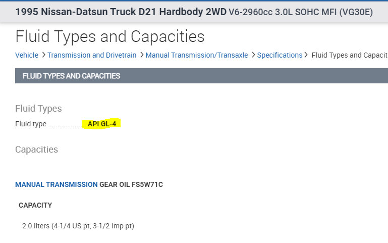

There is transmission fluid. It's actually GL4 gear lube. See pic below. If it is low or excessively dirty, it can cause a hard shift. This is absolutely worth checking.

I will check the transmission fluid myself. Where I'm checking for the fluid has a bolt with a recessed square opening, like it would fit the end of a 1/2 drive ratchet or extension without the socket. Is that what i use? Also, can you confirm for me please if this is what I use if it's low?
multipurpose gear oil API GL-4; SAE 75W-90 or 80W-90.

You are very welcome. I hope this is all that is needed. Rather than adding fluid if it is low, drain it and refill it with the 75-90 GL4. It has 200,000 on it and I suspect it has never been serviced.
