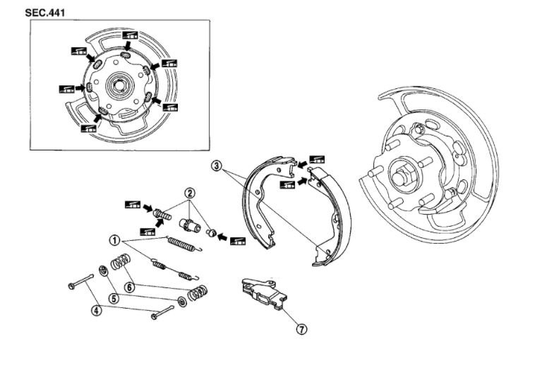

First, thanks for letting me post my question. Okay, I have the car listed above that when I put it in gear it won't go forward. ABS when I press on the gas it won't go over 2k same for reverse it won't move. It acts like it's in limp mode but obviously I'm not a mechanic that's why I'm here. I hooked a code checker to it and it sent back transmission code one said line pressure can't remember the rest sorry and I'm at work. I am really needing help figuring this out badly. Thanks in advance!
Feb 24, 2021 at 1:05 AM
Good morning,
Does the car roll in neutral? This sounds like the brakes may be locked.
https://www.2carpros.com/articles/parking-brake-shoe-replacement
I need the code number that was set to help with the failure. A code for line pressure may mean an internal failure.
