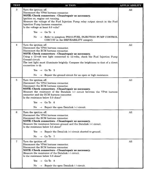

My truck will not go faster than 15 mph. Reads a p1689. Don't know what's exactly wrong.
May 20, 2020 at 6:57 AM
Good evening,

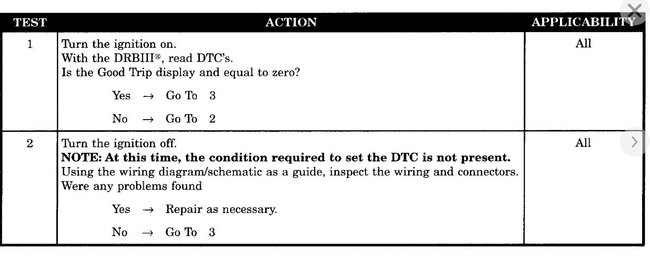

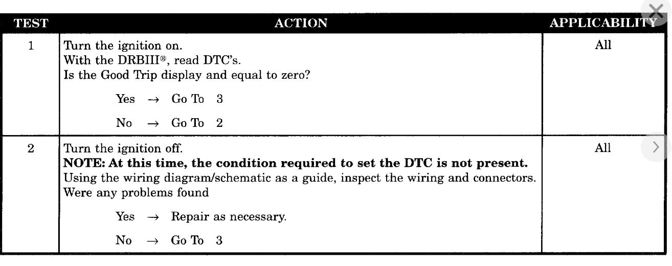

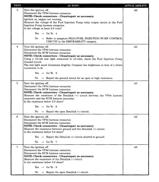

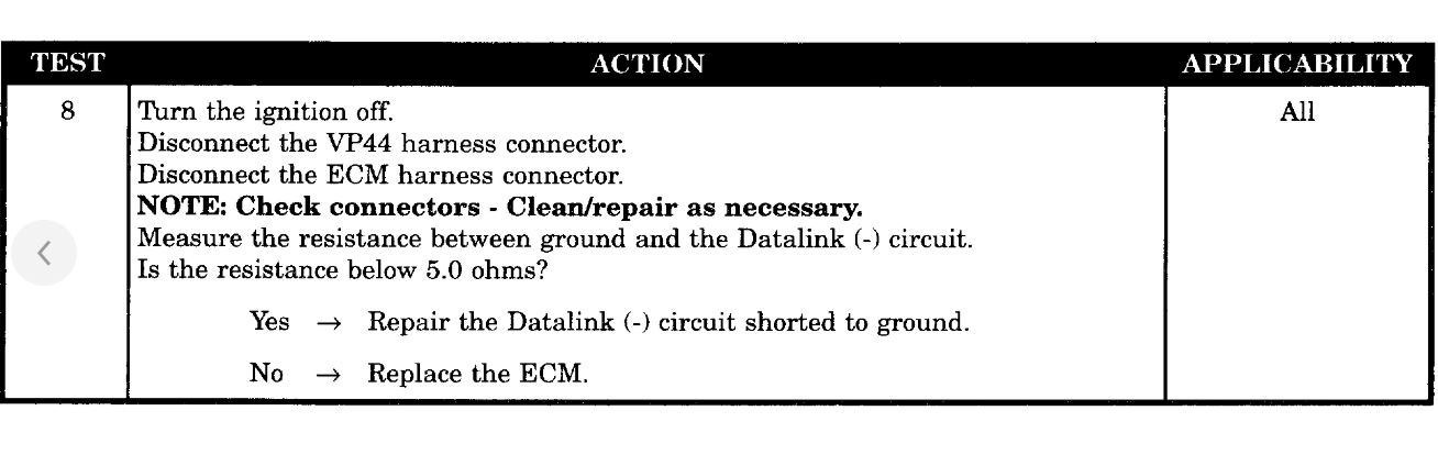

I attached the flow chart and possible failure for you for this code. Most of the time it is a bad connection at the ECM.
What kind of scan tool do you have for testing?

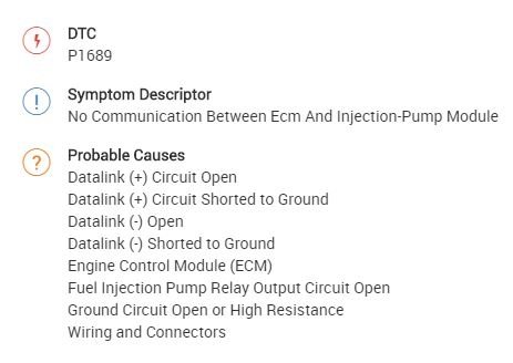

SYMPTOM
P1689-NO COMMUNICATION BETWEEN ECM AND INJECTION PUMP MODULE (OBDII)
WHEN MONITORED
Ignition ON.
SET CONDITION
Time between CAN messages is greater than 3 seconds or Fuel Injection Pump Module does not receive CAN message.
POSSIBLE CAUSES
Wiring and connectors
Fuel injection pump relay output circuit open
Ground circuit open or high resistance
Datalink (+) circuit open
Datalink (+) circuit shorted to ground
Datalink (-) open
Datalink (-) shorted to ground
ECM
