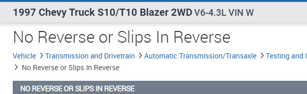

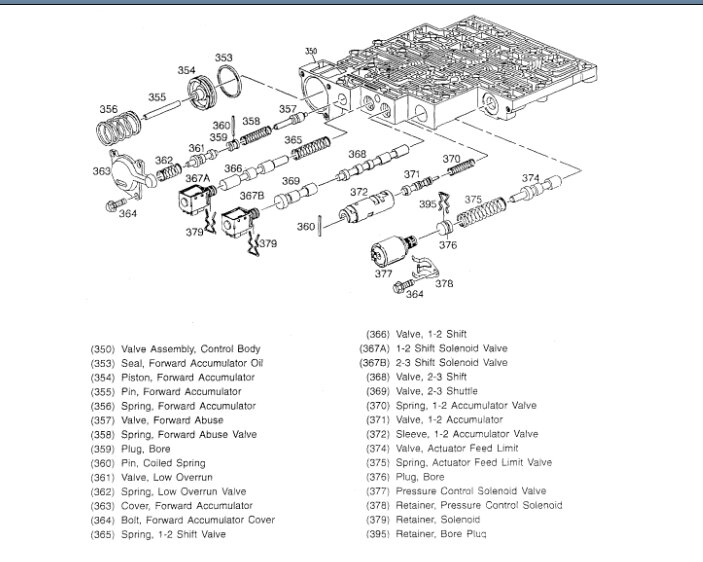

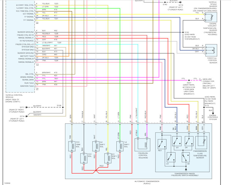

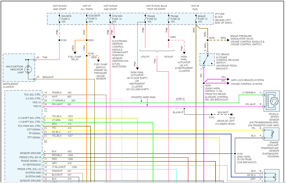

I'm looking at buying this truck. Reverse doesn't engage. It's not that it's slipping. It's simply not going into reverse at all. All forward heard work and shift fine. I've owned several S10s and blazers, so I do know how they should feel. The transmission fluid is full and not burnt but not fresh either. Just good.
Live data shows that the solenoid isn't switching on.
My thoughts are (1) bad solenoid (2) wiring issue or (3) maybe an issue with the range sensor???
What I need to know is where the solenoid is, what wires to inspect, and how to go about checking the range sensor. Please and TIA.

I'm not sure which solenoid you are referring to. By chance, do you still have the diagnostic trouble code that is related?

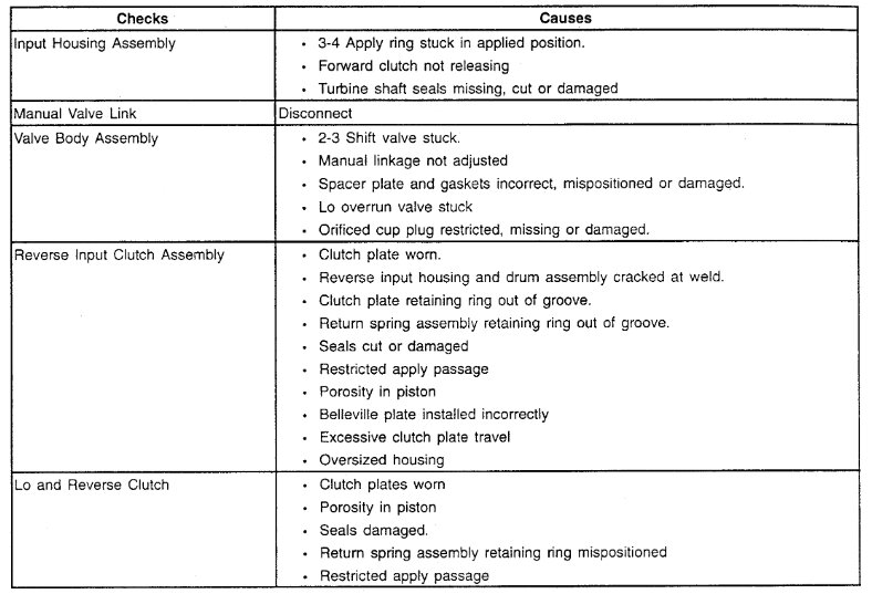

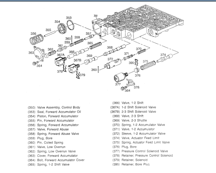

Here is what I attached below. First, pics 1 and 2 are diagnostics for a slip in reverse or no reverse condition. Explains different possibilities.

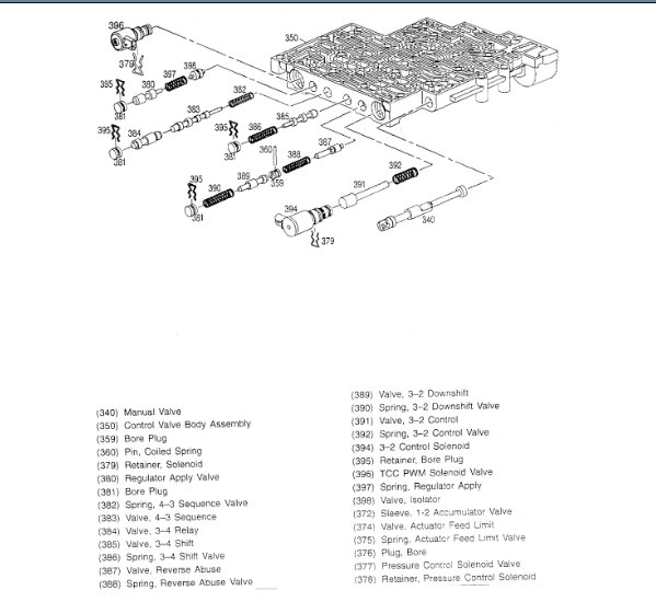

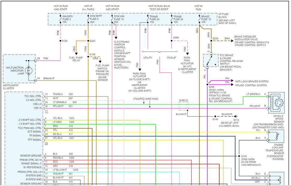

Pics 3 and 4 are exploded views of the valve body and its components including valves and solenoids. Pics 5 and 6 are the wiring schematic of the transmission electronics. Note that the two pics came from one page. I had to cut it in half to make it readable.
Let me know if this helps. Also, let me know if you have the specific codes that you had. If you do, I should be able to narrow things down for you.

To be clear, it's not slipping. It's simply not going into reverse at all. I'll try to get any codes and other info, but dealing with the guy I'm dealing with is like pulling teeth. So, it might be a while.

That sounds like a good plan. Let me know what you find. Also, the directions I attached above are for both slipping and no reverse.
