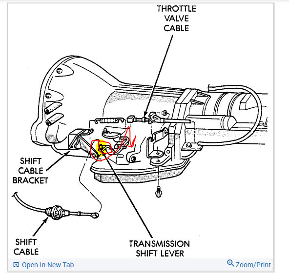

I was driving down the road on the way home like usual, I slowed down at a red light and it turned green. I went to accelerate, and it felt like a pop per se but then the vehicle wouldn’t drive. It was low on transmission fluid, and I filled that up, had her running a while but still she won’t drive or reverse. I can move the shifter into drive ETC but there’s no click no pull it just slides up and down… I need help ASAP anyone might have a solution??

How low was the fluid? Was there any change when you added fluid? Let me know.
Also, I attached a pic below showing where the shift linkage attaches to the transmission. Make sure the vehicle is secure and unable to move. Have a helper shift through the gears while you watch on the transmission if the cable is moving the lever.
Let me know what you find.
joe
See pic below.

The fluid was really low, turned the vehicle on added it let it sit for a while hoping that was it. I’m not good with vehicles at all, could you explain where this picture is located? My father usually does the work, but he’s gotten of age and now I’m on my own and I’m as lost as ever.

As far as the picture is concerned, that is at the side of the transmission, under the vehicle. It is aproximately the same distance back as the front door of the vehicle. There will be a transfer case as well.
Now, the reason I suggested checking the linkage is that you indicated the shifter just moves back and forth with no click or resistance. In my mind, which indicates the linkage has come disconnected and is why I suggest you check if that is the case.

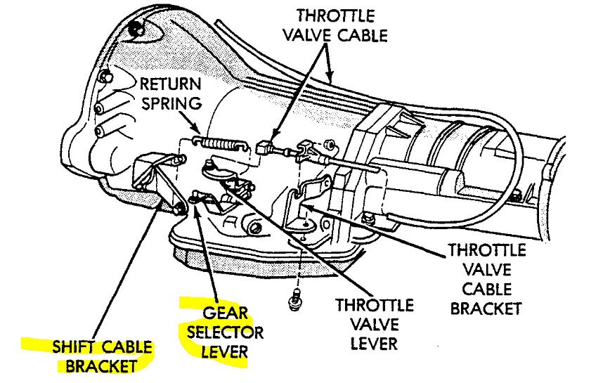

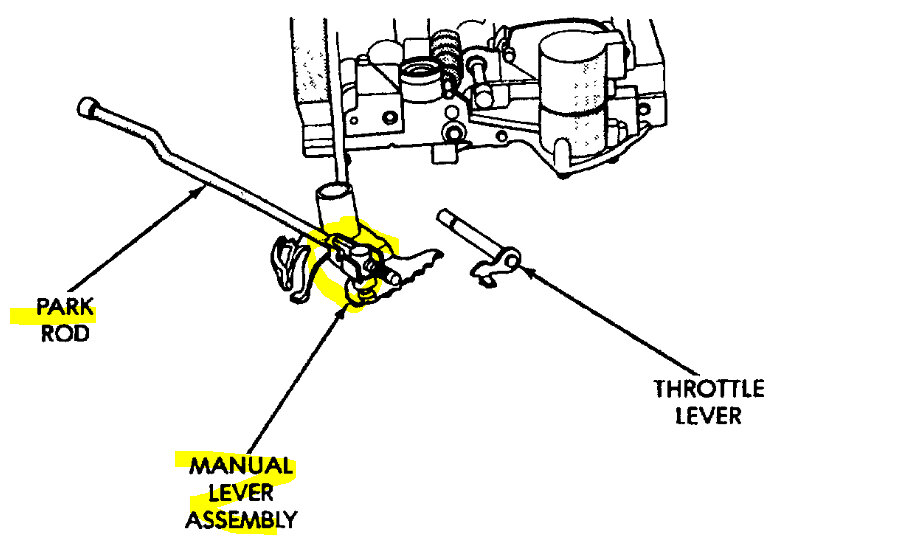

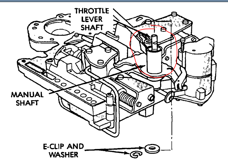

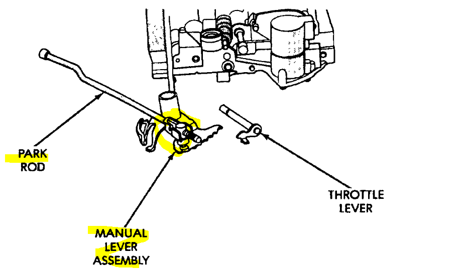

Here is where I am: Since it stays in park in all gears other than neutral and there is no resistance when you shift, I suspect there is an issue with the manual lever assembly in the transmission. If you look at pic 1, I circled the shift lever. The manual lever assembly is on the opposite side of that internally. If the retainer clip has come apart, the park rod may not be moving when it should. Pics 2 and 3 show the internal portion of what I am talking about. Please understand, this is a theory but is where I would start.
Since you determined the shift cable/linkage is working, the next thing to do is remove the transmission oil pan and remove the lever assembly internally.
