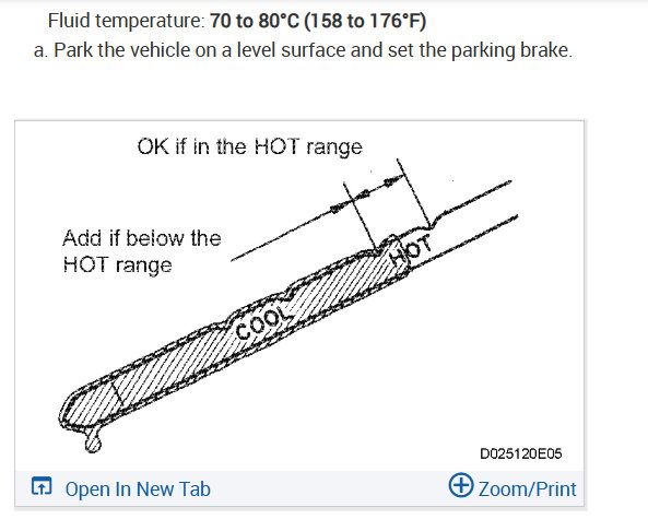

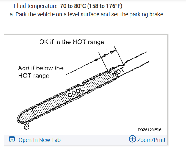

The first thing I would do is check the transmission fluid level, this guide can show you how with instructions in the images below for your car.
https://www.2carpros.com/articles/how-to-check-and-add-transmission-fluid
Also, is the check engine light on? if so we need to runt he codes to see which ones are stored, this video will help you.
https://www.youtube.com/watch?v=LBCpCWEFnTg
