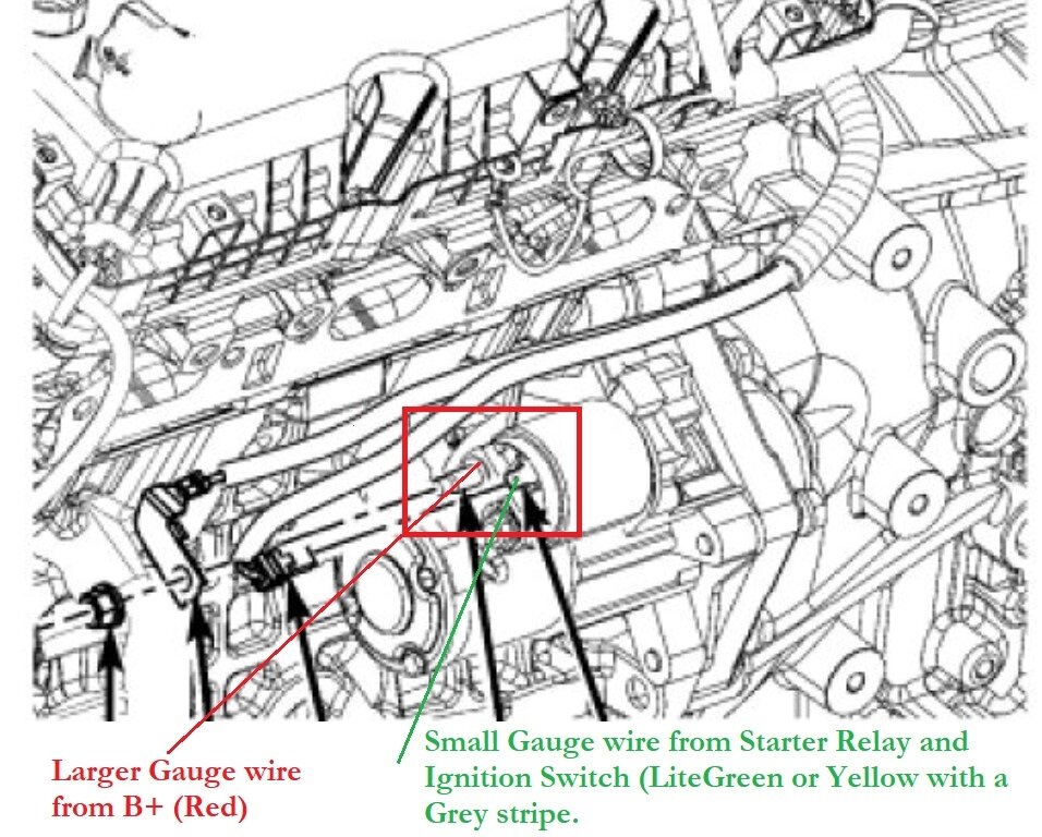

new battery, car cranked over twice then quit and now there is just a small click when turning key. probably the starter/solenoid clicking.155,000 miles.

Hello, can you access the starter motor wiring? Just to verify there is full battery voltage getting to the Starter. I'll post the wiring diagrams and use a multimeter to check the voltage on both power feeds to the Starter. Make sure the voltage doesn't drop off when attempting the crank, it over, you'll need someone to help you crank it over while checking with a meter.

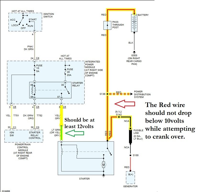

Here is the wiring diagram for the starter circuit, put the black meter lead on battery negative and the red lead on the green (or yellow/grey) wire first and make sure it's a full 12volts, then check the larger red wire.
