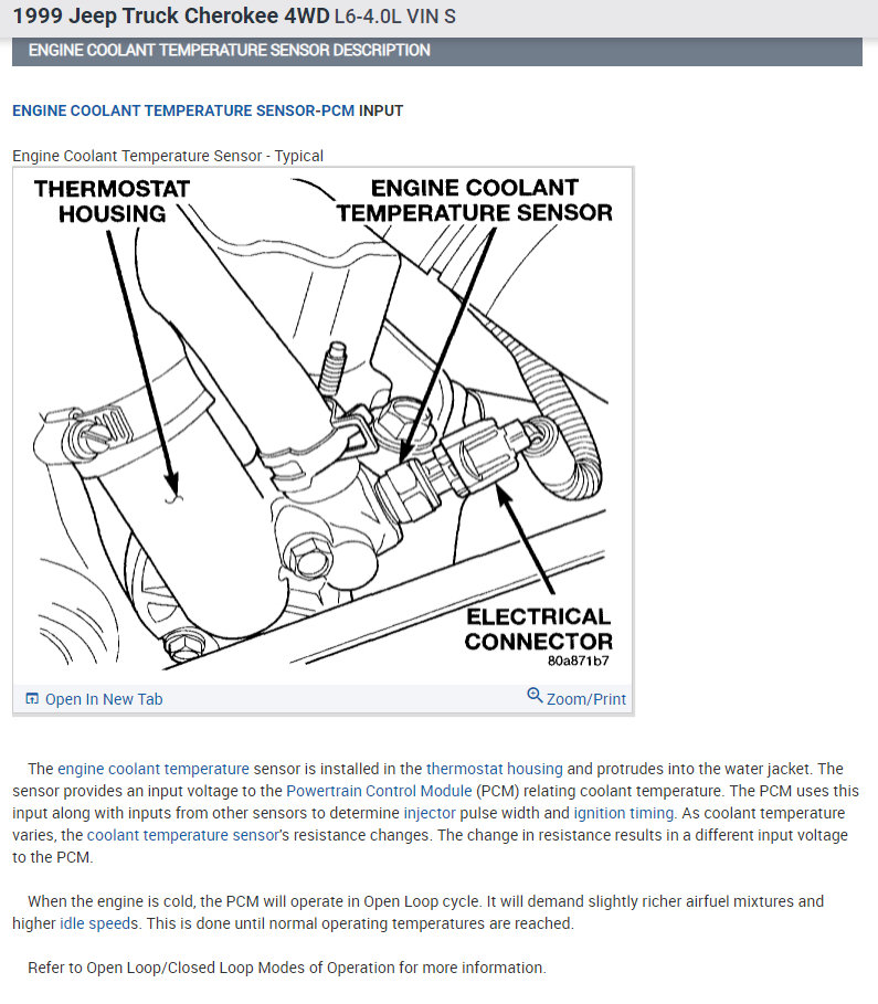

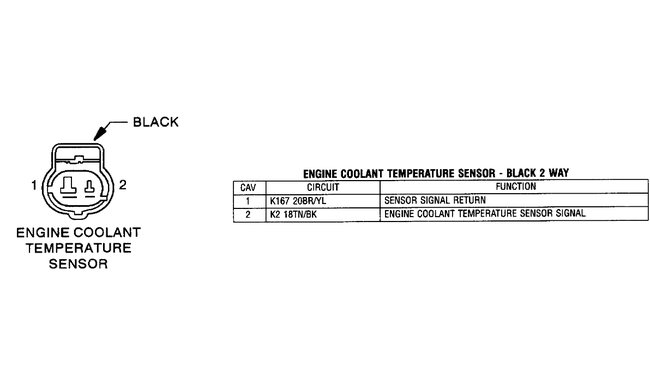

This sounds there might be an issue with the coolant temperature sensor.
The coolant temperature sensor sends signal to the ECM about the engine temperature by changing its internal resistance value. As the temperature changes so does the resistance value. A faulty sensor can send signaling that the engine is 'too hot' to operate. This will keep the engine from starting.
As you mentioned you can start it after some time it is an indication that when the engine cools just a little the temperature sensor sends correct signal, and the engine starts.
There coolant temperature sensor is located on the thermostat housing (see diagram).

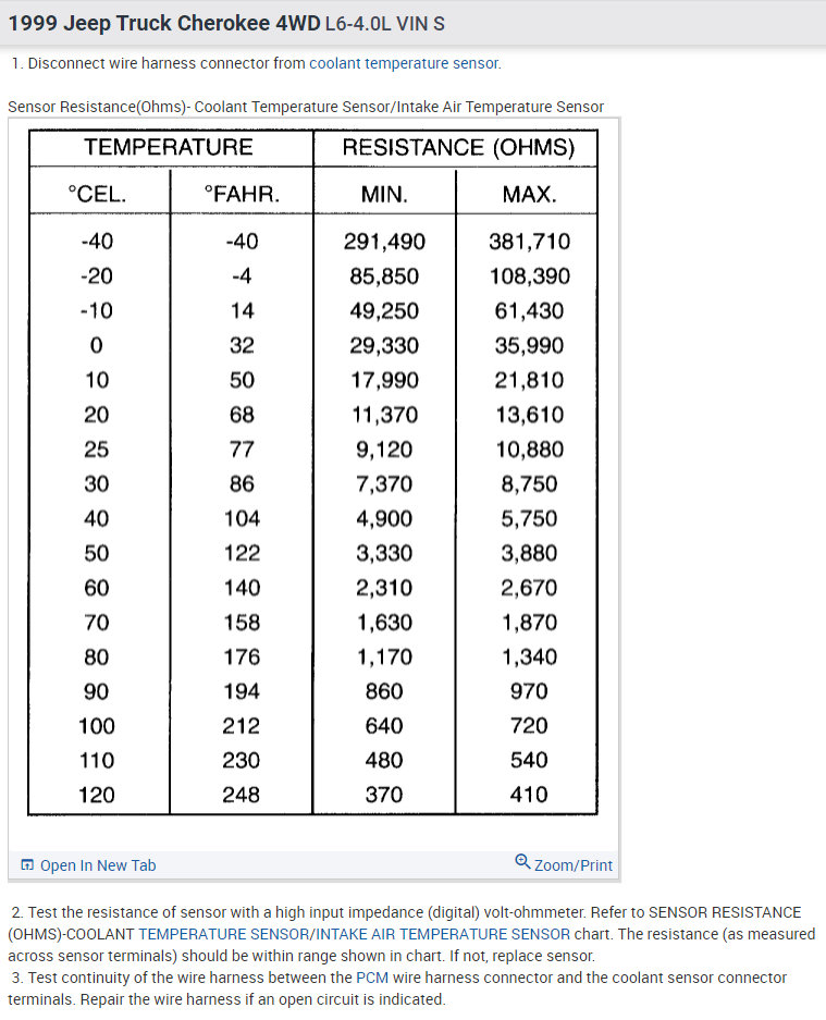

I have attached the coolant temperature sensor resistance chart below. You can use that to determine if the sensor is bad.
