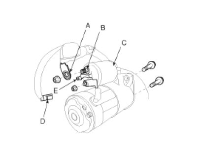

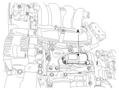

Regardless, if you are sure it's good, then you should remove the starter and have it bench tested. Here is a link that explains how to replace a starter. These directions will help you with removal and replacement:
Here are the directions specific to your vehicle. The attached pics correlate with the directions.

Starter
Removal
1. Disconnect the battery negative cable.
2. Disconnect the starter cable (A) from the B terminal (B) on the solenoid (C), then disconnect the connector (D) from the S terminal (E).
pic 1
3. Remove the 2 bolts holding the starter, then remove the starter (A).
pic 2
4. Installation is the reverse of removal.
5. Connect the battery negative cable to the battery.
