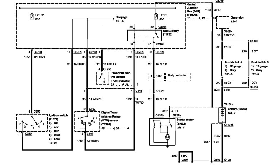

The number four cylinder plug blew out and I took it up to get a heat helical put in. He put the helical in and tried to start it; lights come on no start. All I hear is clicking in the fuse panel.

Is the battery up to charge? Check the voltage, it needs to be 12.6 volts.
Did you try moving it to neutral and trying to start it?
I will attach a wire diagram for you to view to be sure you have the correct powers.
