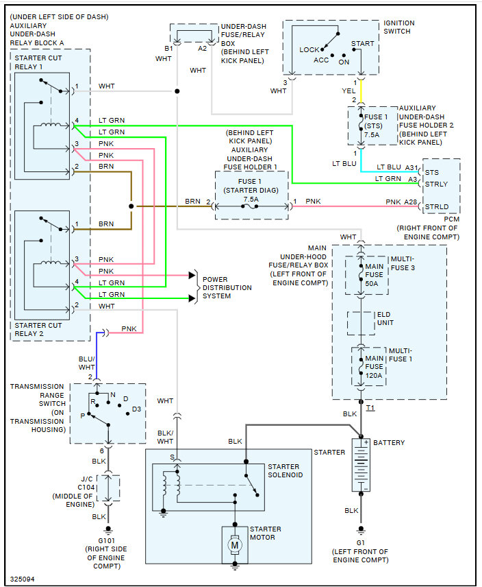

Where are the starter fuses located?
Dec 23, 2025 at 7:07 PM
Experienced Mechanic
55,594 POSTS
Here is the wiring diagrams for the starter system which shows 2 fuses that run the system. Also, I included this video that can help you troubleshoot the starter not working problem.
https://www.youtube.com/watch?v=6YRW8fyNudY
Image (Click to enlarge)
Dec 26, 2025 at 1:33 AM
SILENTHILLDALE
MEMBER
18 POSTS
I installed the remote start and it was working. After I hid all the wires it won't crank and it's stuck in park
Dec 26, 2025 at 1:37 AM (Merged)
55,594 POSTS
Yep, you blew a fuse, and I would recheck the wiring to the remote start unit.
