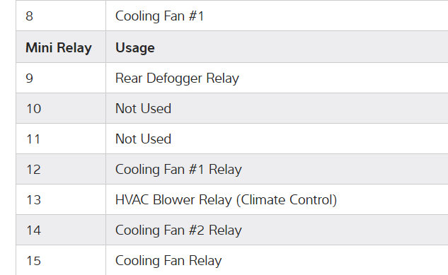

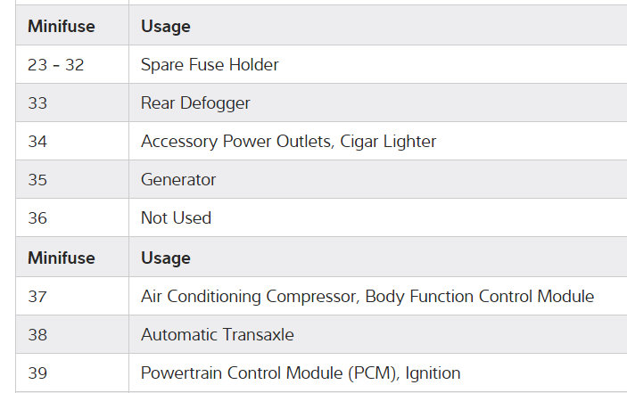

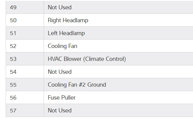

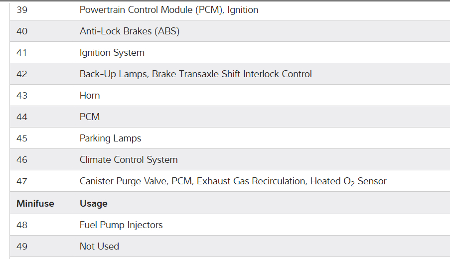

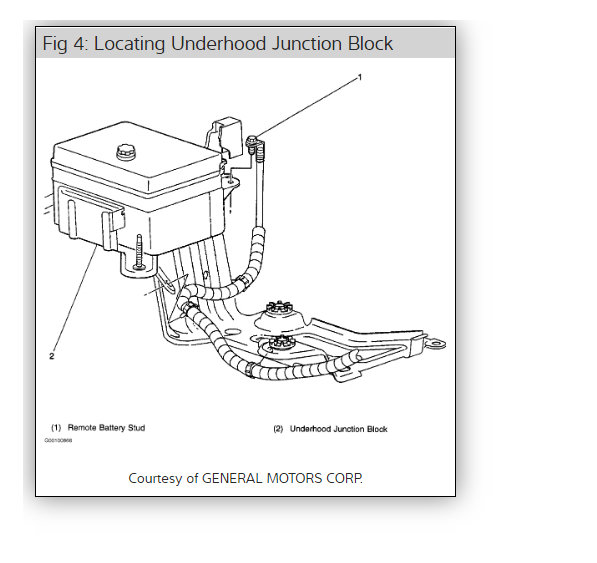

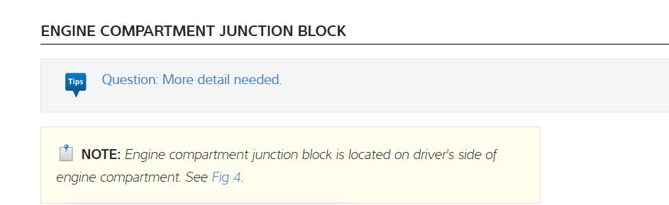

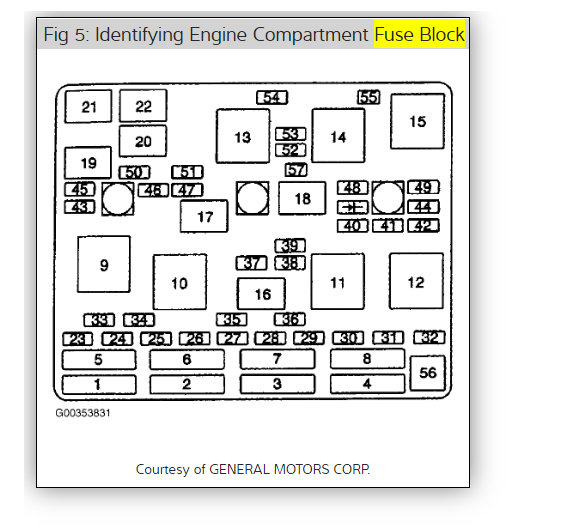

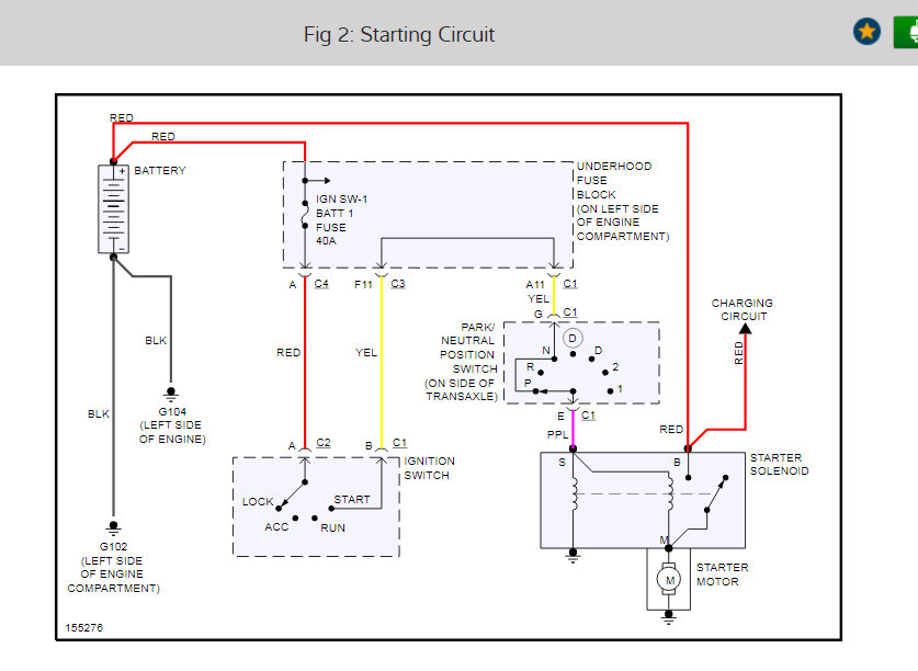

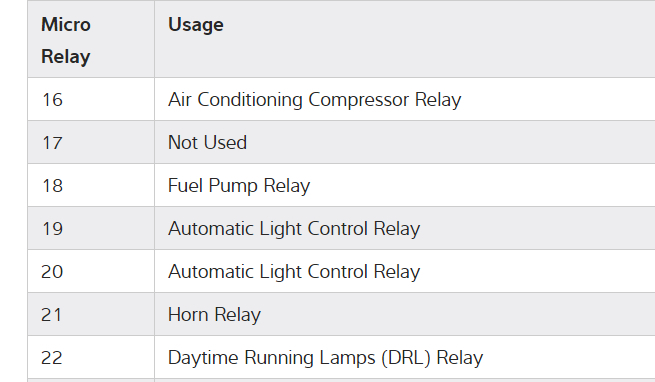

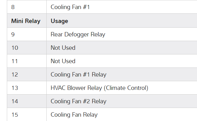

This could be a problem with your vehicle's IGN SW 1-BATT 1 fuse[40A] in your vehicle's under-hood junction box. In the diagrams down below I have included a wiring diagram of your vehicle's starting circuit as well as a diagram with callout for the Under hood Junction Box. Please check this fuse, link below on how to, if needed, and get back to us with what you find out. We can go from there.
