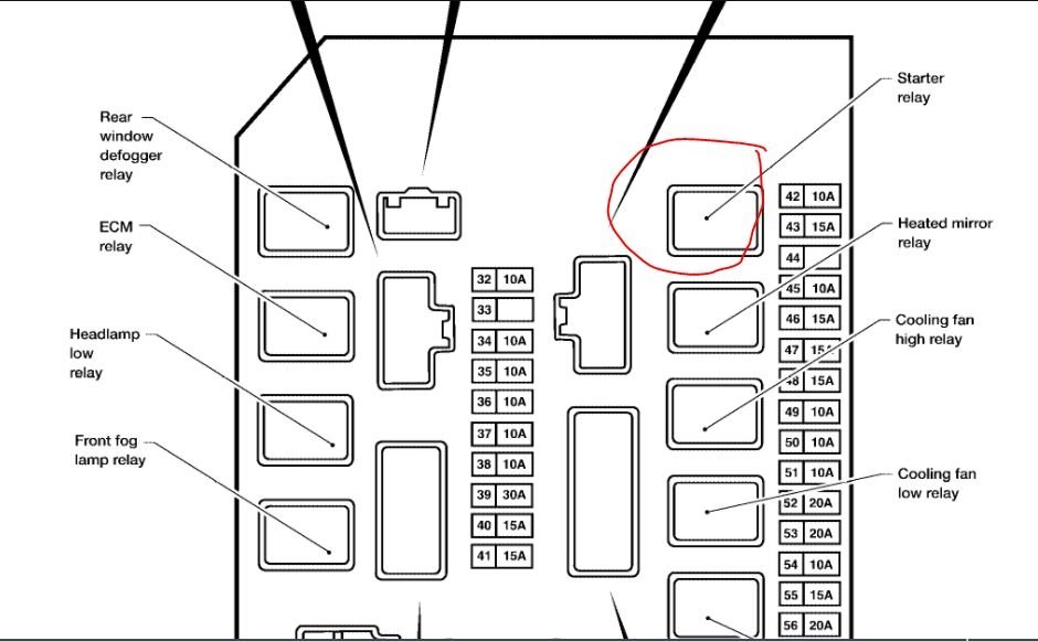

Engine will not crank
121,000 MILES • 6 CYL • AUTOMATIC
RAY2COOL
New starter, new battery. Radio, A/C and interior lights work. have checked all fuses and they are good.

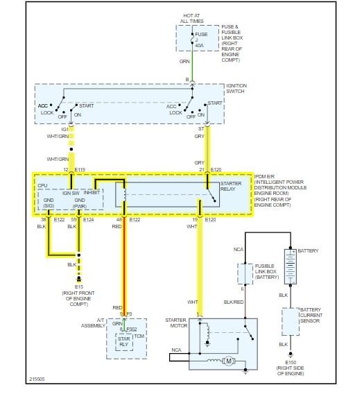

Good morning,
I attached the wiring diagram for the starting system.
You need to go to the starter relay and do some testing. You will need a voltmeter to check to see if the proper voltages are at the relay.
