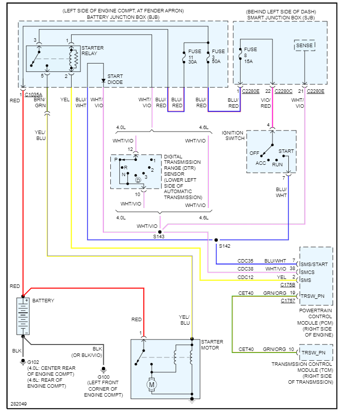

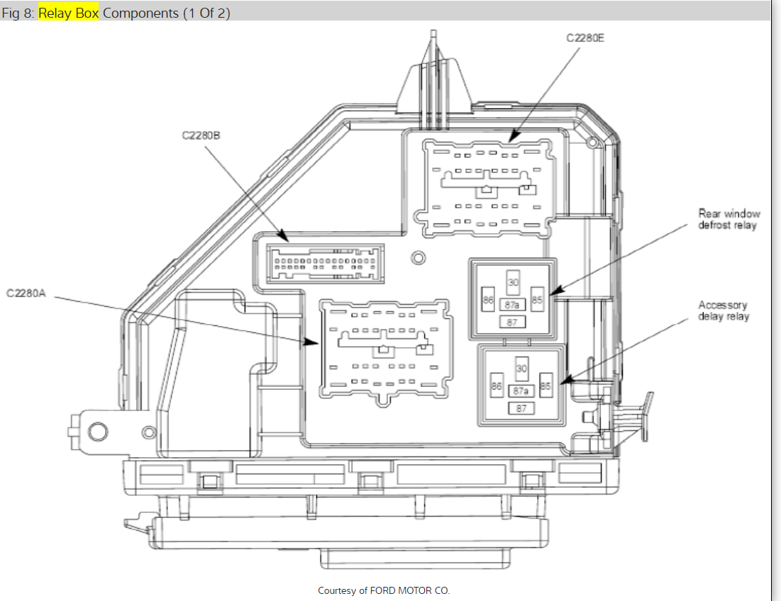

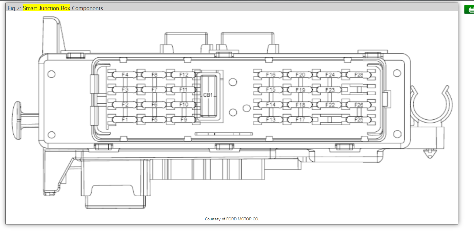

Will not crank all dash warning lights come on?
2009 FORD EXPLORER
190,000 MILES • V6 • 4WD • AUTOMATIC
BOBJET2001
The car has a new battery. All terminals are clean and tight. All fuses checked. Tried resetting the security system per Ford. Starter turns over when jumped.
Apr 5, 2023 at 6:19 AM
  • 55,433 POSTS

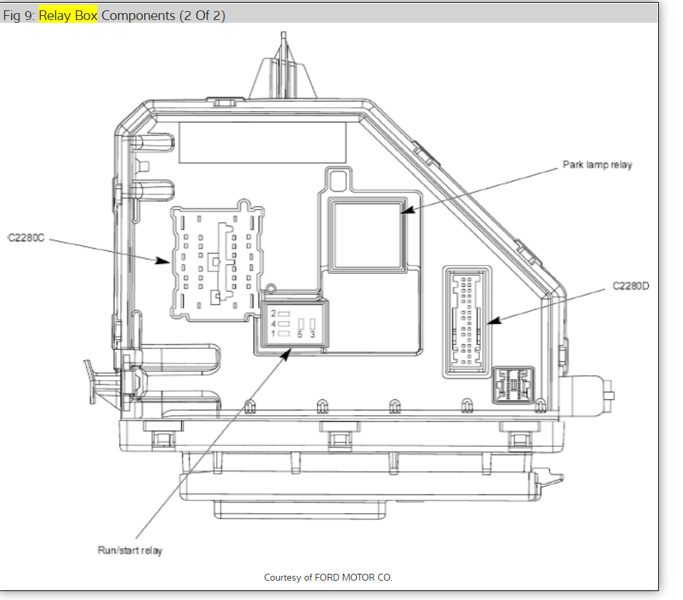

I would try to crank the engine over while the car is in neutral because you may have a gear range sensor that is out. Also, there are 3 fuses that run the system I would check. here is a guide to help with that and I have included the starter wiring diagrams so you can see how the system works and which fuses to check.

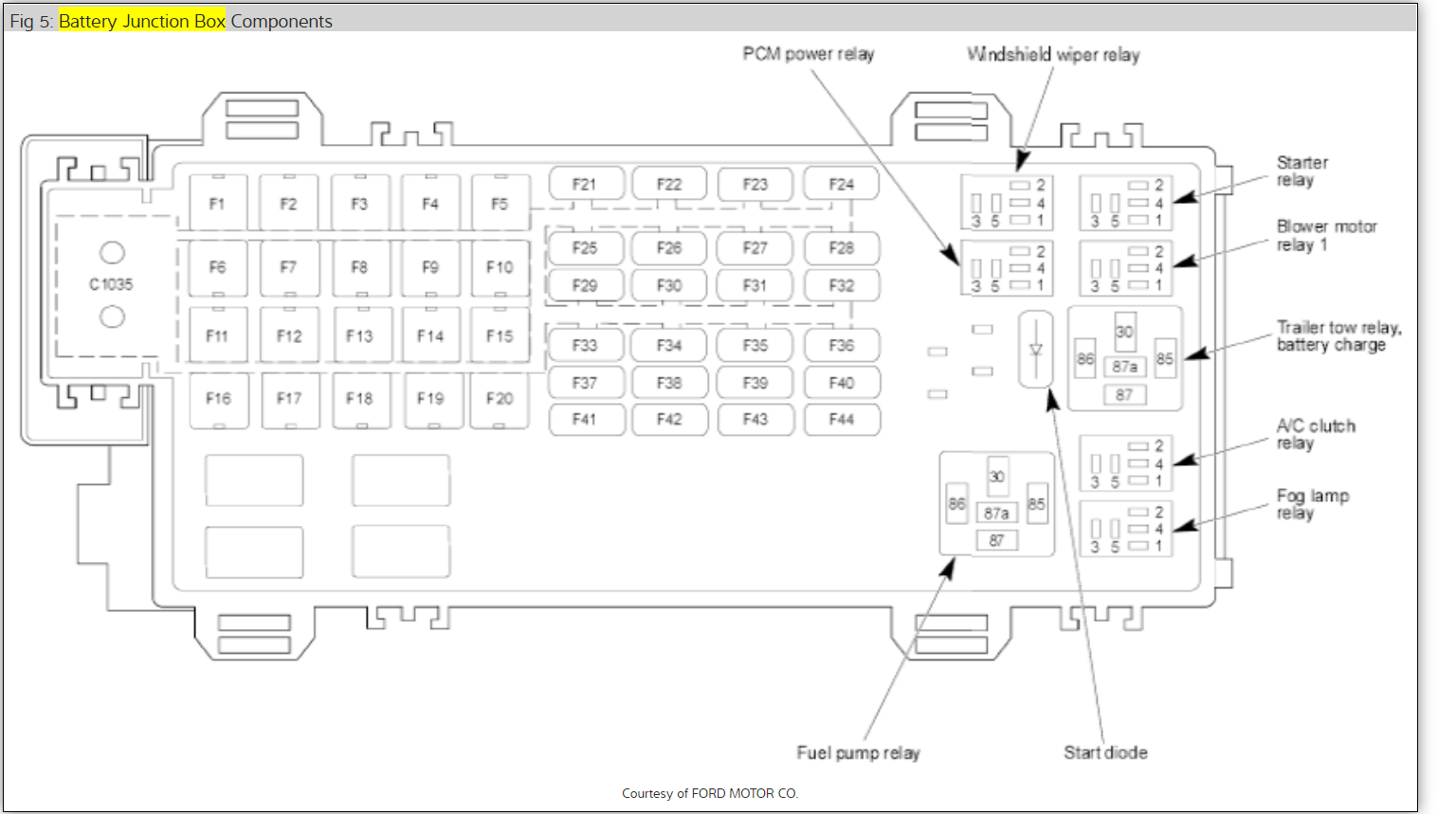

Here are the fuse locations as well.
This guide can help us fix it as well:
