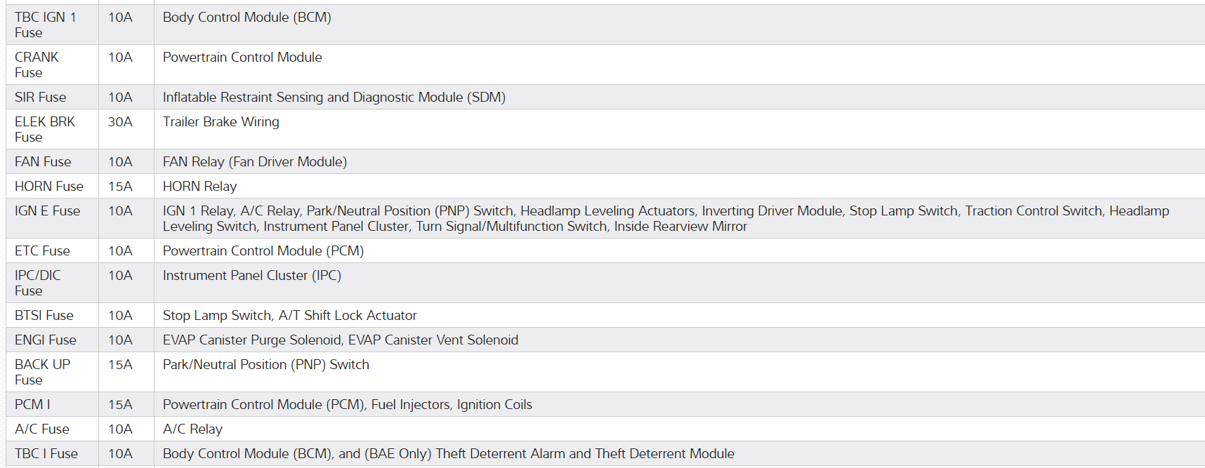

i was driving and it stalled out. when i tried to restart all gauges came on but fuel gauge read empty, but had three quarters of a tank of gas. Also, shift indicator had no line under p when i shifted the vehicle into neutral still no indication of shifter location and no crank on engine. tried to tow it home. disconnected negative to restore defaults. no joy. plugged in odb2 maxi scan to see if codes but got link error. pulled fuses and tested with circuit tester and it lit up on all but one. at the time there was no warning lights the odd back fire and was using more gas than usual. i did put in gas system cleaner the day before but acceleration was great.
Mar 27, 2018 at 1:35 AM
  • 55,748 POSTS

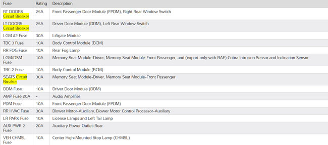

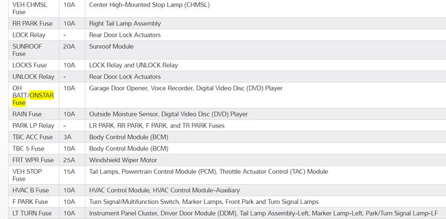

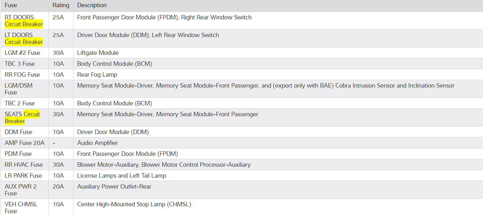

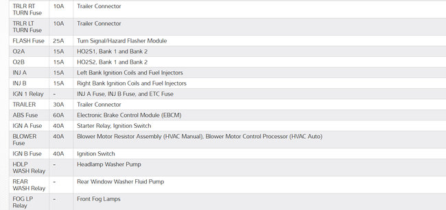

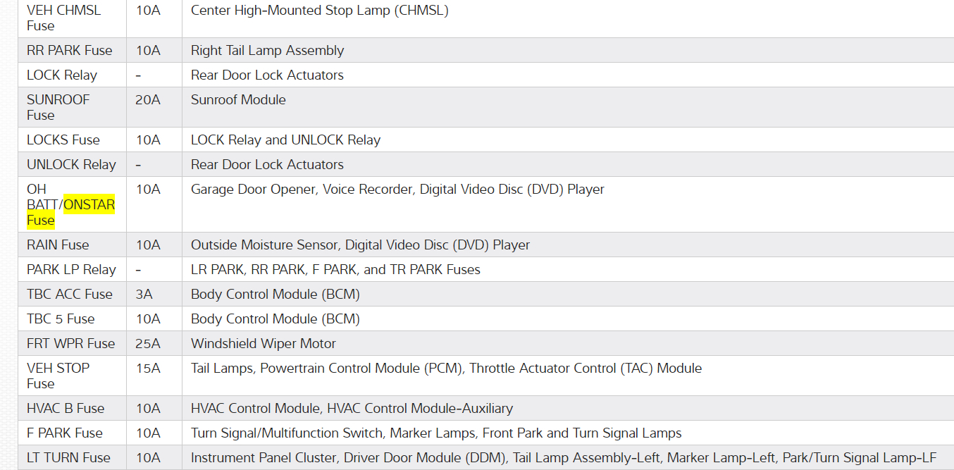

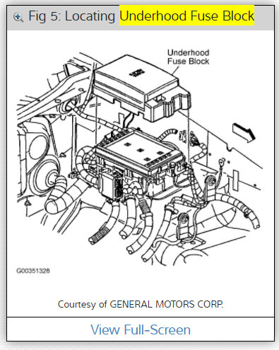

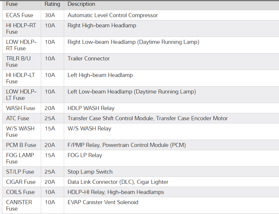

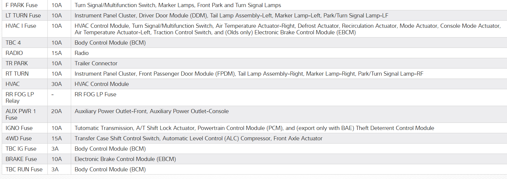

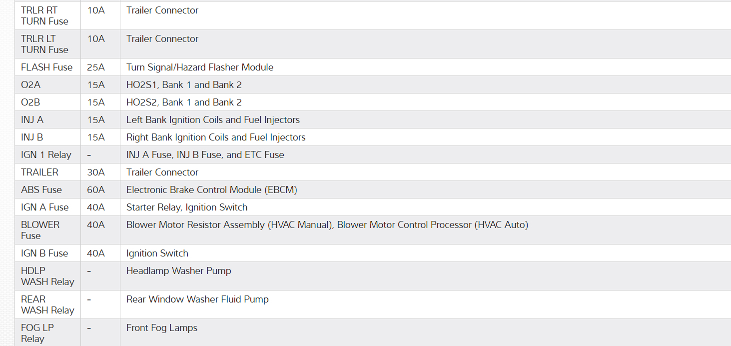

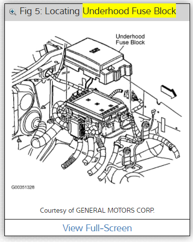

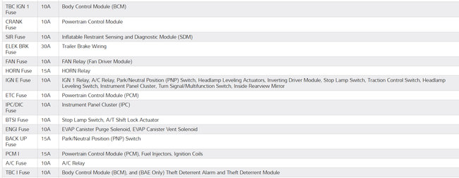

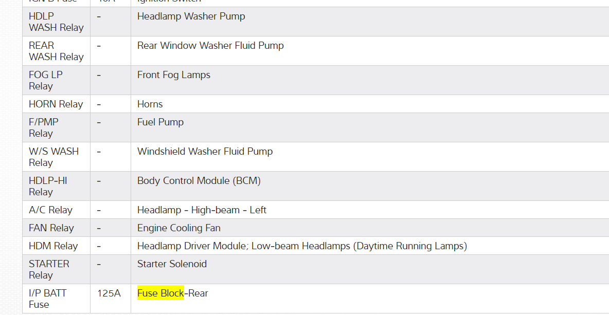

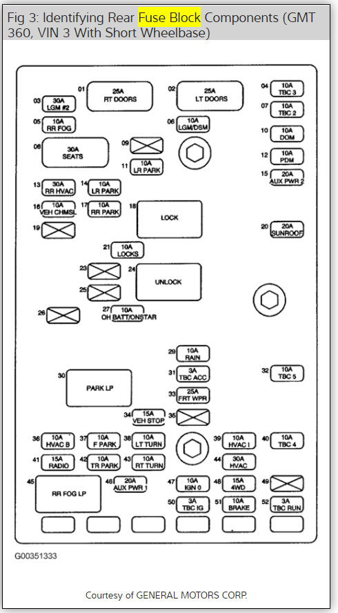

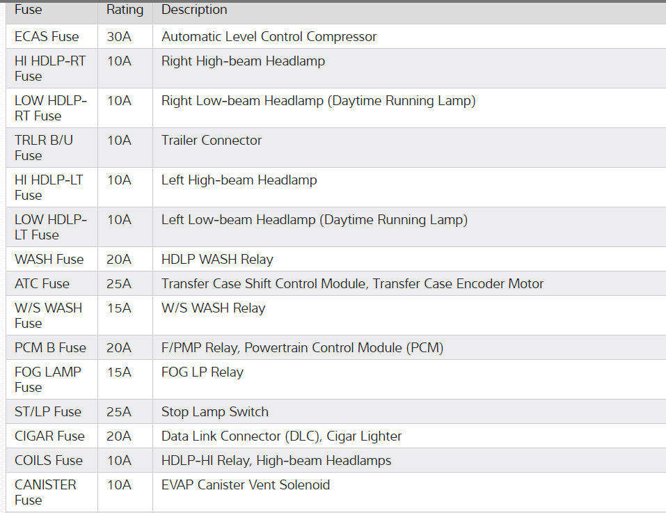

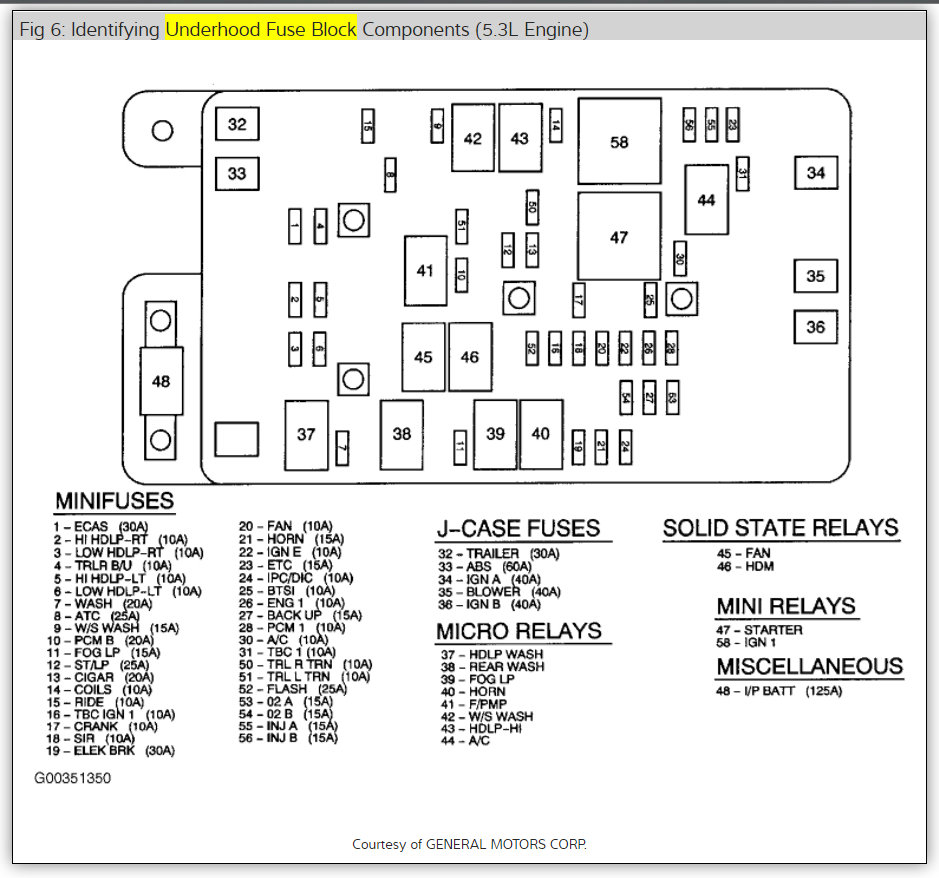

It sounds like you lost the PCM but to be sure lets check the system fuses.
Here are the fuse locations.

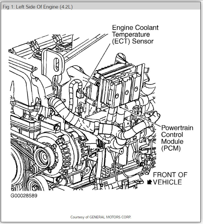

If everything checks out would would try a used PCM plug it in see what happens.

tx ken i think i did a dumb move i did process of elimination but did not check all the fuses and swapped out my 03 trail blazer with a newer envoy ( same model # on the pcm so now im trying to get the pass lock to turn off. connected my maxi scan reader to it and i get a link error

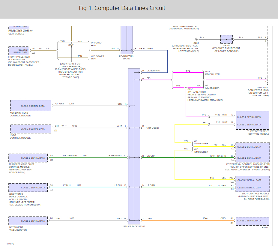

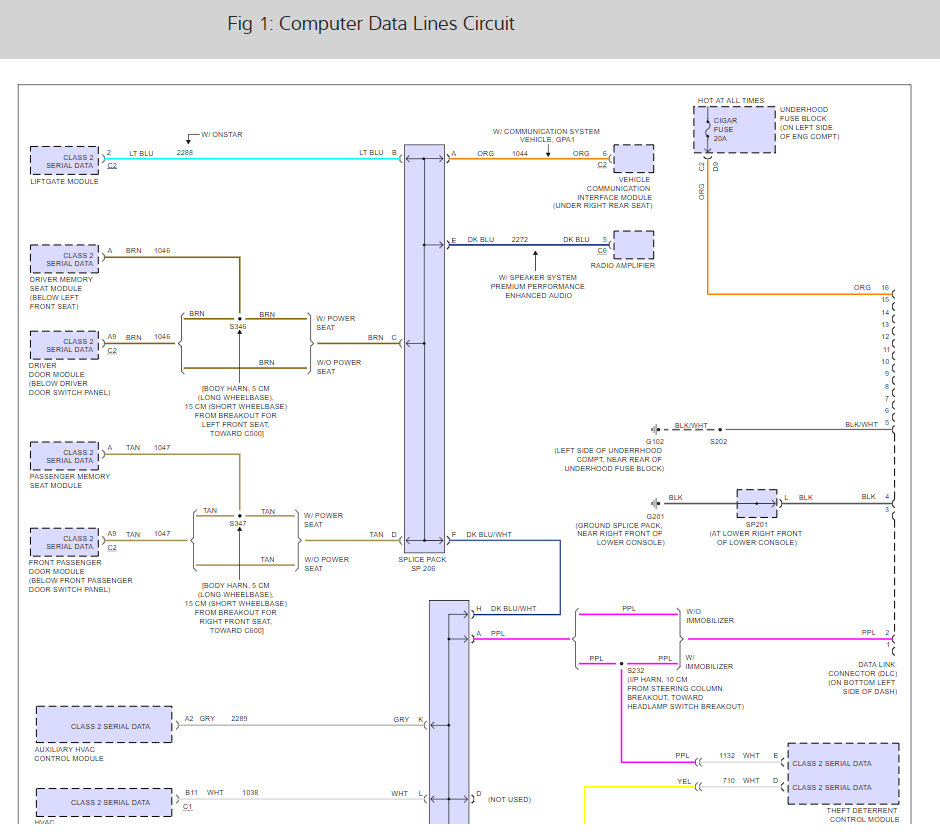

The link error seems strange. here is a wiring diagrams and power fuse for the connector please check the wiring power and ground connections:
ALDL connector wiring diagram is below.
Check out the diagrams (below)
