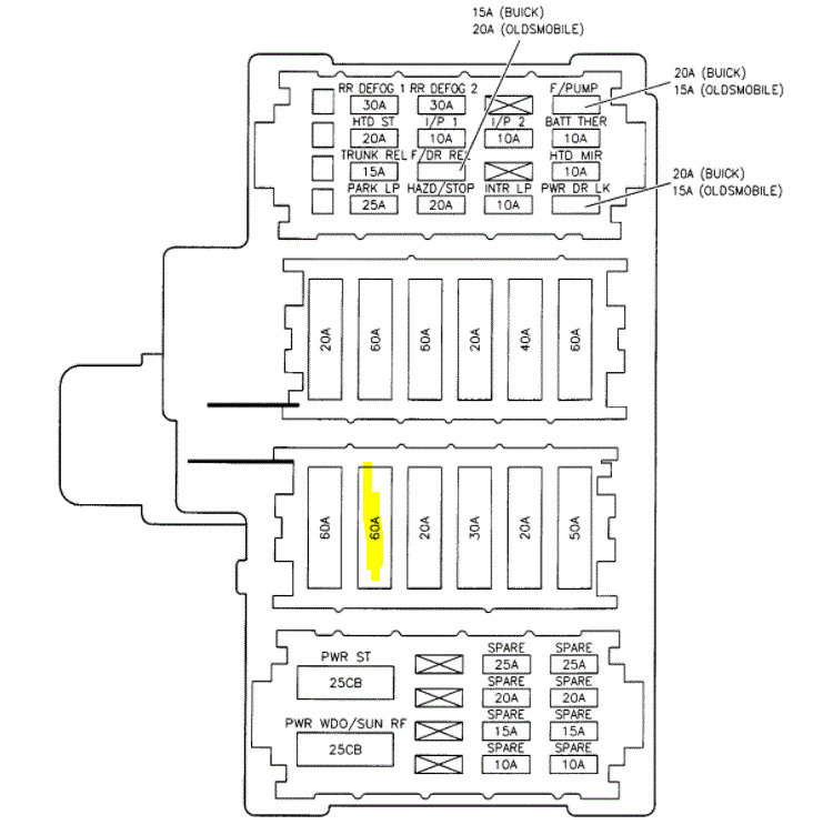

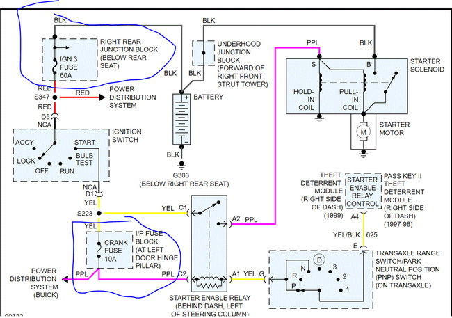

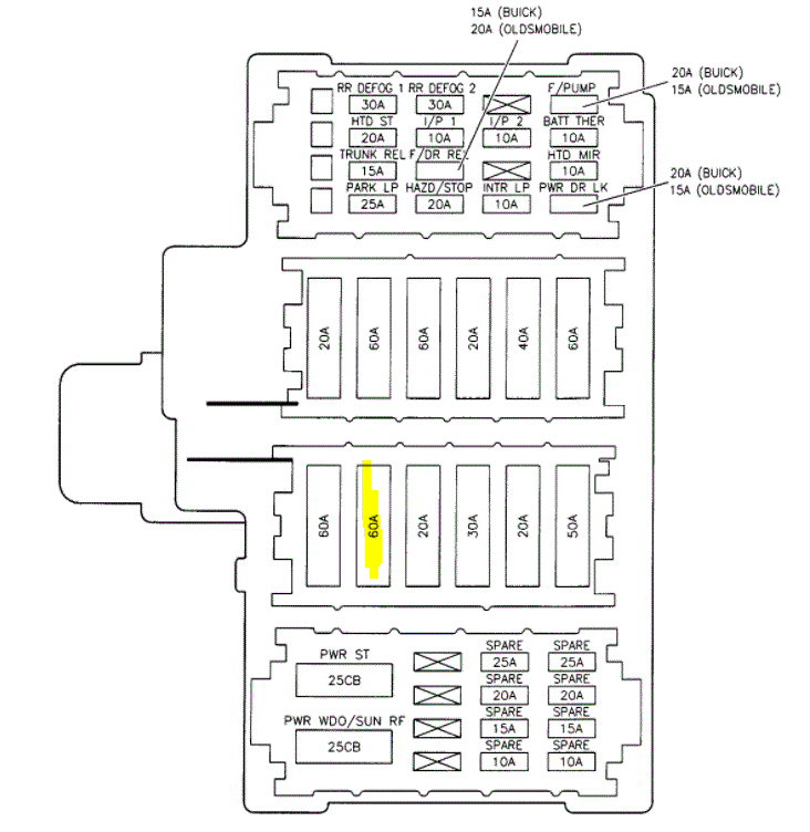

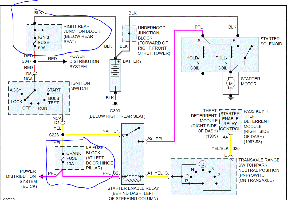

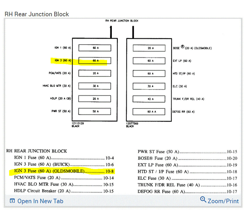

Try that first and let me know the results. If this is something you have already done, let me know. One last thing, check the ignition 3 fuse in the rear junction block under the rear seat and the starter and the crank fuse in the panel (driver's side) door pillar.
See attached pics. Pic 1 shows a portion of the wiring schematic. Pics 2 and 3 show fuse location. Pic 4 shows the instrument panel fuse box and fuse location.
In addition to checking fuse condition, confirm there is power to the fuse and out from it. Here is a link to help.

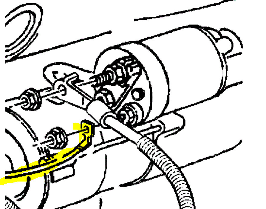

Were the fuses all good? If so, then we need to check for power at the starter itself. Before you do this, check to see if it will start in neutral. If it still does the same thing, then on the starter you will see two wires, a black one and a purple one. The black one is thicker and is hot at all times direct from the battery. The smaller wire, the purple one, is what actuated the starter (trigger wire). That wire should get 12v only when the key is in the start position.
I need you to check if the purple wire is getting power when the key is in the start position, so you will need a helper.
If you have power at the purple wire and the black wire does have power from the battery, chances are the starter is bad.
Let me know what you find.

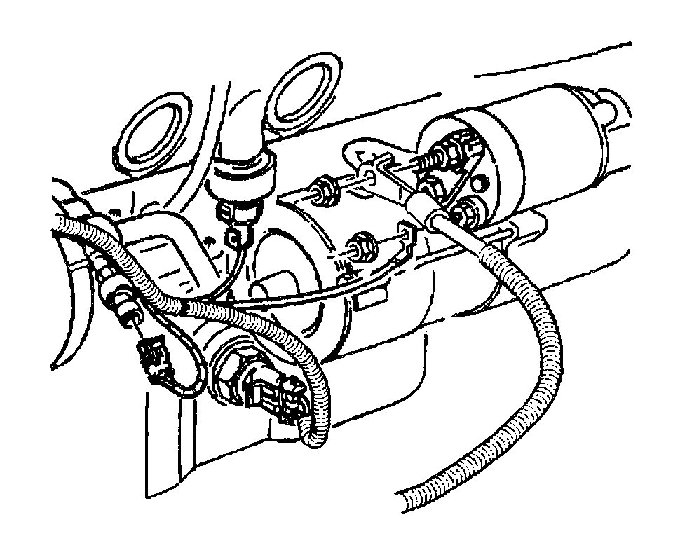

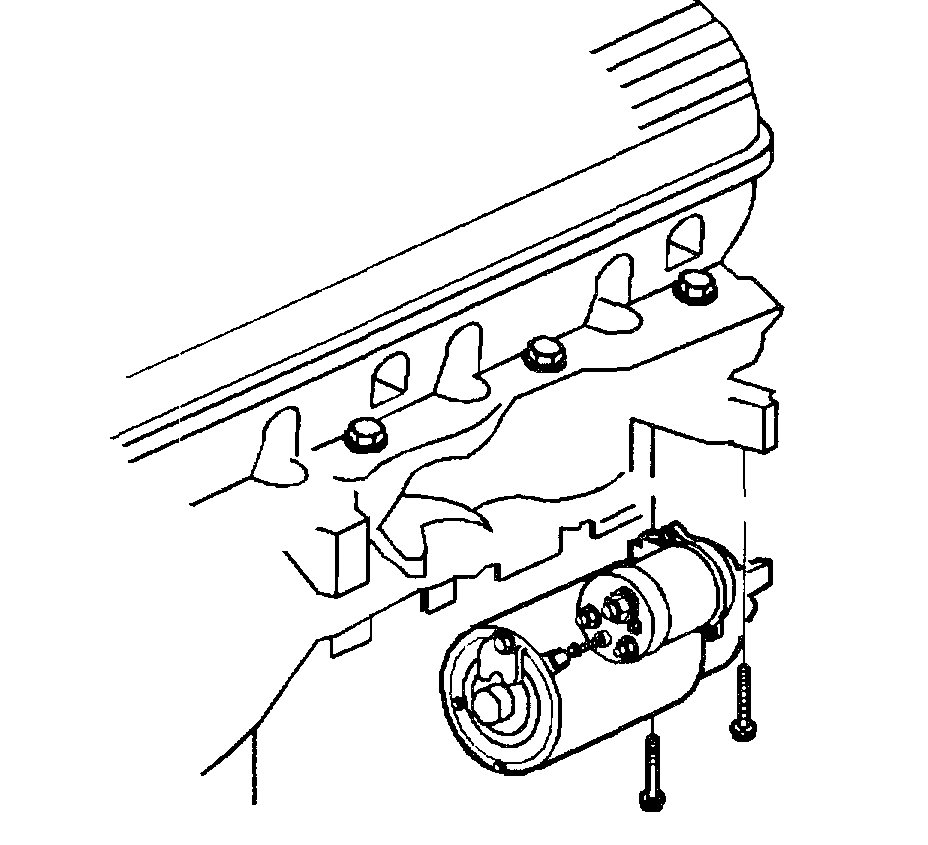

The purple wire will be on the starter itself. If it has power when the key is in the start position, the battery is charged, and the connections are all good, it sounds like you have a bad starter. If you look below at pic 1, I highlighted the purple wire on the starter.
At this point, disconnect the battery and remove the starter. Have it bench tested at a local parts store. Most do it free of charge.
Here are the directions for the replacement of the starter motor.

Pic 2
1. Disconnect the negative battery cable.
2. Raise the vehicle with a suitable safety stand.
3. Remove the splash shield.
4. Remove the flywheel inspection cover bolts.
5. Remove the cover.
6. Disconnect the starter motor wiring.

Pic 4
1. Install the starter motor.
2. Install the starter motor mounting bolts.
Tighten
Tighten the bolts to 43 N.M (32 lb ft).
NOTE: Refer to Fastener Notice in Cautions and Notices.
3. Install the flywheel inspection cover.
4. Install the cover bolts.
Tighten
Tighten the bolts to 7 N.M (22 lb in).
