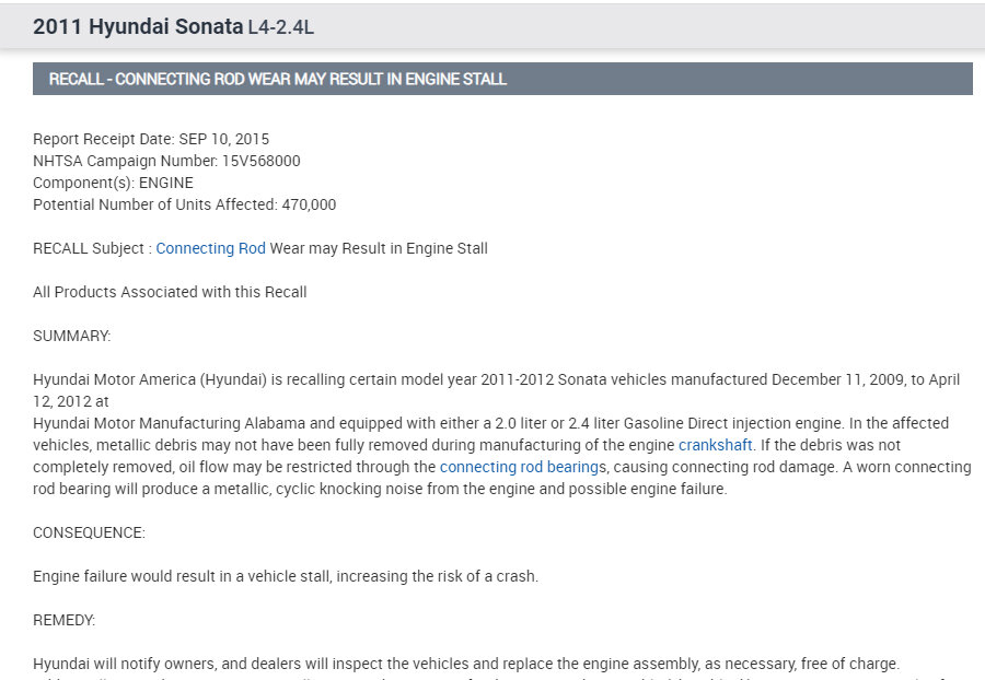

First, I need to know the engine size. There have been specific oil-related issues related to a few different engines in these.
Next, if you lost 4 quarts of oil, can you see where it leaked from?
I'm asking these questions because there is what I call a silent recall on the engines resulting from oil issues and bearing problems. Actually, the idea that you heard a loud noise has me a bit concerned because I've dealt with connecting rods that came through the engine block.

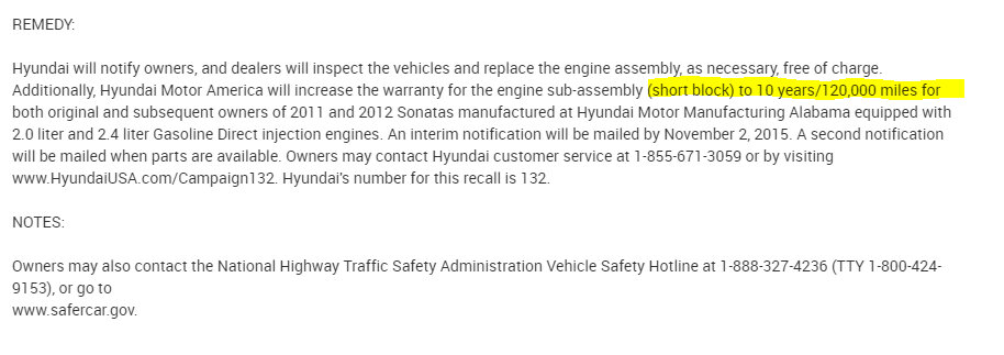

And yes, if this is a related engine issue, they have extended the powertrain warranty. I think it's 150,000, but I need to confirm.
See pics below. Also, I did note they extended the warranty, but it is to 120,000. It may be worth debating the issue with them if there have been issues and you didn't receive the notification.
