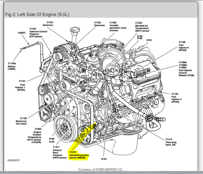

Drove truck from Texas to Wisconsin when made it to Wisconsin and try to start next day turn over but wont crank. it acts like it wants to start but wont. tried starter fluid still no start.

This could be problem with your vehicle's Camshaft Position Sensor (CMP). Your vehicle's Power-train Control Module (PCM) uses the signal from the CMP to determine when to fire the fuel injectors and the spark plugs. Your vehicle will not start without this signal. I have included a diagram of where your vehicle's CMP is located. Please get back to us with what you are able to find out.
